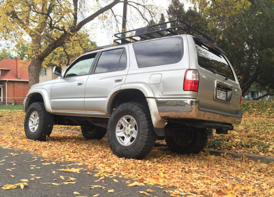

Will I be able to fit 285/85/16 MT on my 01 4Runner with a 3 inch lift. I will primarily be driving around town and just going mudding. In the other threads when people say they are scrubbing is that just when they are off-road or making hard turns in town? Thanks for the help

Yes.
And yes you will rub at full turns.
Wheel spacers may help.
Don't forget your:
panhard drop or bar
extended brake lines
extended parking brake bracket
extended sway bar end links
diff drop
Expect:
20% + gas mileage loss
Power / Acceleration loss
If you get a flat tire, your stock spare won't work
