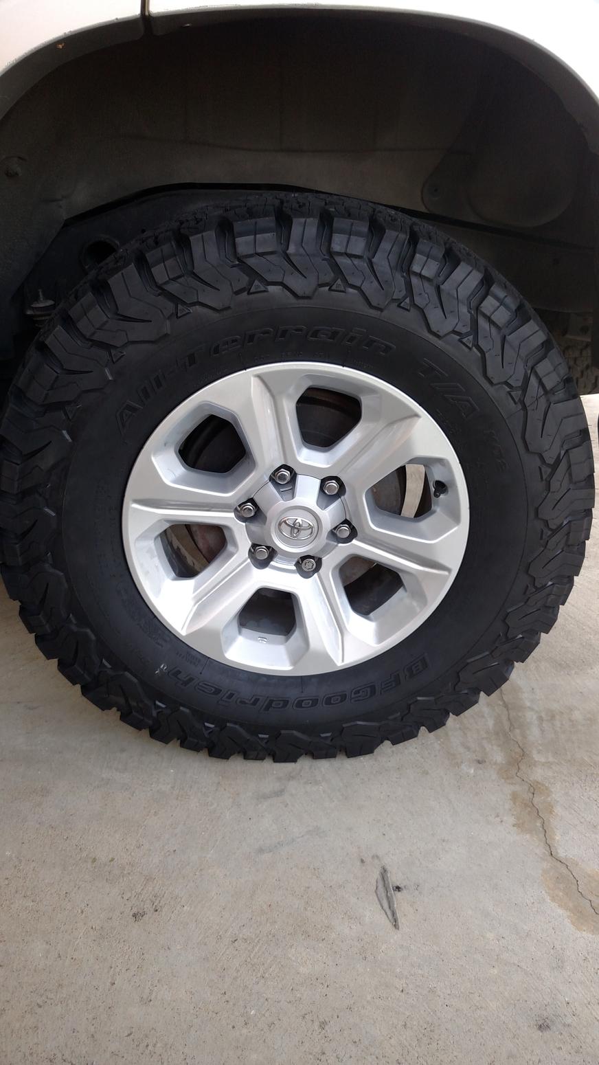

Have put about 100 miles on mine. Now that I finally have my vibration issue figured out I love them. No road noise. Just got new suspension also but smooth ride. The look awesome.
Running mine at 44 psi for now.

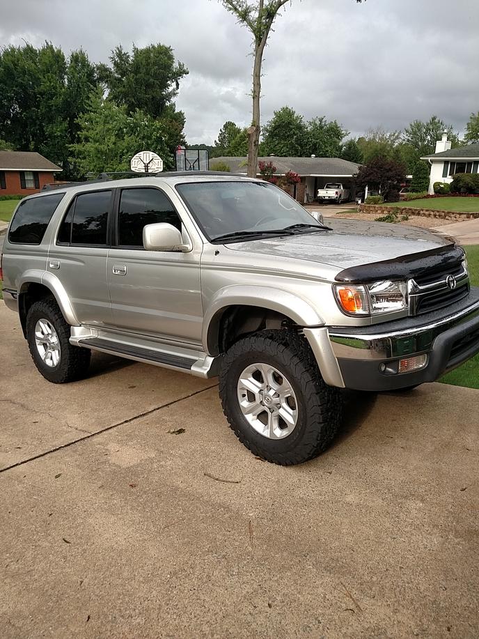

I am running BFG KO2s in 265/75/16s on a 2002 SR5 with skinny chrome fender flares. No rubbing at all. I do a fair amount of highway travel and they are nice and quiet. I too am about to do some sort of suspension refresh soon. But for now, everything is sexy time.

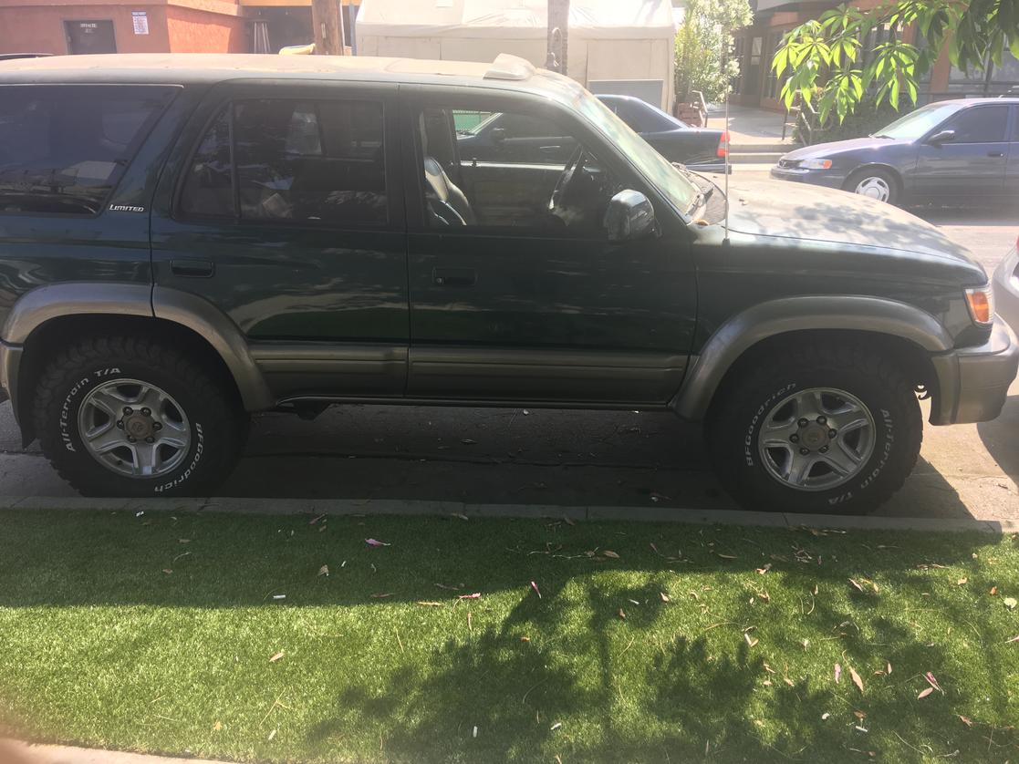

I’m running BFG ko2 load E and haven’t really heard any road noise they’re pretty quite for an A/T tire. Also I’m running 265/75’s as well no issues I ran it with stock suspension for a few months no rubbing or issues. And my suspension was non existent saggy as hell. Can definitely feel the weight of the tires though.:thumb:
