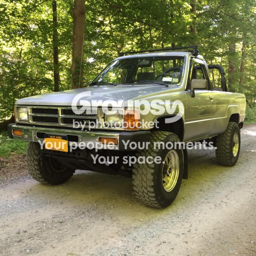

This is 31x10.5 tires on a 4runner with no lift in the front, and a 2" add-a-leaf kit in the rear. Front valance has been removed, which can also give the illusion of a "lift". 31x10.5 x 15 is significantly larger than the stock 225/75 R15s that come factory. This is an IFS though so I believe the wheels and tires sit a bit farther outward from the fender than an 85.
