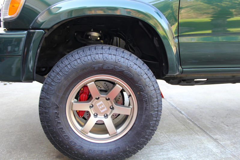

Level 8 MK 6 -10 offset With Tundra Brake Upgrade
I wouldn't mind going to 17". I've been looking at the Mk level 6 rims. They have good price. The 16" are little cheaper compared to 17". I have 3" of suspension lift.
Level 8 MK6 with -10 offset. 285/70R/17 Toyo At II's. Check out the links [MENTION=65101]BrianSD_42[/MENTION] posted. 285/70R/17 are the same height as a 285/75/16. Both are 32.8" If you get the Level 8's (I assume you mean Level 8 MK6) you don't need wheel spacers - I don't want to put any any undue stress on my front suspension and I don't want my tires hanging outside my fender flares. (It's all a matter of preference and what you do with your rig) Be sure to go with a -10º offset and no problems with the Tundra Brake upgrade. The only time you'll ever notice the difference between the 17" and 16" wheel is mostly on the highway during those windy days. A 17' will give you a bit more stability. I'm on the highway about three days a week.
Forgot to add the price - $1534 for wheels tires and Gorilla ET's at discount tire. Mounted and balanced. Lifetime balancing, rotation etc.
I have the 16" Level 8 wheels, in a -6mm offset. I have the same Falken Rocky Mountains you do. They clear the Tundra brakes, and do not rub on 3" of lift.
