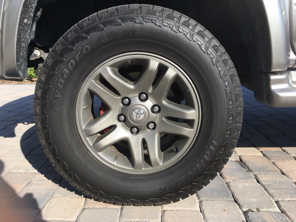

I second the Hankook ATM. I have them on my 2000 4runner and my 15 Jeep Grand Cherokee. Both are quiet and seem to not show any signs of wear. I have 25000 on my 4Runner and they look like they are new. The Jeep is wearing the same. Great on and off road.
I've been happy with my Hankook ATM on the Land Cruiser. They are by far one of the least expensive AT tires out there. I was going to put a set on the 4Runner, but my Pop's was using the truck for a while and ended up putting some Michelin all season's on there.
THIS. BFGs are an off-road staple, but as previously mentioned there are some great tires for less. I have 31 x 10.5 Hankook DynaPros on my T4R and love them. Now I just gotta find a place to go (only have had the truck for a day...).

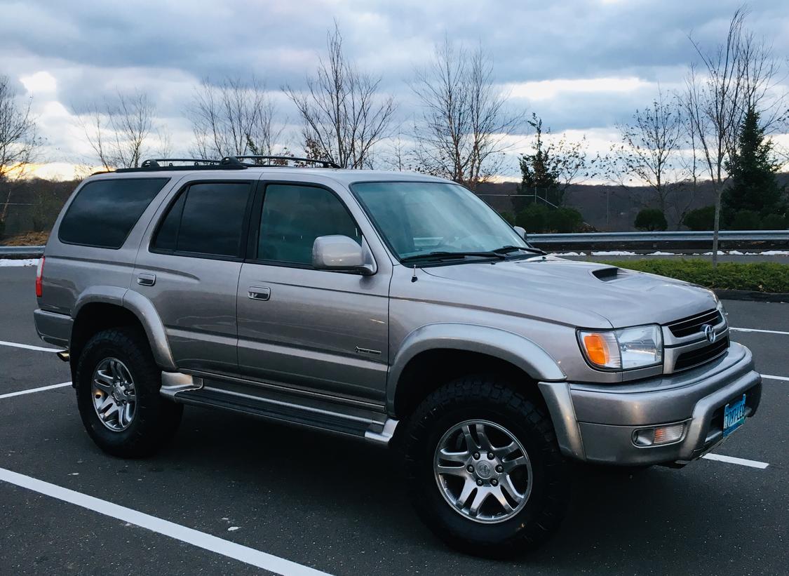

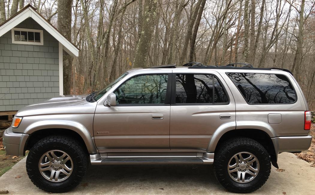

Well, the 285/70R17 Nitto Ridge Grapplers on 17” Sequoia rims are installed and suffice to say but I’m a happy camper. I ended up getting a fifth Sequoia rim and another one of these tires for the spare which I was able to get under the truck by moving the factory hitch back one hole (approximately 1.5”). It sticks out more than stock now but still looks good - I love that I got the tire under there. About 1/2” - 1” clearance to the panhard bar.
Driving on 33s definitely feels very different than 32s - it could be that I had more of a true AT tire before (Toyo Open Country AT II) and it could be that these weigh a LOT more. Makes the T4R feel much more like the lifted Jeep Wranglers that are a dollar a dozen around here. I love being a little different with my old Toyota.

Man, oh, man, that is one great looking T4R.
Those rims were an excellent choice with your color.

She’s a beaut Clark!!! And good call on that tire size I think this the PERFECT setup with thundercloud. I bought 265/70/17 and then got the lift.. oopsie.

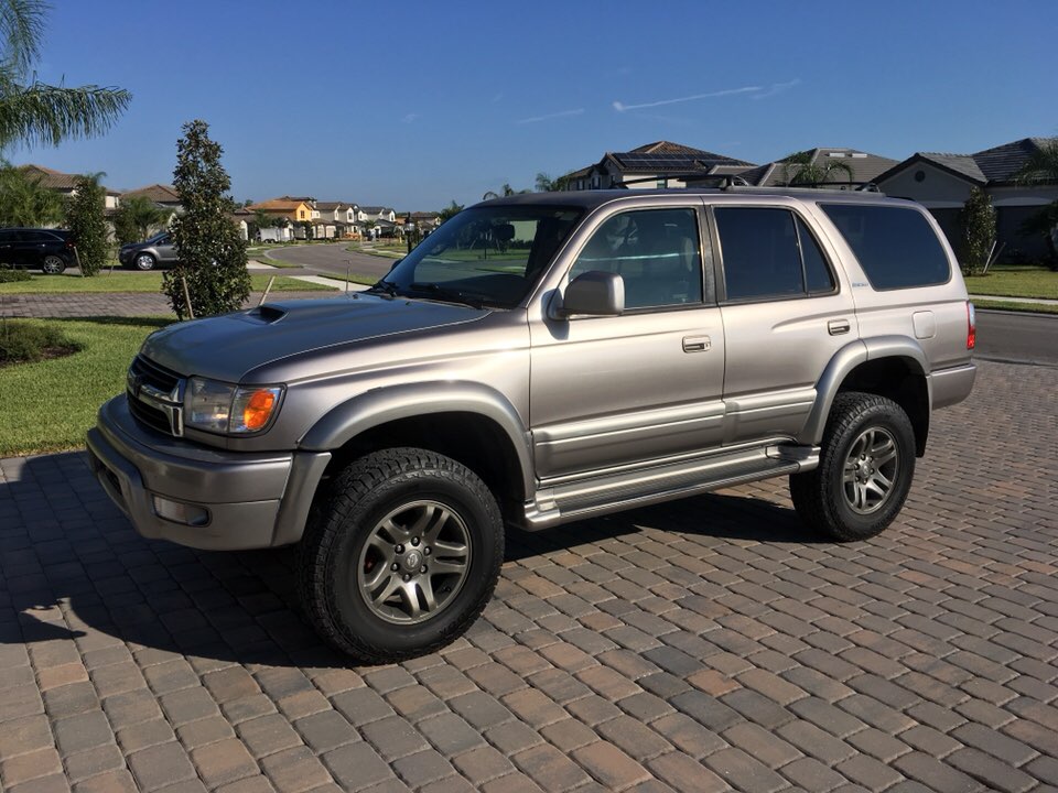

If I could have found sequoia wheels I’d have been quite happy, but I couldn’t so I made them as close as I could get them to the graphite color. IMG_0703.jpgIMG_0689.jpg
