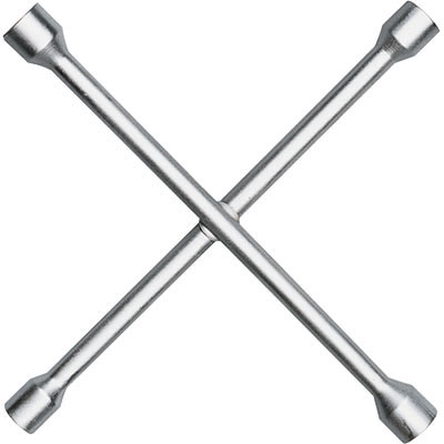

Correct me if I'm wrong but doesn't Toyotacare include 24 hour roadside assistance including towing to the nearest Toyota dealer? That BS that the dealer wouldn't warranty this problem.
As for torquing your lugs with an impact gun Torque Sticks are the way to go.
