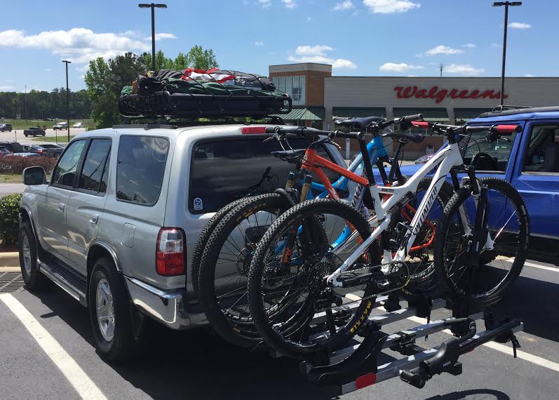

HI!
I bought a 4wd 2001 4Runner and is bone stock except the roof rack I just added. The tires need replacing and are currently the stock 265 70 16. I am weighing my options. Can I install a slightly larger tire without issues with the stock wheels and no lift? If so, what size is recommended without scrubbing?
Alternatively, what kit should I buy for a small lift (not body lift)? Are there any that are easier to install? I am not a wrench by any means and would definitely go this route if the install labor didn't cost so much.
Thanks all! This is my first post!

Decide if you're going to lift it before you get the tires.
With a lift you can fit 285/75/16 tires with stock wheels. Very minimal rubbing but it's mendable.
Toytec Lifts: Toyota Lift Kits: FJ Cruiser Lift Kits, Tacoma Lift Kits, Tundra Lift Kits, 4 Runner Lift Kits, Sequoia Lift Kits, Toyota Truck Lift Kits for all your lift needs
What's your budget?
Are you going to wheel it?
Are you doing it just for looks?
