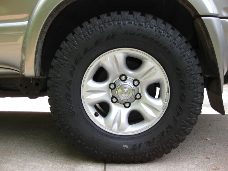

265/75's usually fit anything with little to no problems. The gap between the top of the tire and wheel arch is not the area you should be concerned with. It's the gap between the tire and the front mud flaps when the steering is turned that causes issues but can be easily trimmed if needed. At full left or right lock, inspect the tire-mudflap gap and you'll be able to estimate if the increase in tire diameter is going to make contact. Don't forget that the gap closes up a little under suspension compression.

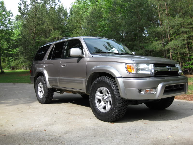

yea clemson they were only 165 so I though that was a good deal. if i post some pictures tomorrow with close ups you guys think you can give me some better help?
ok here are some pictures today and i took some measurements, not sure if they will help though? the front from ground to the middle of the fender flare is about 33 inches. the rear comes in about an inch higher at 34.
Front:
Back:
Overall:
this is how i measured, hope it was right (rear tire)
bump for help? and did some googeling and fount the tires on a '02 2WD 4runner. The tires are Goodyear Wrangler Authority.
