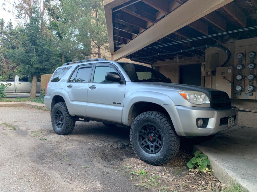

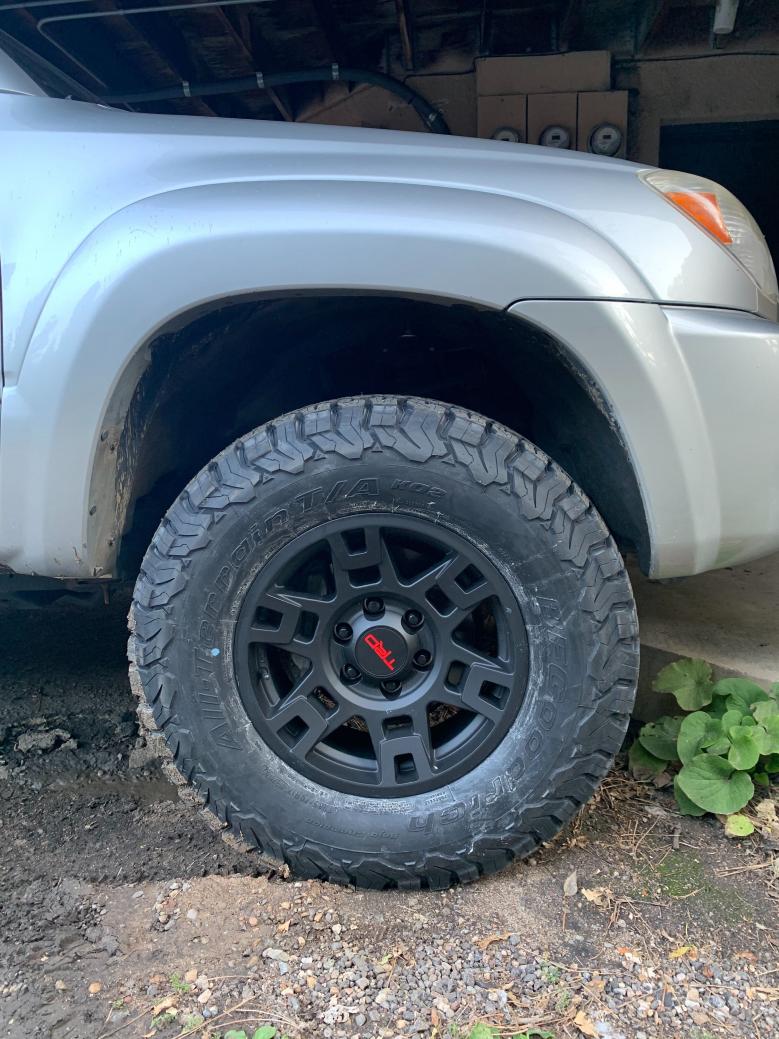

i wouldn't necessarily listen to everyone here saying "you'll DEFINITELY need to do a body mount chop!". i have basically the same set-up as you - OME 884 in front, 895 in the back, SPC UCA's - only difference is i have OME shocks as opposed to 5100's. i run 285/70/17 with no issues at all. zero rubbing. all i had to do was push the fender liner forward (which i did before i even got the tires installed). i did trim a tiny section (less than half an inch wide) of the front bumper just to make sure there was no rub at full front droop. no BMC required at all since the SPC's allow a ton of forward adjustment to get away from the mount.
that said - as mentioned before, it's the -10mm off-set wheels that may cause some issues. i have TRD Pro wheels which are +4mm i think...def a big difference than what you're going with. i'm willing to bet that there's more than a few people this forum running a similar suspension setup with -10mm wheels/285's so let's hope someone else can comment from experience. in the end, it's gonna be hard to know until you do it. good luck!
**EDIT** just realized in your first sentence you mentioned you have 0 offsets you can use. lol! my bad. i think you'll be good with 285's on those wheels with your current suspension set-up.
