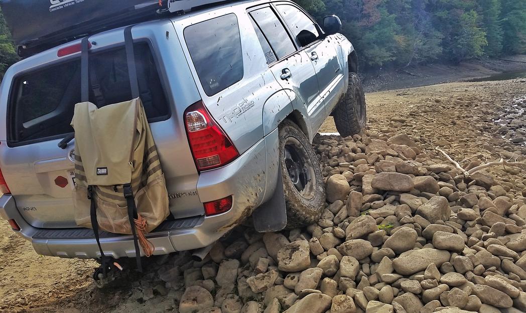

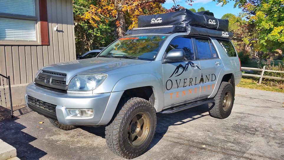

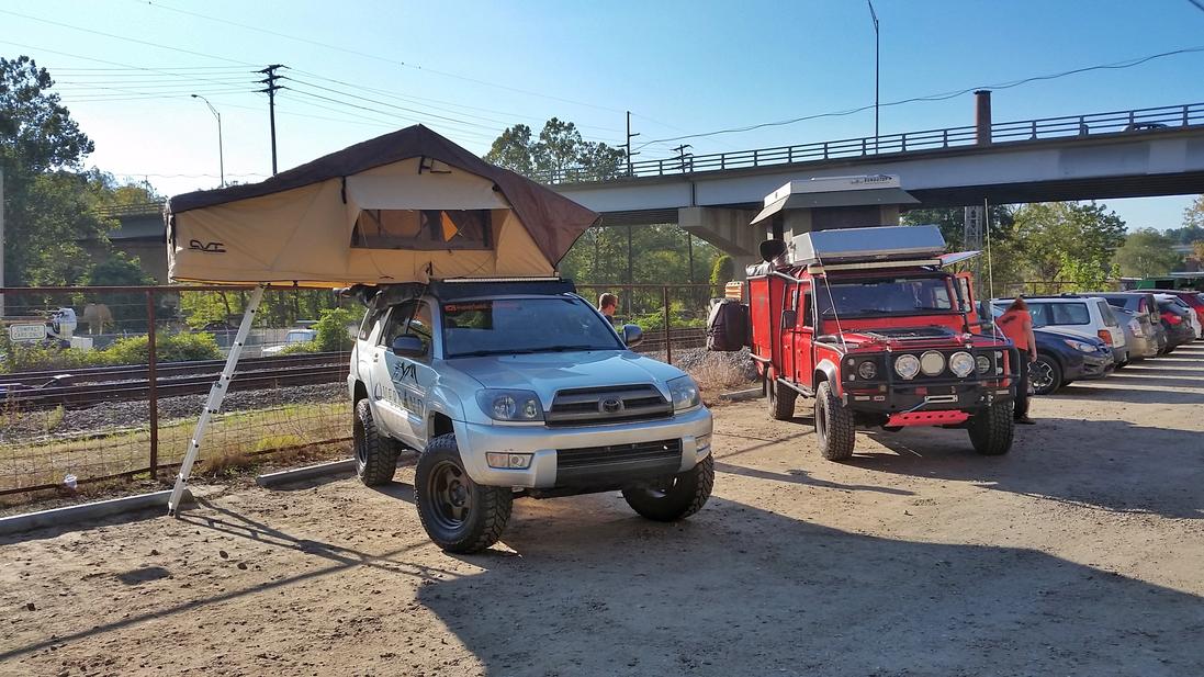

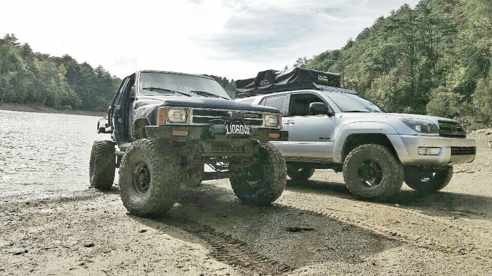

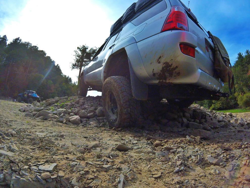

As @S_p_a_r_k_y stated I am running 255/80/17s on SCS F5 wheels and absolutely LOVE them. I am also on the stage 2 icon lift. For any overlander I would recommend this tire. If you look at camel trophy trucks you'll notice their tire width... They did fine. The fuel mileage isn't hit as hard, it's easier on steering components, and has never failed me on or off road. It looks good too in my opinion.. These are Cooper discoverer STMaxx tires wheels are SCS F5s, 17x8.5 -10mm offset.

Thanks for the response, disregard my PM, didn't see the tire listed. Just curious what did you have to trim to get these to fit? And how do you compare the STMaxx to the AT3? Thanks!
I didn't trim anything. Removed my front mud flaps... From the reviews I read about the tire before purchasing, I was highly impressed. I know nothing about the AT3 so I can't comment. I will never purchase another tire for my 4runner tho. I am that happy with it
