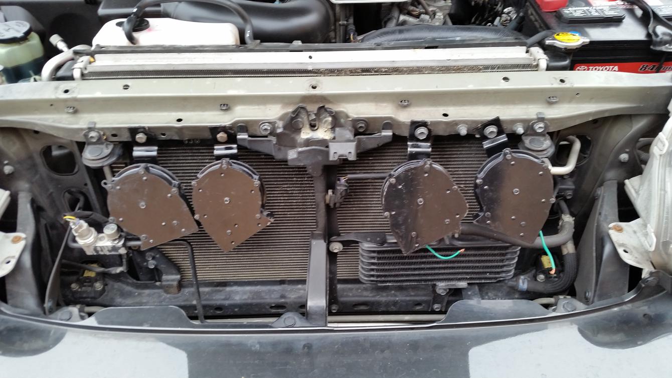

Delco Remy 4 note horn install - 4th gen
Had these sitting idle for a couple months after ordering off ebay. Finally got around to installing them yesterday and very happy with the result.

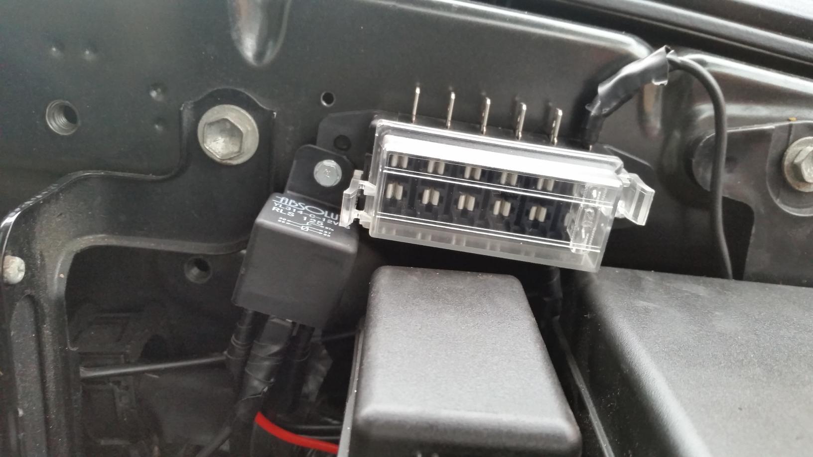

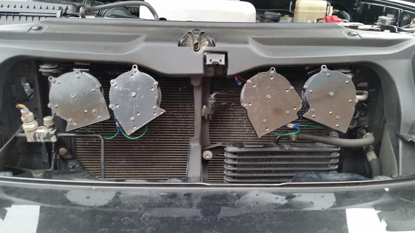

Fairly simple install. Used a Bosch relay and 30 amp in line fuse to deal with the increased load of the new horns. Plenty of room between the grille and radiator for all 4 notes (A C D F) - 2 in stock location and 2 mounted in similar location on passenger side of hood release. All wiring run underneath plastic radiator shroud gives a nice clean install. The sound is A+! Definitely good for a laugh the first few times you lay it on! Oh, and the increased safety factor is cool as well.
Pics: 1) shroud off to show horn mounting points. 2) Relay and fuse box mounted on driver side firewall (yes you can still access factory fuse box-just looks tight in pic). 3) Install compete and shroud replaced.
