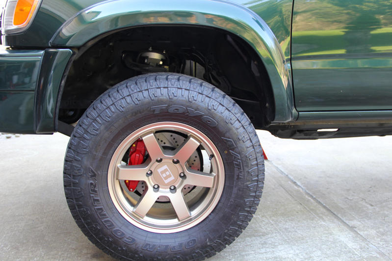

Looking at the Level 8 MK6 wheels I bought in the 16x8 with the -10 offset in regards to the Tundra brake upgrade... Will these fit?
Got em in 17" - Fit perfectly
I've got em in 17" and they fit great. No spacers and no trimming. Here's a link to a full photo of myT4R with Bronze Level 8 MK6 -10offset. Go with Gorilla ET lugs.
