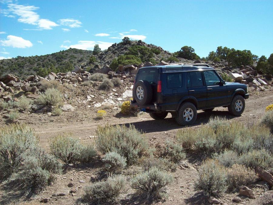

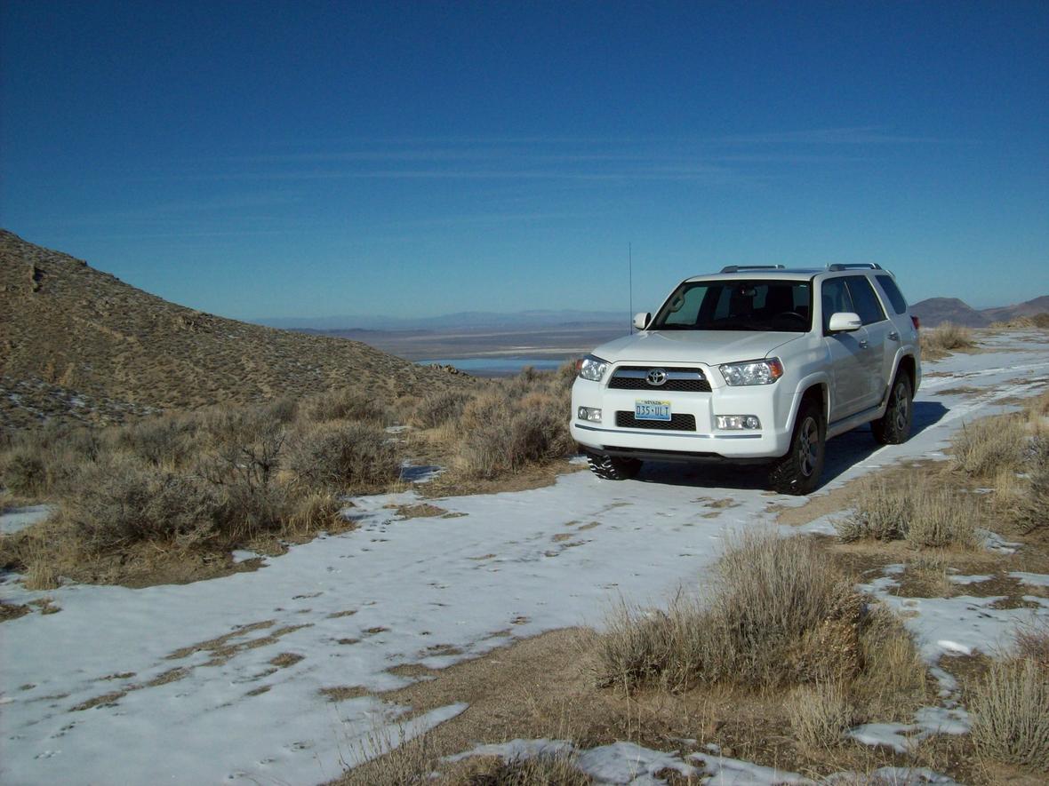

Nobody ever seems to suggest this:
1. Don't lift it.
2. Stick with stock sized tires (265/70/17)
3. Change to Toyo Open Country LT-265/65/17 (E) M/Ts.
You will be able to handle 99% of all the off-road situations the world will throw at you.
Your gas mileage will not suffer at all.
You will experience some increase in noise - so what.
The ones on my truck are about half worn after 48,000 miles (about 30% off-road/70% pavement)
Have run 3 sets of these now - 2 sets on a 2004 Land Rover discovery and the present set on my 2013 totally stock SR5.

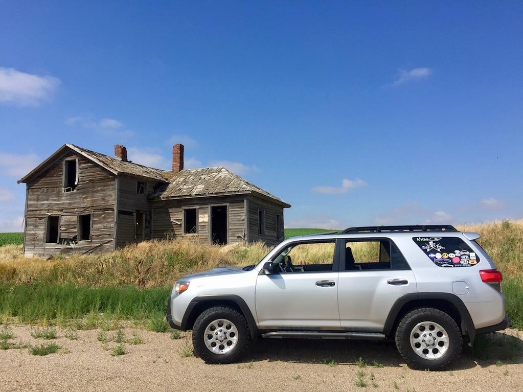

BFG KO2 in stock size. Better looking than stock tires... or most tires for that matter, very quiet for an AT, and no penalty to gas mileage (at least in my case) consistently averaging between 19.5 and 20.0. This is my second set of KO2s and and probably my 10th set of KOs on various vehicles. My 4R isn't lifted and they fill out the wheel wells nicely. I just completed a 7000 mile road trip to WA, WY, ID, MT, etc. and back. Smooth at speeds above 90mph, quiet, and great in the sand, gravel, etc.

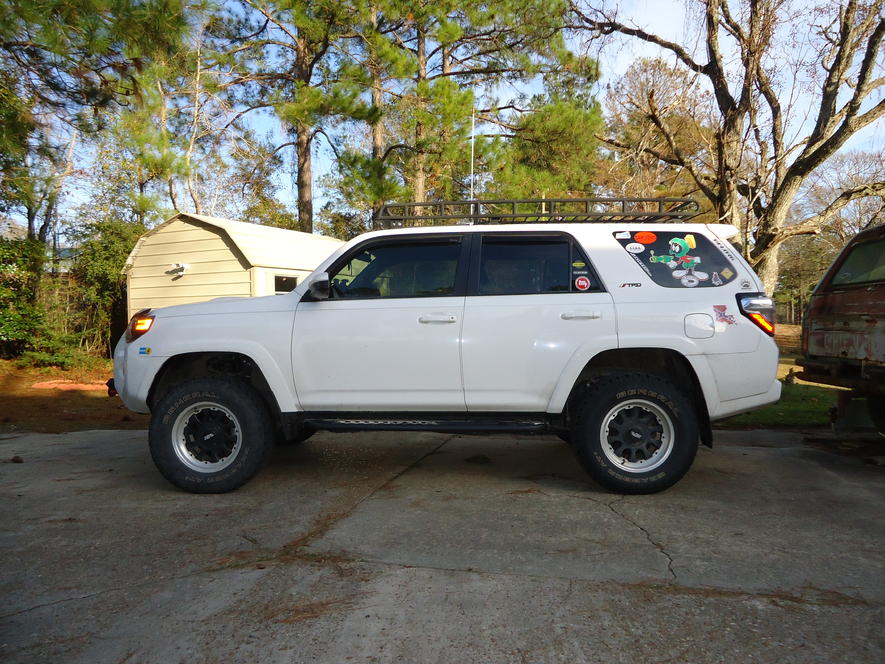

This is 2" front and 1.25" rear on 265's. I'm on my second set of General Grabber AT2's. About the same tread pattern as the KO2 for ~60% the price, 60,000 mile tread life. Quiet except on concrete surfaces (everything is louder on concrete). But primarily I'm posting just to show you 265's do NOT look odd on a 2" or so lift. The fenders aren't really that large to begin with. And if MPG and mostly highway driving are a priority the 265 will keep you in the better mpg range. And for comfort you want to avoid load range E. Just my 2 cents.
