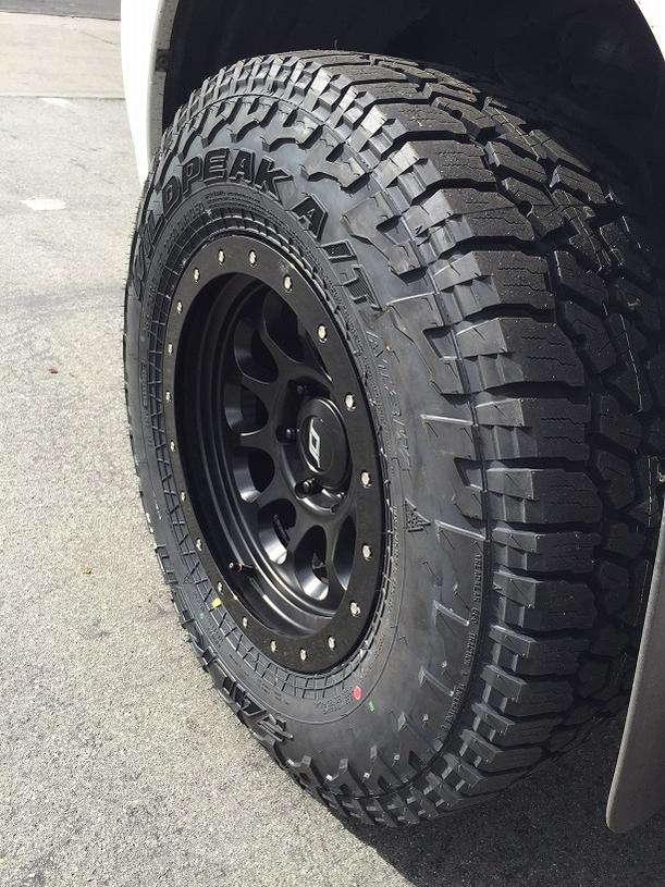

Ah, so mine are pushed out 0.75" further than yours are. That certainly doesn't help.
I was under the impression that I wouldn't have any rubbing problems since I have the Daystar 2.5/1.5, but it looks like some clearancing will be necessary. Good thing I didn't go bigger than 265/70/17!
I was a bit surprised about how much these rub as well. Well worth it for how well they perform and how quiet they are. Now I need 285's :P

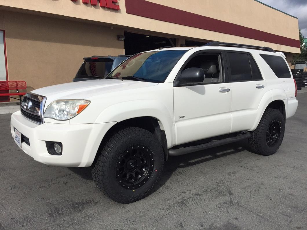

Good a picture? Sounds like a good looking/wheel combo
Next step after front wheel clearancing is the chrome delete (grill, handles, tailgate trim).

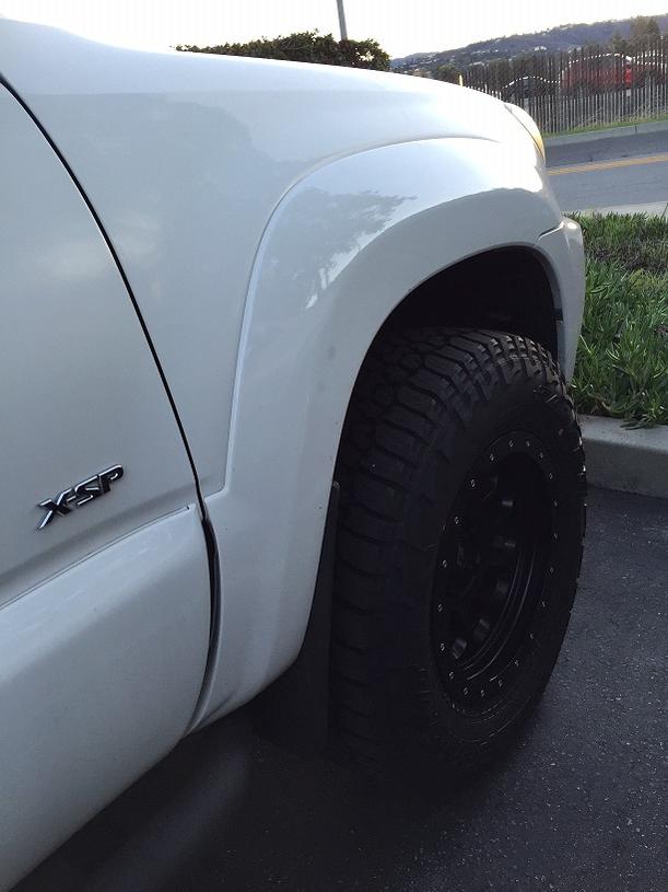

Does anyone have more pics from moving their fender well forward as described in J.A.'s post?
He describes it as having two screws on driver's side and three on passenger's side. I'm not seeing them.
You really can't miss them. If you get under the car, those 5 screws are the only screws visible and responsible from clamping the fender liner to the bumper cover.
