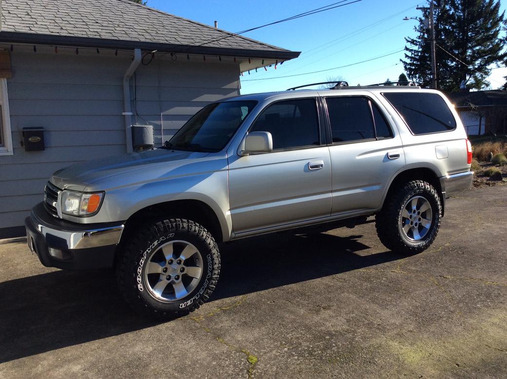

On my 99 I went to a 245/75/17 Goodyear Wrangler Dura Trac on 2011 17/7 4Runner wheel, same backspacing as stock 16" wheel, plenty of clearance with no lift. Also these wheels clear the 2005 Tundra brake upgrade.

2011 4Runner 17x7 with Goodyear Wrangler Dura Tracs 245/75/17 on my 1999 SR5
