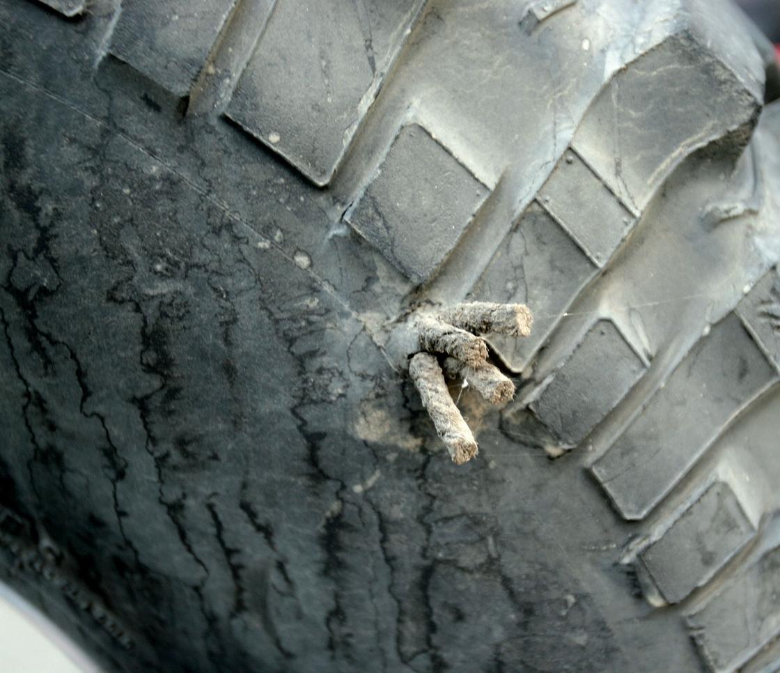

Tire Repair
The RMA (Rubber Manufacturers Association) is the authority when it comes to what is considered the accepted industry repair standard. There might be some minor differences between individual manufacturers (i.e. BridgeStone may say you can only patch their tires twice, while Toyo may say only once, ect.) But these guys set the standard that the ASE, Dealers, and Automotive Repair Industry follow as a legal guideline.
The above tire is non-repairable and must be replaced as per the RMA's guidelines. Now if you want to rope plug it and see if it holds (a patch/plug combo will most likely not hold long as the patch/plug combo will move too much in the sidewall area as it flexes and more than likely separate from the tire) that is on you and you alone. Chances are it will not hold and allow moisture to infiltrate the cords (if hasn't already) which will create rot in the sidewall and in the worst case cord separation and eventual failure.

  • 154_1008_03_o+154_1008_carnage_cures_trail_fixes_and_repairs+sidewall_tire_plug.jpg

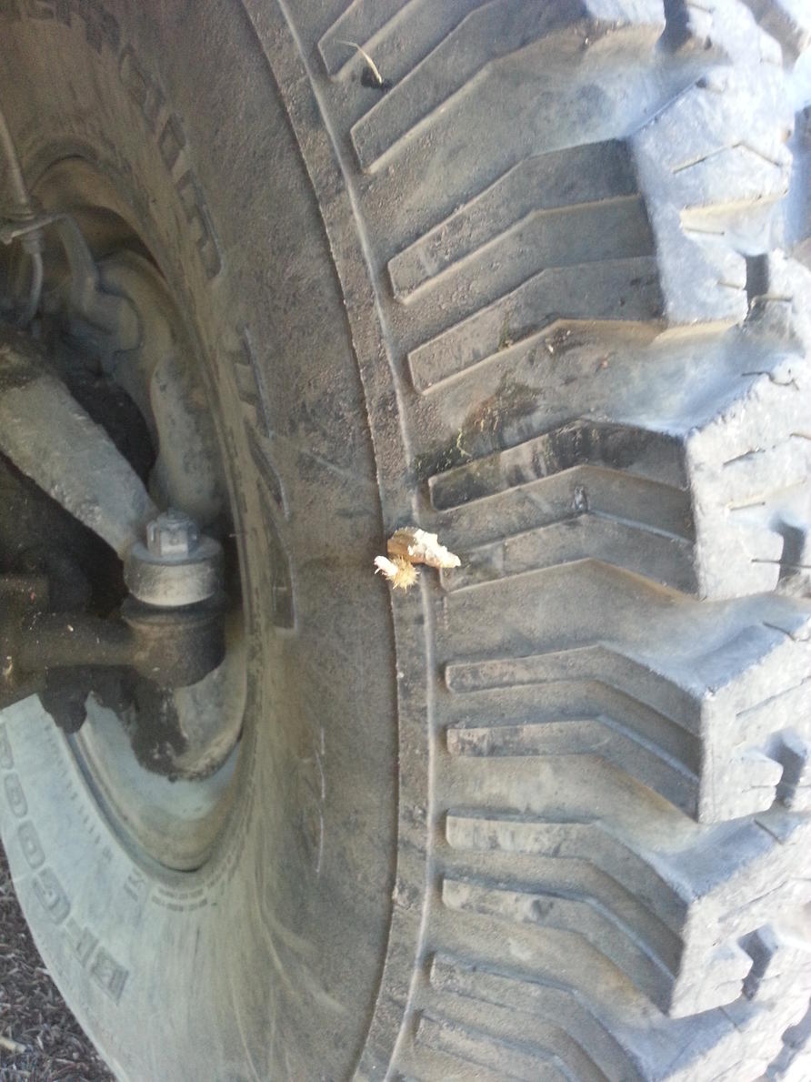

looks similar..
I had mine patched. that was over a year ago. however, I don't drive that 4runner very often, im not concerned in the slightest. if a repair is done properly, the patch becomes a part of the tire, much like welding.
plug it if ya really want, but if that thing blows out while you're in a turn.. like an exit ramp.. you can almost bet that you're gonna have a violent crash
