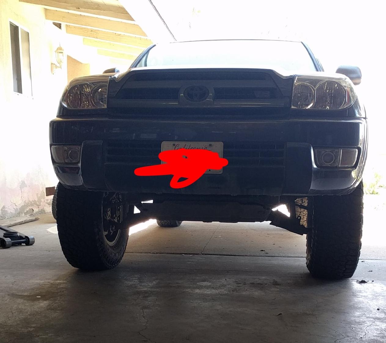

Before Maxtracs
For any of you who wanna know what it looked like before lift spindles. The lowers were getting to a pretty extreme angle and I wanted to soften up the ride.

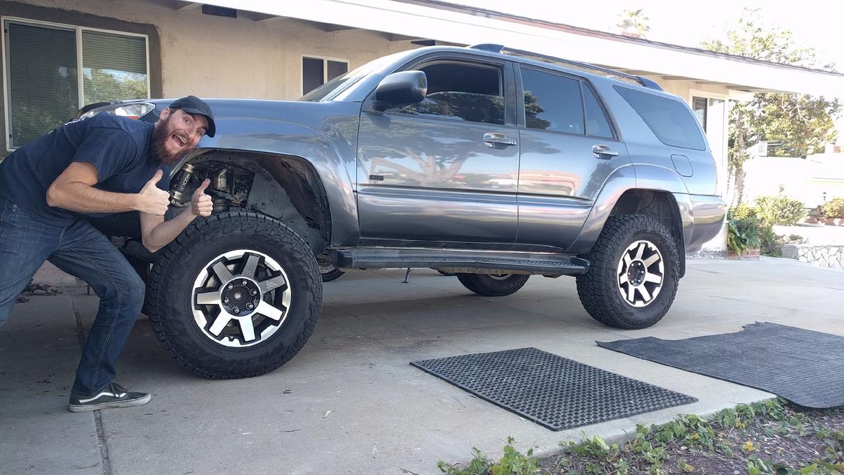

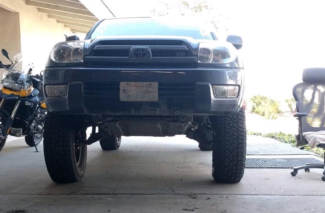

Immediately after putting the spindles on, without changing the preload or touching the alignment, it looks ridiculous haha. Featuring my older brother lol

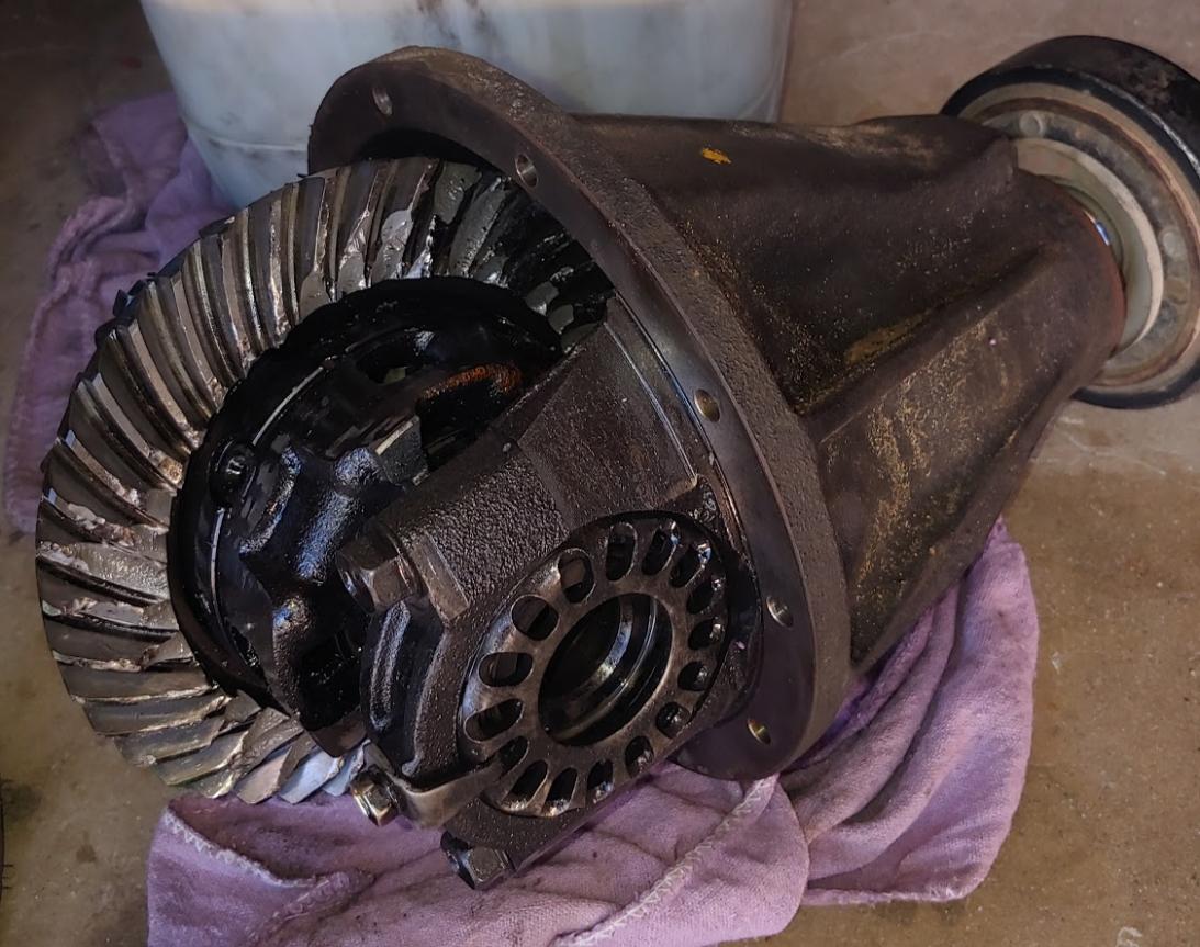

"Customer states load bang" :lmao:
Nothing like breaking on flat ground taking off from a stoplight. Having 33s finally caused some real damage other than mpg. :flamethrwoer2:
Took this as a chance to regear from 3.73 to 3.90 to make up the difference in tire size. I also didn't have any other option with gears because I could only find 3.90 members. Not the worst thing to break just super inconvenient. :shrug:
