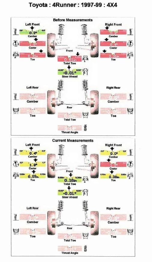

This is an alignment right after replacing my UCA and LCA bushings.

Are you rubbing mainly on the front right? The front right should be around 1.6-2.0* and its a little under. That could be enough to cause that tire to push into the pinch weld.
