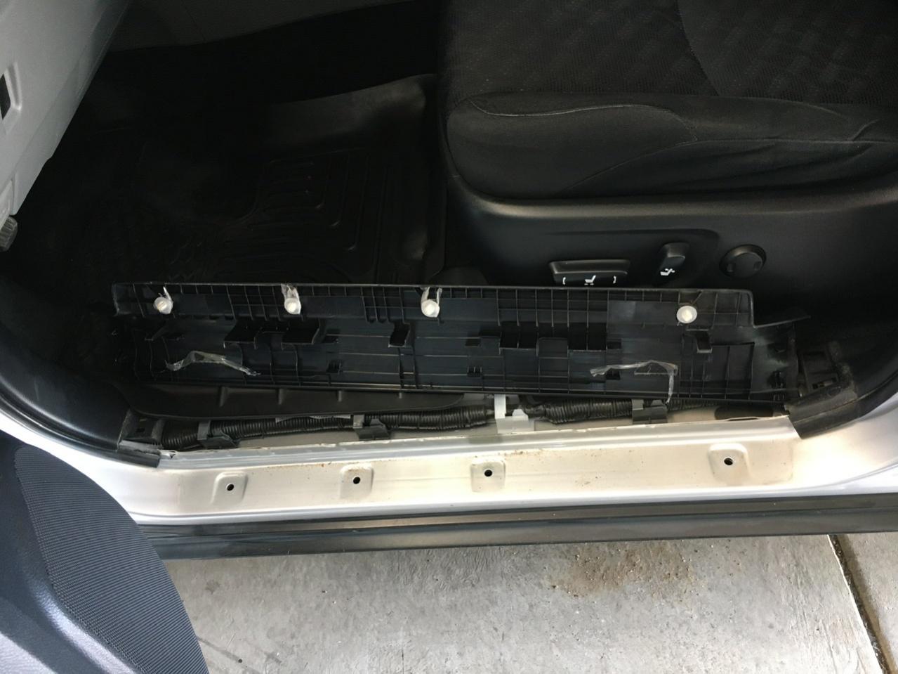

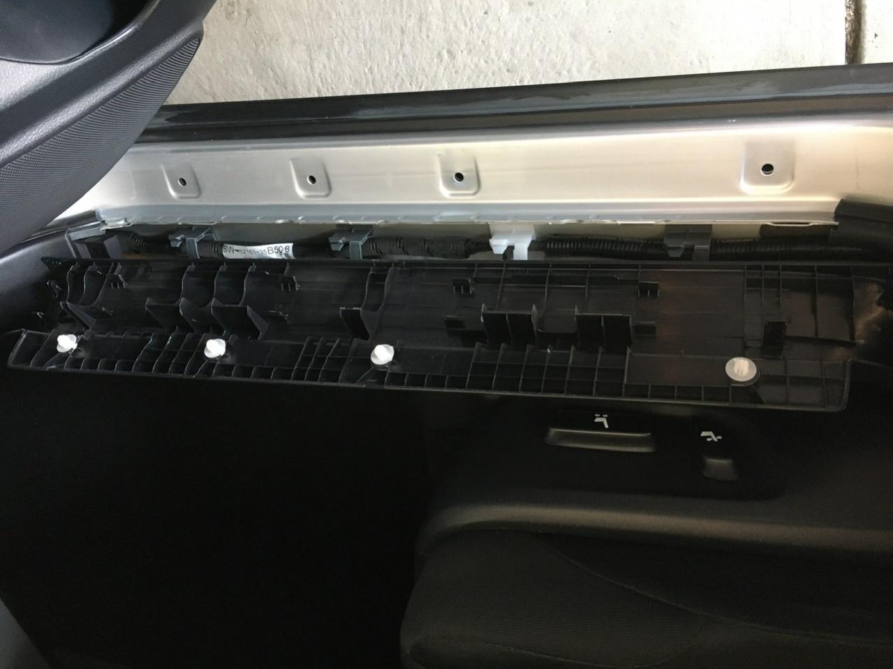

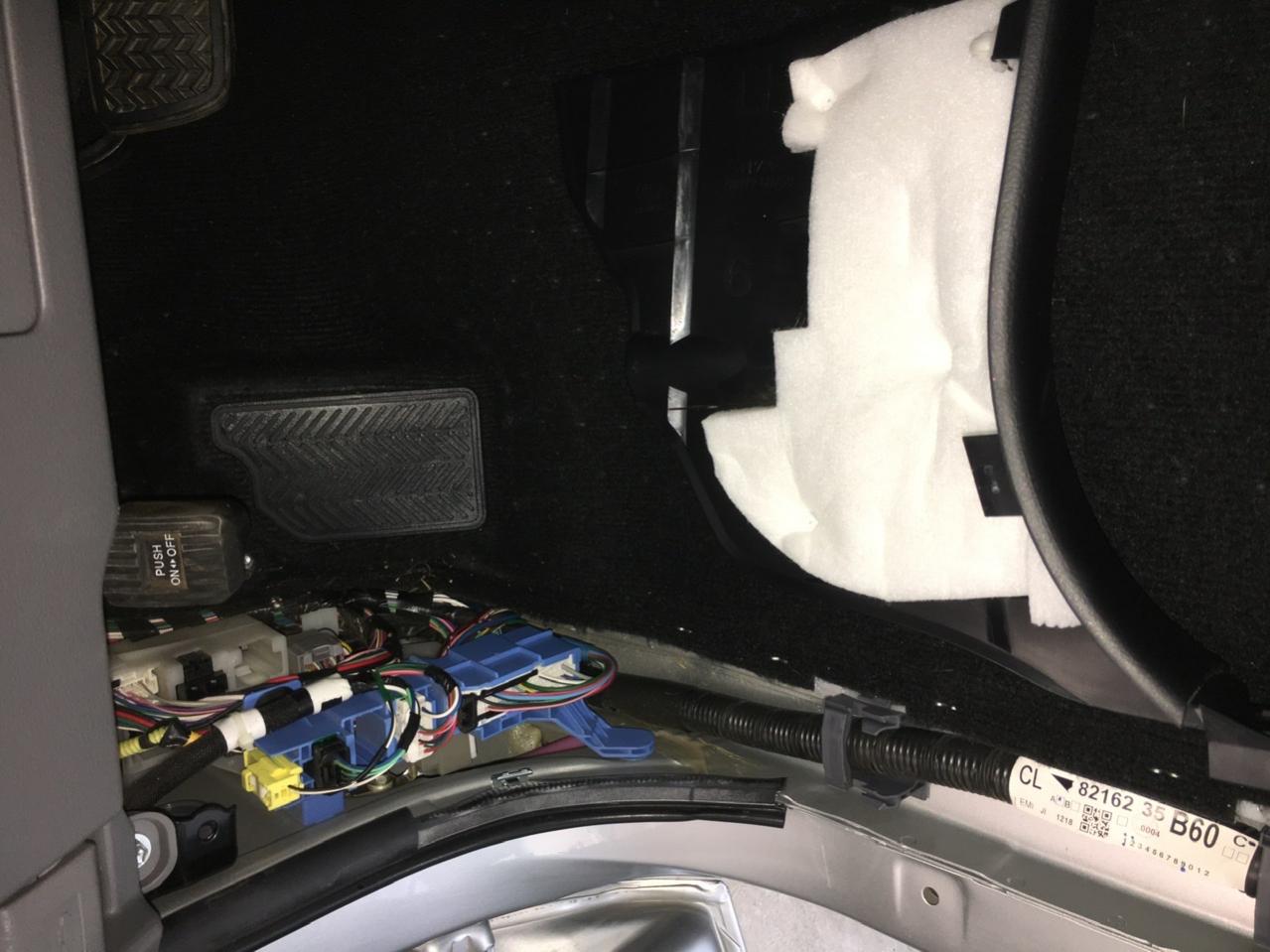

There are four fasteners that you can pop with a plastic trim tool. Mine had a little scuffing and dirt but looked pretty good underneath after 11 years. You need to pull these covers before you can pull the front kick panels for wiring and stuff.
