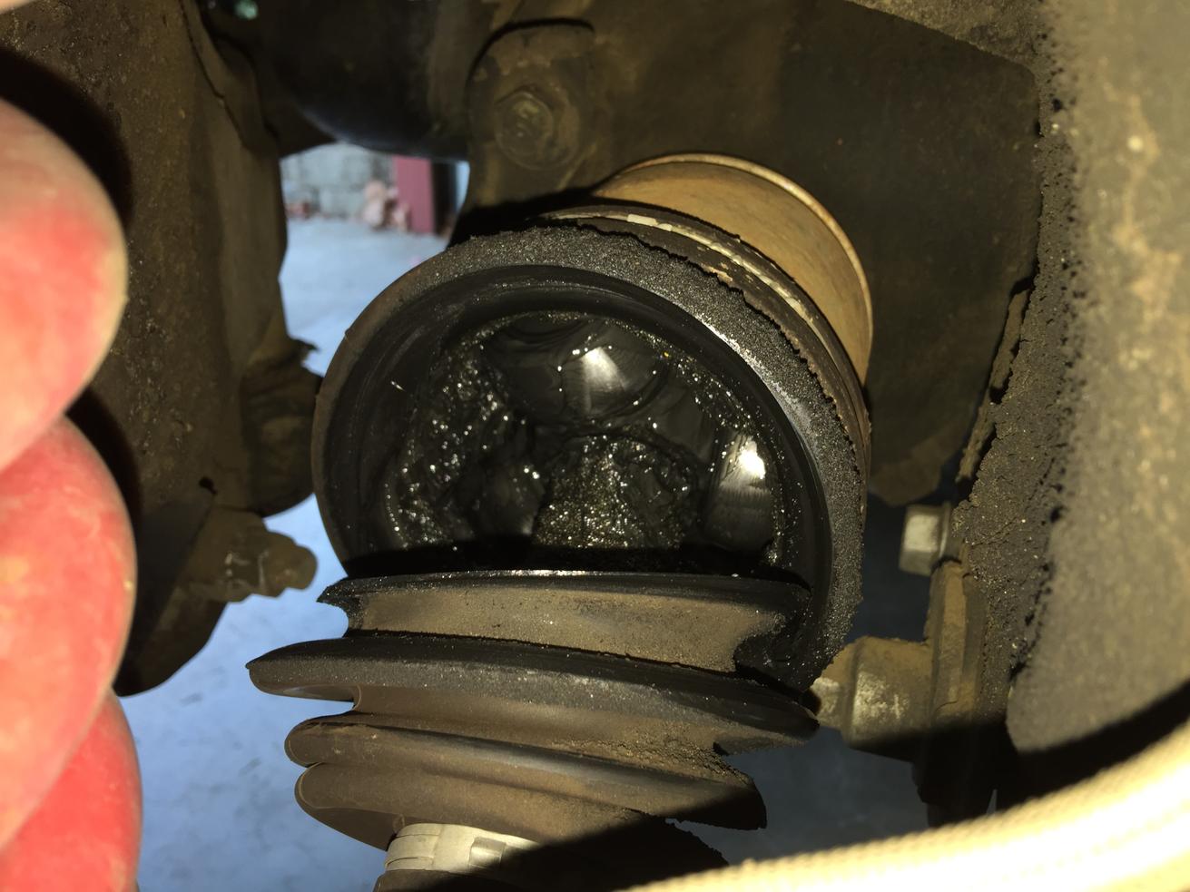

Torn CV Boot question WITH PICS

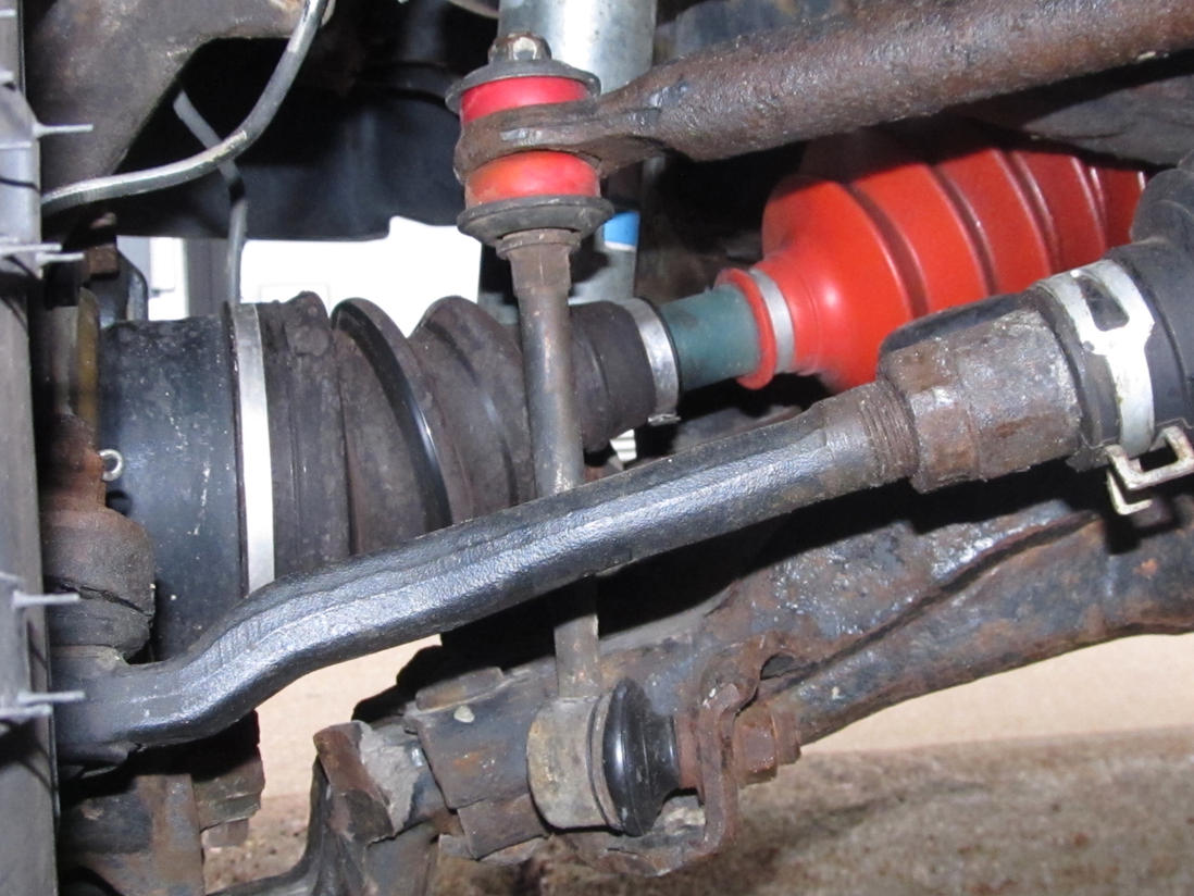

I wouldn't see why not, but I don't want to speak for them. You'll have to give them a call. I honestly was more concerned with having the long travel inners. I'll tell ya, once I stretched the outer out a bit, there's not really a whole lot of the shaft exposed. I'll post a pic of mine if you'd like.
ok guys.... My boot is ripped to shit on my passenger side.... after reading and reading.. decided to just reboot my toyota axels.... im getting everything together, like the pry bars, 35mm socket, and the hose clamp tool..

IS this the right boot kit? this is for my passenger side im doing both inner and outter boots at the same time... 04438-35060?
and are these boot kits the same for driver side and passenger side?
now while im in their should i replace both dust covers? any one correct part numbers?
I'm sure Toyota's boots are great. Are they the best? I don't know. You definitely can't go wrong with yota parts. I've had Napa remans on mine for 4.5 years now with no issues. But I did have to spread the inner boots out because the bellows were touching and wearing a groove in them after just a few months. I don't think the brand of boot is of utmost importance but if you're lifted it is important to spread the inner boots out so they don't touch.
When I rebooted it was the same part number for both sides and it comes with grease.
I reused dust boots
oem vs replacement aftermarket boot
I had ordered both the toyota outer boot and an aftermarket from an off road website... after some cross referencing the boot is from EMPI (the kit was mentioned earlier in the thread 86-2318). If it makes a difference... the Toyota boot seemed to be a much more rigid thermoplastic vs the EMPI which was softer more pliable (their catalog says Neoprene). I put the toyota boot on a year ago and aside from problems with the clamp (fixed by a worm screw pipe clamp), its held up against the bilstein/tundra lift. I'm about to the replace the other side with the empi boot. we'll see which one lasts longer!

We did an extended boot mod for the inner joints. [MENTION=102606]infamousRNR[/MENTION] is editing the video we made of the whole job and we'll have it out soon. I bought another CV pliers and I'm hoping I can get under his truck and get the clamps a little tighter. With the extended boot mod, the OEM clamps would not work to get a tight fit on the shaft so we had to use zip ties. I bought a CV clamp kit from Moog that will allow us to make a custom size clamps so we can replace the zip ties with a metal clamp.
Stay tuned for the video.
