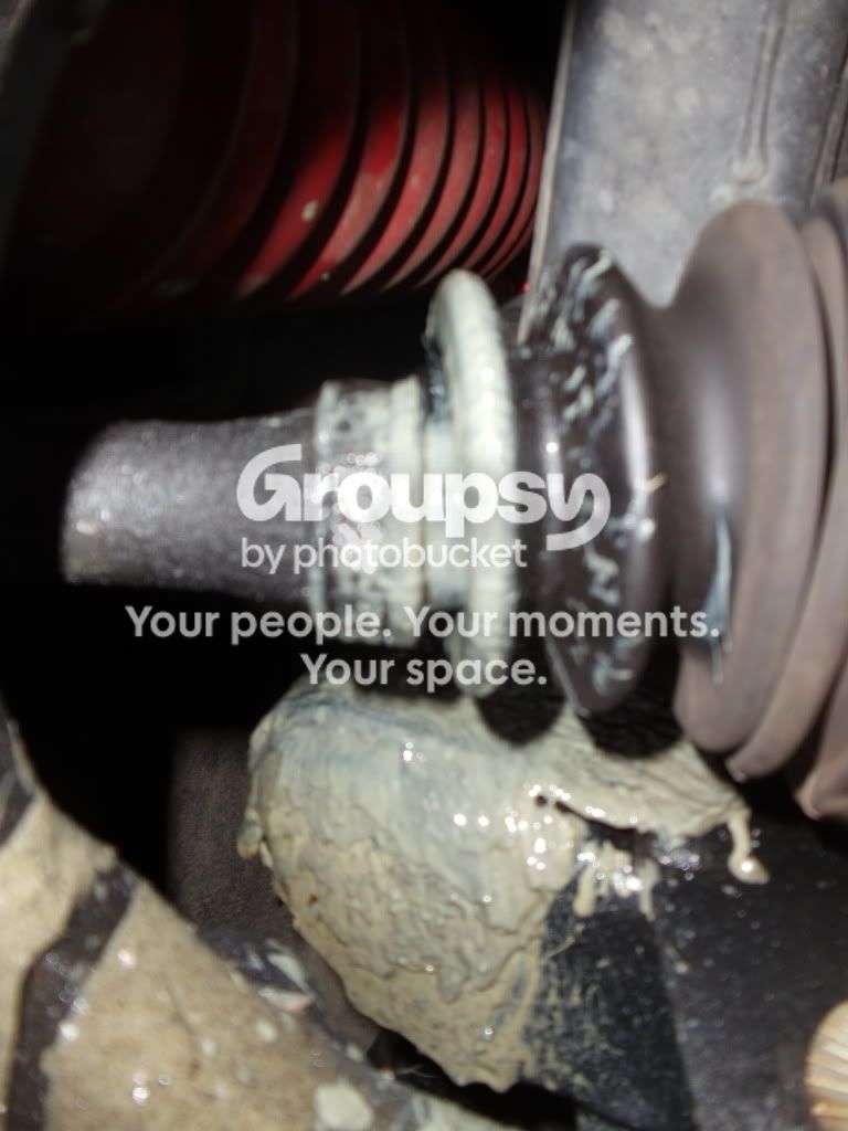

Was just underneth my 99 runner and seen the following pic with the both inners torn:

Prospectator, how come you need 2 sets? Would it be for the inner and the outer boots for both sides. If so, does one kit come with one side; inner and outer?
Also, how easy is pulling off the axles to re-boot them? Do i need to pop off the ball joints?
Thanks fellas!
Yeah you need one kit per axle. Remove the axle nut, and unbolt the lower ball joints and it will come right out. You don't even need to remove the rotor or caliper.

The Toyota kit only runs about $31.74 per axle, and includes everything in the picture below.
Thanks prosp! So what can I do to stop this from happening again or prolong it from happening sooner than later? I have camburg coilovers and uca but no diff drop. Will the diff drop help this issue?
Also, I read when I change them out that I will loose some diff fluid. Is there a way I can avoid that step or is it impossible to get around?
When I pull off the lower ball joint and axle nut, is it a PITA to pull out the assembly from the diff or will it just slide out?
How about the Tie Rod End? No need to remove to pull out the assembly?
