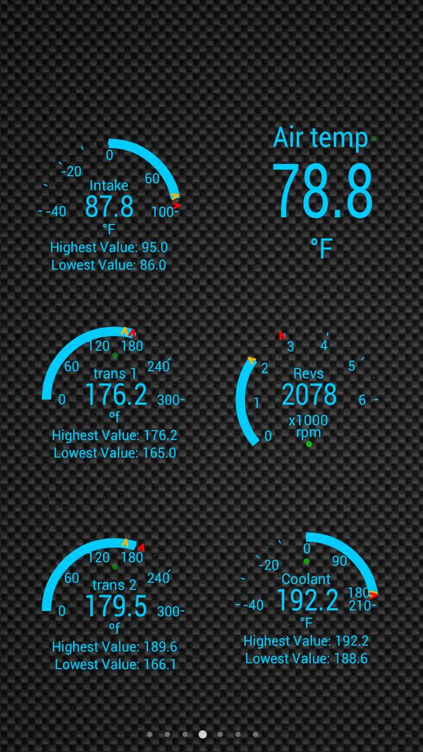

Here is a screen shot of the few temps I monitor on my 2010 Trail

Yep. Use it to monitor trans temp when towing, mostly. Use the eBay cable and techstream for anything more advanced.

How do you use the Torque app for tranny temps? I have the app and have used it for a couple of years, but never had the option for tranny temps (its not highlighted like the rest of the options). I have the pro version.

I found some formulas to add your own PID's for the trans temp.
For sensor 1 (Pan Temp):
OBD2 Mode and PID: 2182
Long Name: Transmission Fluid Temperature 1
Short Name: Trans 1
Minimum Value: 0.0
Maximum value: 300.0
Scale factor: x1
Unit Type: °F
Equation: ((((A*256)+B) * (7/100) – 400)/10)
OBD Header to use: left blank
For sensor 2 (Converter outlet temp):
Long Name: Transmission Fluid Temperature 2
Short Name: Trans 2
Minimum Value: 0.0
Scale factor: x1
Unit Type: °F
Equation: ((((C*256)+D) * (7/100) – 400)/10)
