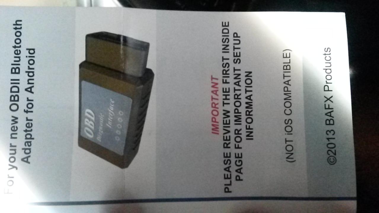

Attached is a picture of my OBDll reader which I bought from Amazon for $30.
As mentioned by jgue467 Torque pro has two displays for tranny temp readout. Only one display will show the tranny temp. I think it's labeled "method 2."

I picked up one of these the other day and was trying to get it to read transmission temp. I will try the method 2. Whatever method I was using, it wasn't working. But I was driving and didn't feel like messing with it.
