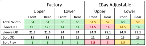

In other updates, I have run over the "Ebay adjustable arms" and taken lots of measurements compared to stock. As you can see there are a few bits that are not in spec...
I have been seriously helped out by a fellow V8 Surfer, who is machining me up some new high misalignment spacers, and a upper poly bush sleeve.
The old Diesel engine is being collected tomorrow too, and the guy that is having that has a press so is going to do my rear wheel bearings.
Hopefully I will then have everything I need to do some serious progression next week!

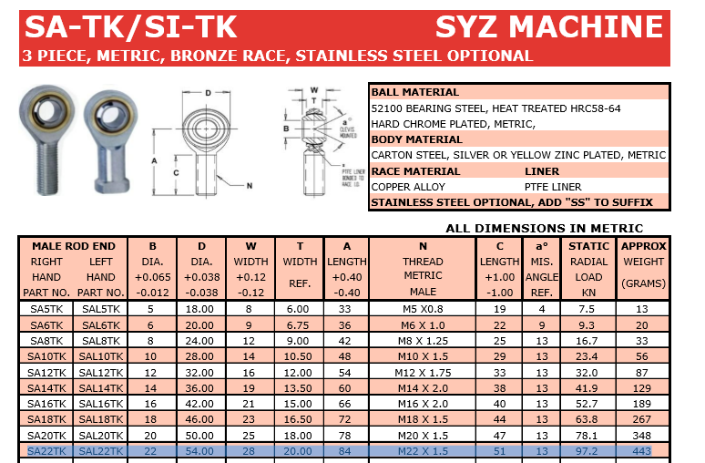

I've also included my highly technical schematics for the correct misalignment spacers for the Heim joints on these Ebay arms.
The specs for the supplied Heims are also uploaded, and highlighted.
I wil aslo need to shave 1.5mm off each side of the upper arm bush carriers, and add some side shims for the rear bushes (ideally 1.5mm thinck M14 washers each side....)

Regarding the Ebay adjustable rear arms, I decided they could be "improved" too...
The misalignment spacers that the came with weren't very good, as mentioned in my earlier post (#55), they were badly machined, badly finished, and not the right size... if you are being fussy.
I also didn't like that the upper arms were a little too wide and the bush would rub against the axle upright, so I decided to shave 3mm off the upper bush ends.
I don't have a milling machine so I cheated a bit and used a belt sander.. it was only 1.5mm to be removed from each side, and this seemed to be the easiest way to do it with my limited tools giving the best result.
You can see the difference between my modified and the standard thickness (Out the box, uppers and lowers were the same width)

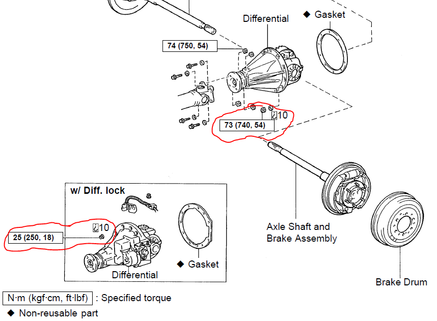

The issues weren't over yet... I did something really stupid next... which in my defence is a result In a mistake in the TSRM!!
I took note of all the torque settings and started torqueing up everything as it should be, at the time I did think "that's weird, and a crazy amount of torque for a very small nut and stud"... even when tightening it up I thought "This doesn't feel right" checked the numbers again and carried on, stripping the thread on one nut.
It turns out that the TSRM states that the diff carrier bolts should be torqued up 3x more than they should be.. and like an idiot I didn't question my gut instinct...
I attached a screenshot.. spot the error!!!
Needless to say, the stud and nut were very easily removed (yay new parts come undone nicely too) and replacements are on order from Toyota, to arrive on Tuesday.
