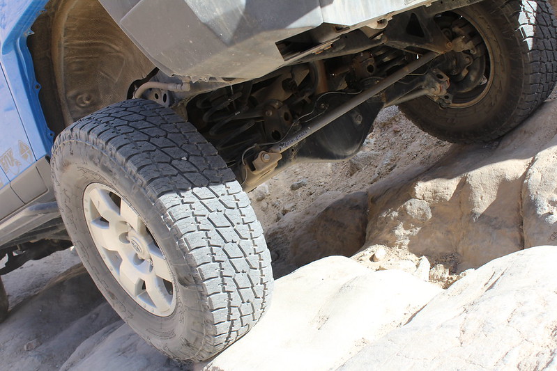

Upskirt shot of our Chromoly Adjustable Rear Links gettin' dirty!
4Runner - Chromoly Adjustable Rear Links
