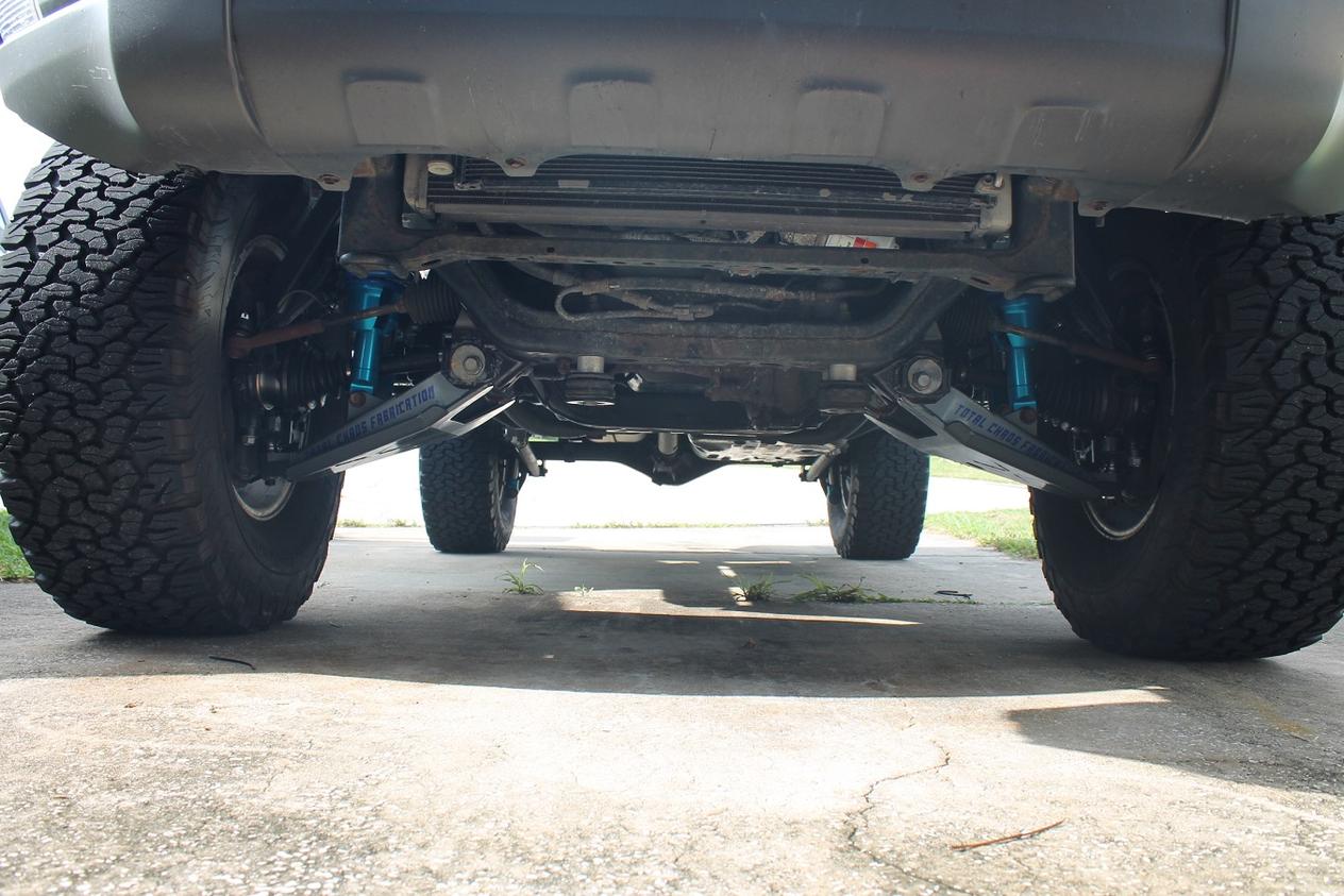

Dual Front-alignment 03' Sport V8-"Pearl"

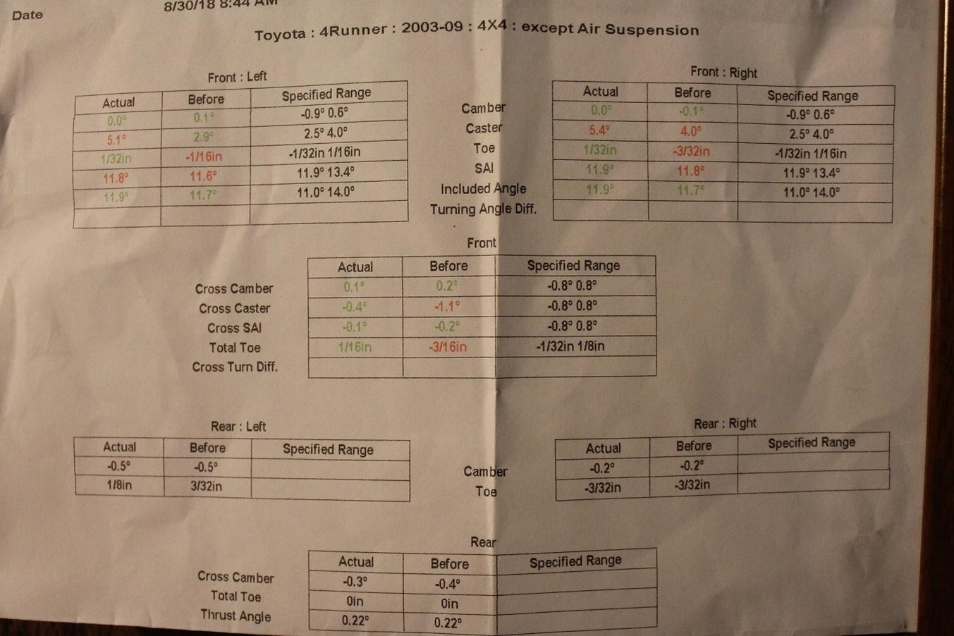

Just got back from Firestone-Merritt Island, Fl. My alignment tech for a couple decades now, Steve Locklin earned his $20 tip, and dialed her in perfectly. He has done lifted trucks now since the 70s, even owns a lifted vintage mid 60s Ford, and has been doing my 5th gen w your UCAs for years now. Gave me as much Caster as he could to help clear the secondary reservoirs in the back of the fender well.

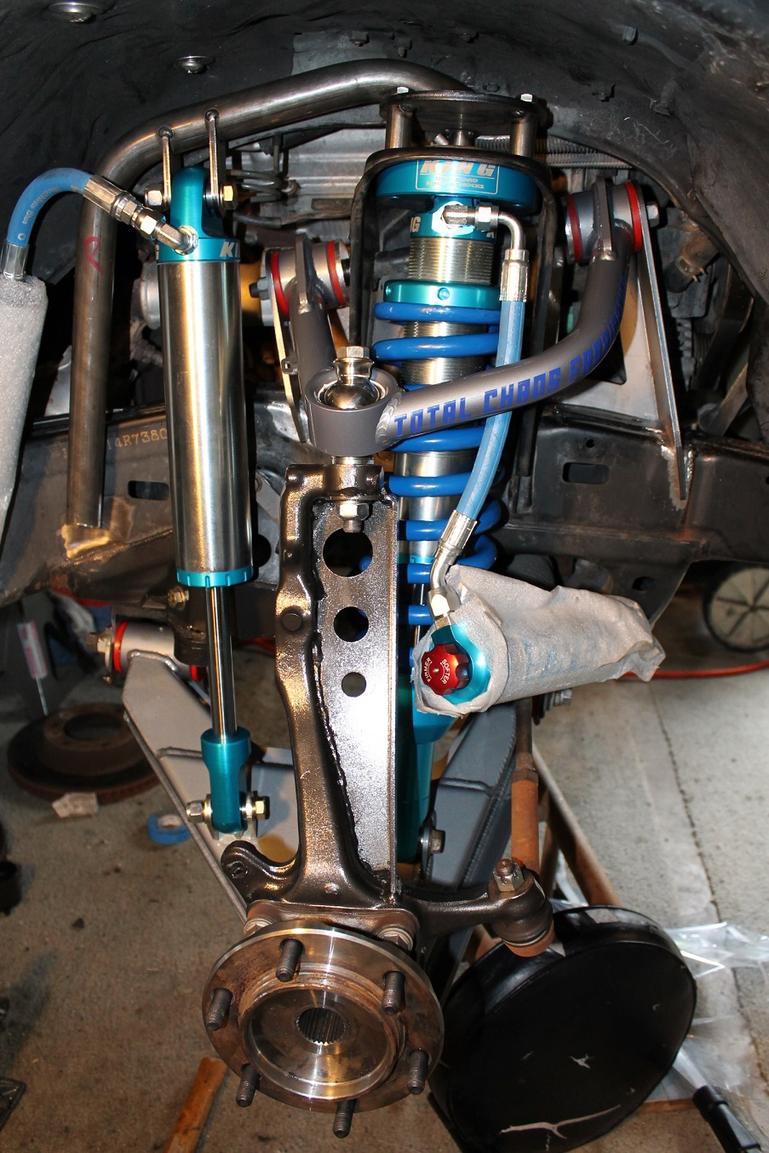

Pre weld mock up-Tower Gussets, Dual Shock Hoop, and Cam Tab Gussets.
Alignment tech said the Cam Tab Gussets worked really well and I was only 3/16 toed out on my eyeball adjustment lol.

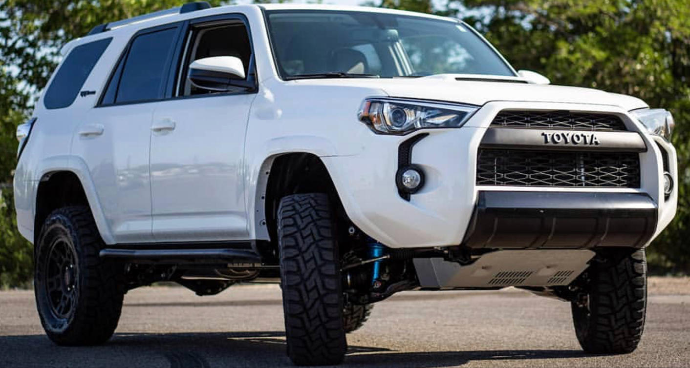

Installed my UCA last week and absolutely love how it drives now. Coming from a lifted JKU on 37s, I thought my handling was just fine with bilstein 6112s and stock UCAs.
I was torn on the uniballs, but glad I went with TC. Great quality product, highly recommend it.
