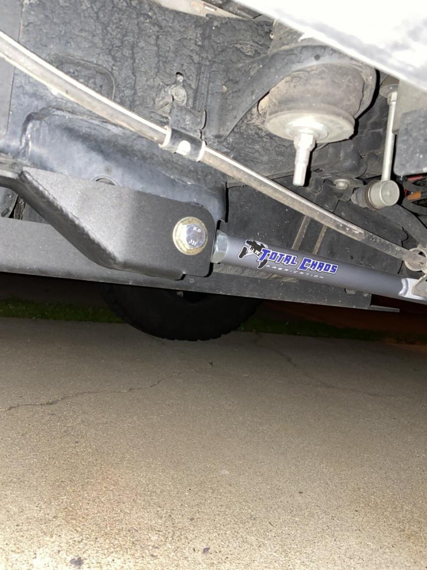

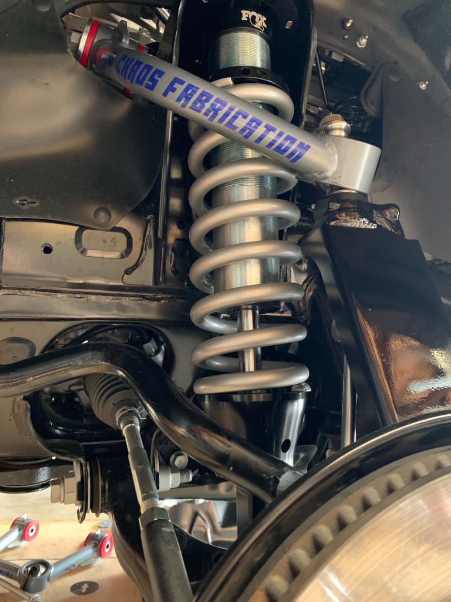

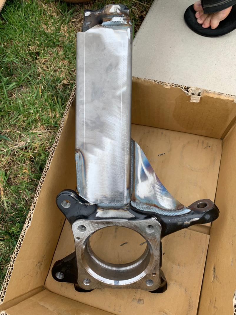

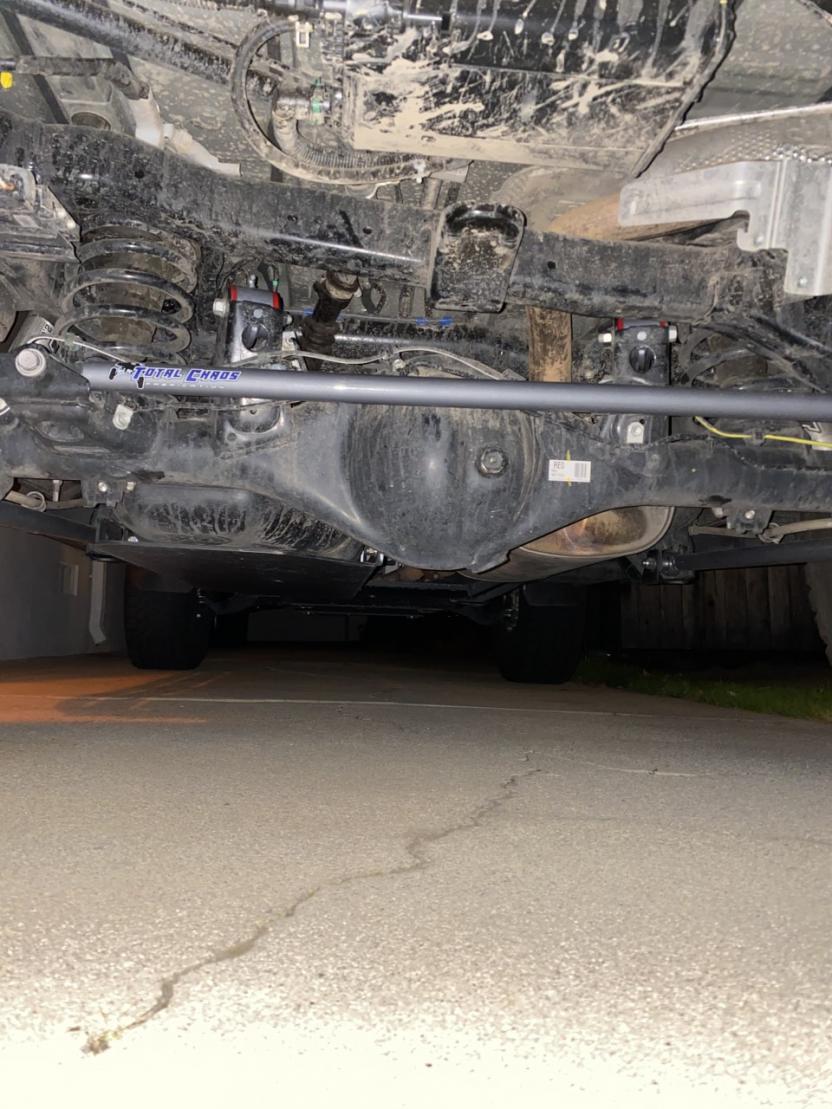

TC UCA's, Spindle Gussets, Rear Links & Panhard. Love the quality of the products and highly recommend to everyone.
