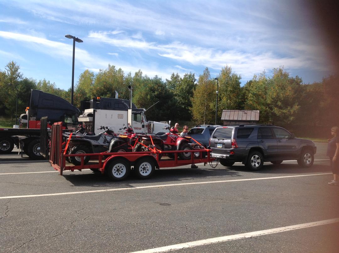

OP, I've got an 07 v6 4x4.
I pulled a 7'x16' equipment trailer with 2 wheelers, Honda Rancher 400 and Can-am outlander 1000 xmr, from central VA to upstate New York with no issues. 1600lb trailer, 560lb Honda, 1050lb Can-am =3210lbs. Add to this about 300lbs of gear, clothes, etc etc and another 210lbs for my winch, mount, and added accessories.
Total extra weight comes in around 3700lbs.
I never experienced one single problem over the course of my 1 week trip. No issues with trans or oil temps, even when climbing through the Adirondacks.
ETA: I used a weight distributing hitch with anti-sway bar and trailer brake controller.
