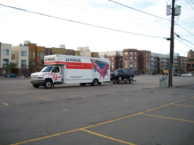

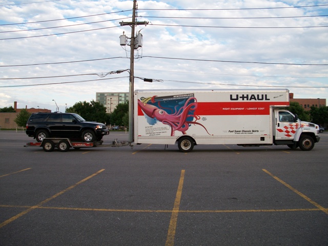

Borrow the Suburban or rent a pick up from U-Haul and get the auto transport trailer! They are set up with surge brakes so your tow vehicle does not need special wiring. If you use a tow dolly they are noisy and handle terribly when they are empty. They bounce a lot! You will need to disconnect the drive shaft on the towed 4-Runner or Subaru or you will be needing a new transmission. Then it's hard to get the vehicle off the dolly until you've put the shaft back on. I just towed my "new" 1st gen 180 miles on a tow dolly and the worst part of it was driving up with the empty dolly. My tow vehicle was a 6 cyl minivan and I was worn out (with worry) by the end of the day. Don't count on a car you just bought to drive/tow 800 miles!
