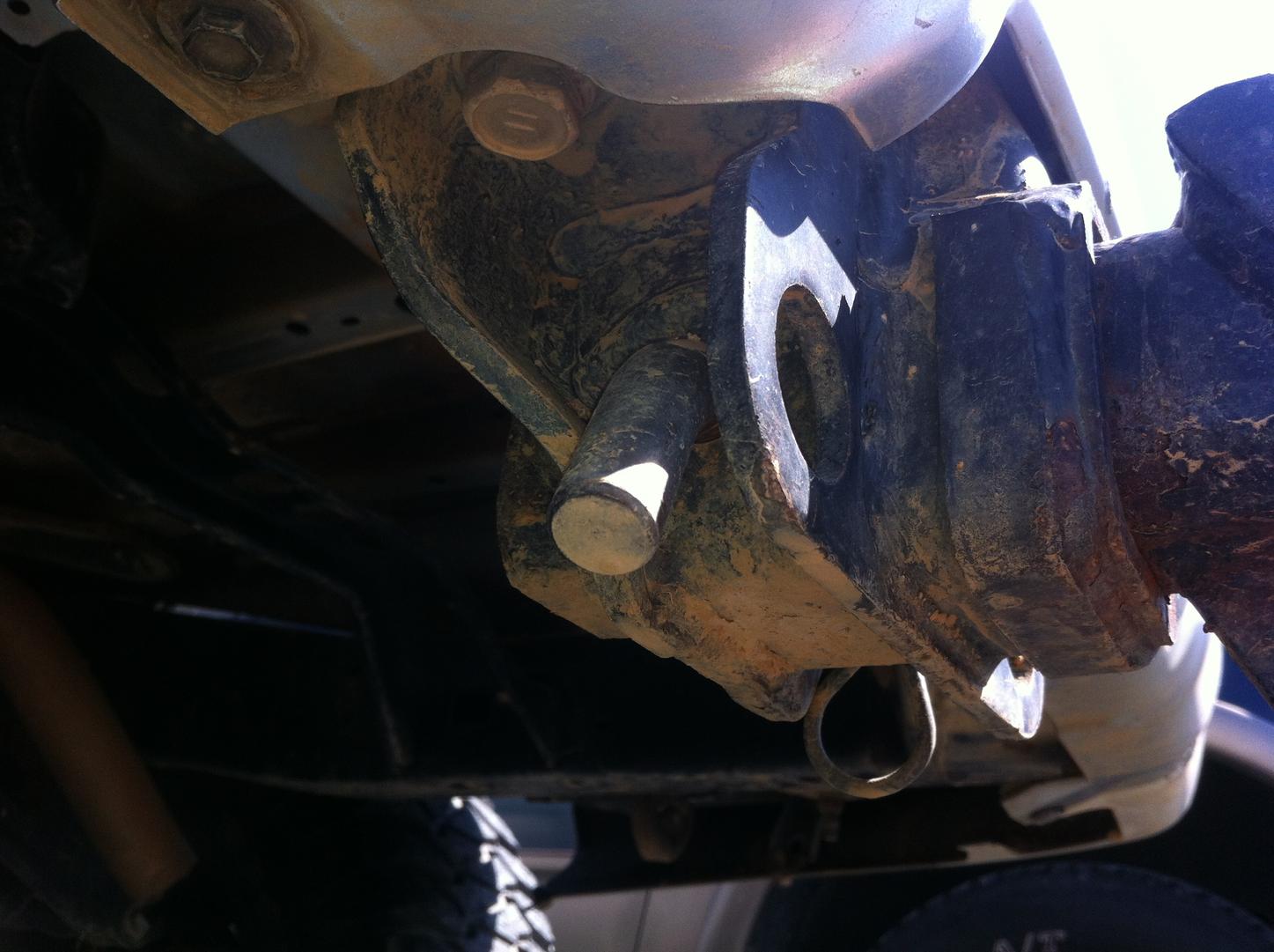

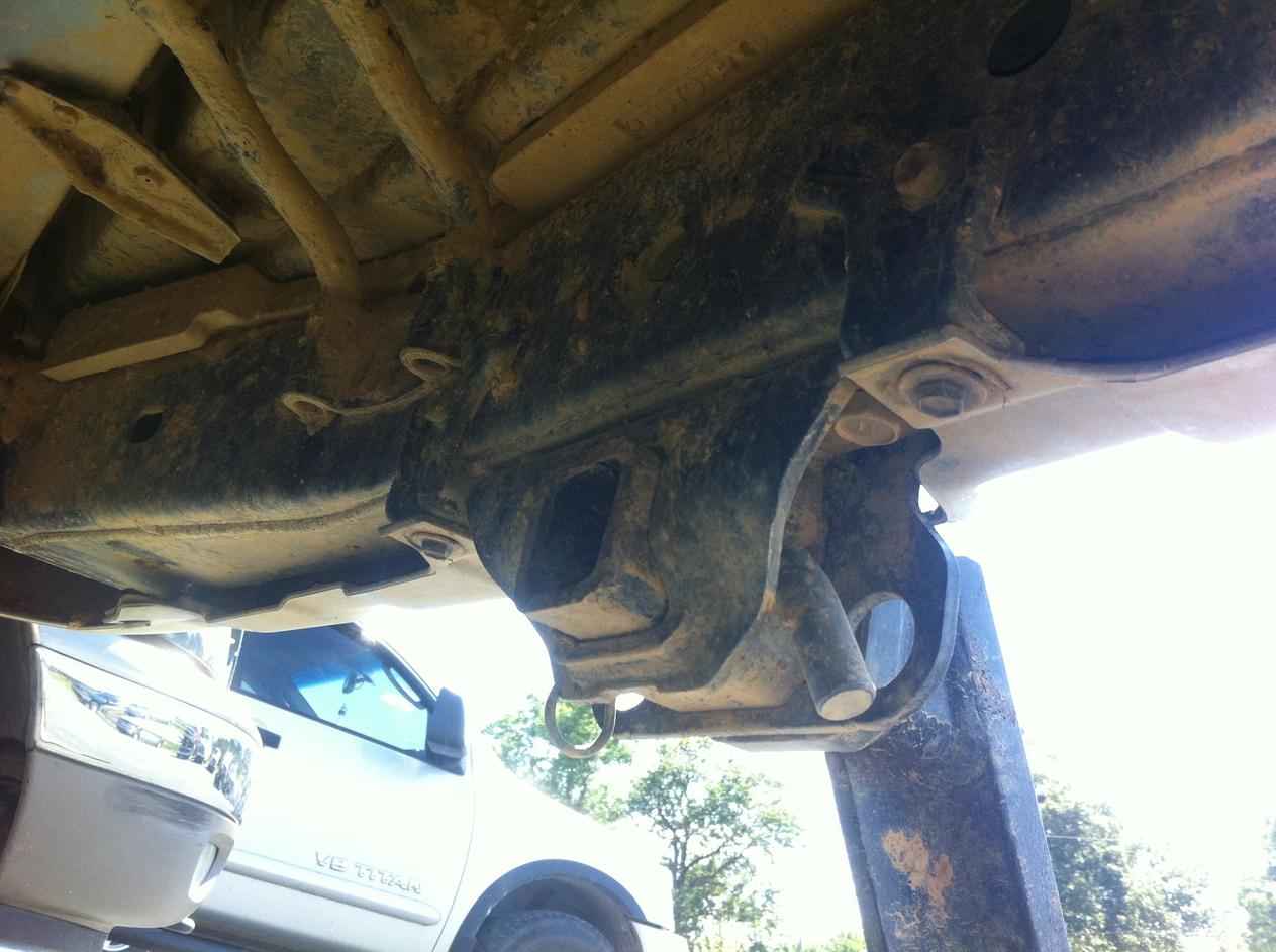

After talking to toyota I've been informed that this is the upgraded hitch that they replaced the orignal with can you guys confirm this for me??? the service tech personel informed me that if it has the plate welded on the hitch side of the cross member that it is the 7000lb hitch

I'll look at mine this evening (produced 03/03). I bought mine used, but I believe it has the original hitch. I spoke with the local Toyota dealer a year or two ago about this, they were clueless and only offered to sell me an aftermarkethitch. At least you found a dealer with knowledge of the issue.
Just to add (or restate), the hitch was also changed in 04. The 04 and newer models have a weight distributing hitch, but as far as I know the rating is the same as the new style 03 hitch.
Edit: took a quick pic of mine. Can't say for sure with the spare in the way, but mine looks identical to yours. Since yours was built after 05/01, you should have the updated hitch. Perhaps mine was replaced at some point. I'm not sure exactly what is different about the updated hitch, so hard for me to be certain. Definitely curious about this. I know on mine, the receiver wouldn't fit, it hit the spare tire. I ended up chopping about an inch off the bar. I was thinking this was one of the reasons for the replacement.

nah, mine was built in 04 of 03 unless you ment to say 01? i'm assuming you thought mine was built after 05/03(april of 2003 is my build date i originally typed 05/03 but changed it lol my bad). but i was told that if it has that outside plate (the one you hook your safty chains to) that it is the upgraded hitch.. an ours seems to have that plate i just wish there was a way to confirm it befor taking a 6800lb load down the road I did pull a chevy duramax out of the mud once I'm pretty sure he weighed more than 7000lbs plus the extra force the mud adds and i didnt break the hitch or truck in any way who knows?
Those pictures are not of the upgraded WD hitch. The WD hitch is tubular and mounts on the frame rails and not on the cross member like the one you have pictured.

My bad, thought I read August somewhere. All this time I was thinking I had the original hitch. I will pull the Toyota service records, I would think the replacement hitch should be documented.
