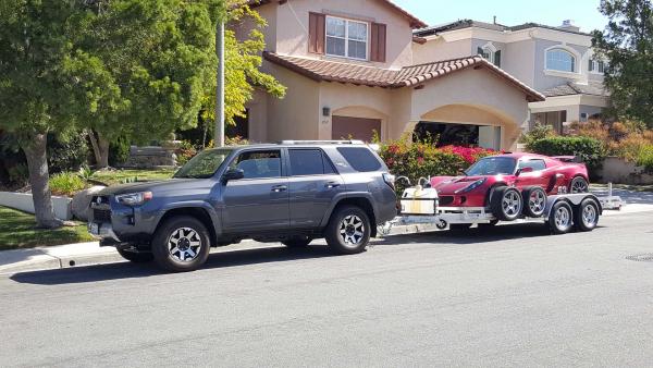

I have been towing a 1800# Carson dual axle car trailer with a 2800# track car and another 400# of stuff several times a year in Southern California. We have a lot of heat and mountain passes. I also have a Tekonsha P3 brake controller. No airbags, no weight distributing hitch and no transmission cooler.
I have a 2016 Limited 4WD and I don't notice the squat in some of these pictures, maybe the XREAS helps? I simply pull the car on until the rear end starts to squat a little and strap it down.
I have not had any issues other than the lack of power is annoying. I can still pull 50 mph over Tejon pass, but the temperature at the transmission torque converted gets up to 250 degrees F and 200 in the pan when it kicks down into 3rd. On the flat it pulls 65-70 in 4th/5th easily enough and temps are in normal range. I am going to change the transmission oil at 60k per the manual and send off for analysis. I am thinking about a transmission cooler.
Brakes work great on the downhill grade. I do downshift to 3rd sometimes on downhills when I am lazy, but usually just use the brakes in 10 mph increments (when truck gets to 60, use brakes to get down to 50) to avoid overheating. I have not experienced any brake fade or overheating.
My next vehicle I might look at a truck, but I am going to drive this for the next 5-10 years.

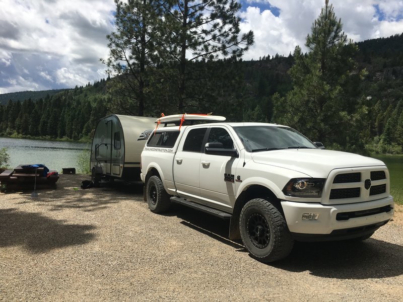

Have pulled our rPod in a few times with our T4R, I just find it very underpowered once you hit highway speed with all the wind resistance. I also have a tuned cummins so makes way more sense just to use that

That your house? One amazing view, do not know if could get use to such a thing, lol.
