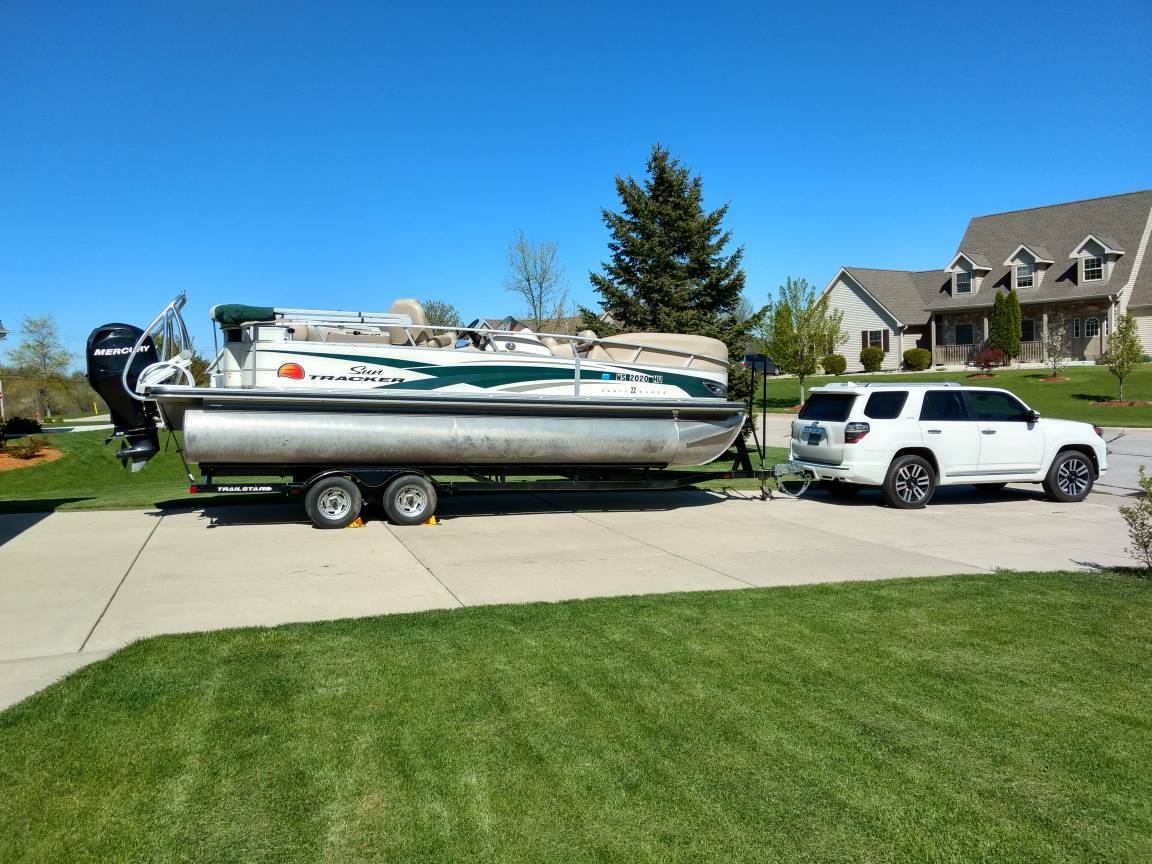

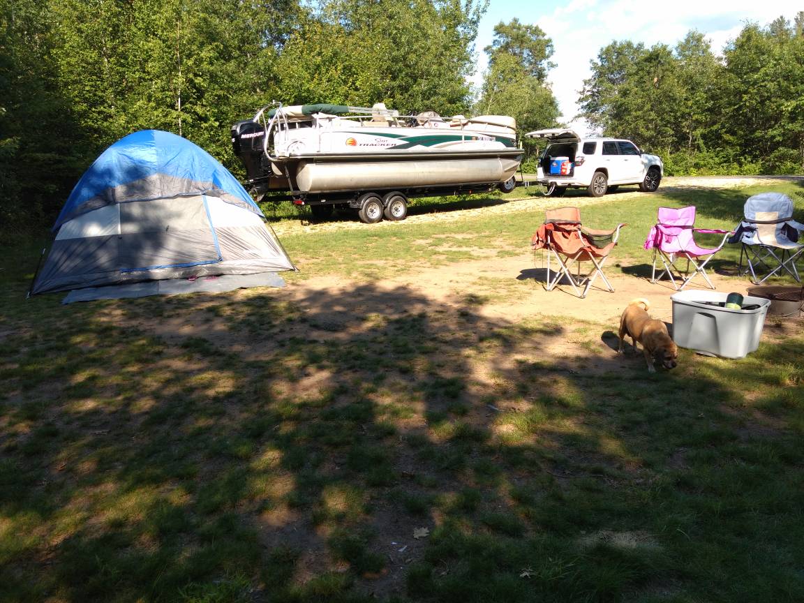

I have gone on many longer trips pulling my pontoon boat along with camping gear and a dog.
Estimate the gross boat and trailer wait at 4300 loaded, another 700 of people, gear and dog in the car.
Honestly it pulls quite well. It is very happy at 65mph in 4th gear getting 10mpg.
I have and HIGHLY recommend you get rear airbags installed for safety and stability. Well worth $200.
I also have a transmission cooler installed and monitor my transmission temperatures with an OBD2 adapter. Trans temps stay at a consistent 170 F and that is in 90 degree heat.
Mainly in Wisconsin which is hilly in many parts but no mountains. Trans will spike maybe twice a trip to the 190s on the very long inclines for less than 1 minute.
Unless you live in the mountains I do not see any reason you would have trouble pulling a large pontoon and heavy double axle trailer. Mine has surge breaks and everything stops very quick for so much weight. I would not pull without trailer breaks (have tried it on the 4runner and took way to long to slow things down).
Just drive safe at 65, give yourself room, stay alert and you are all set!

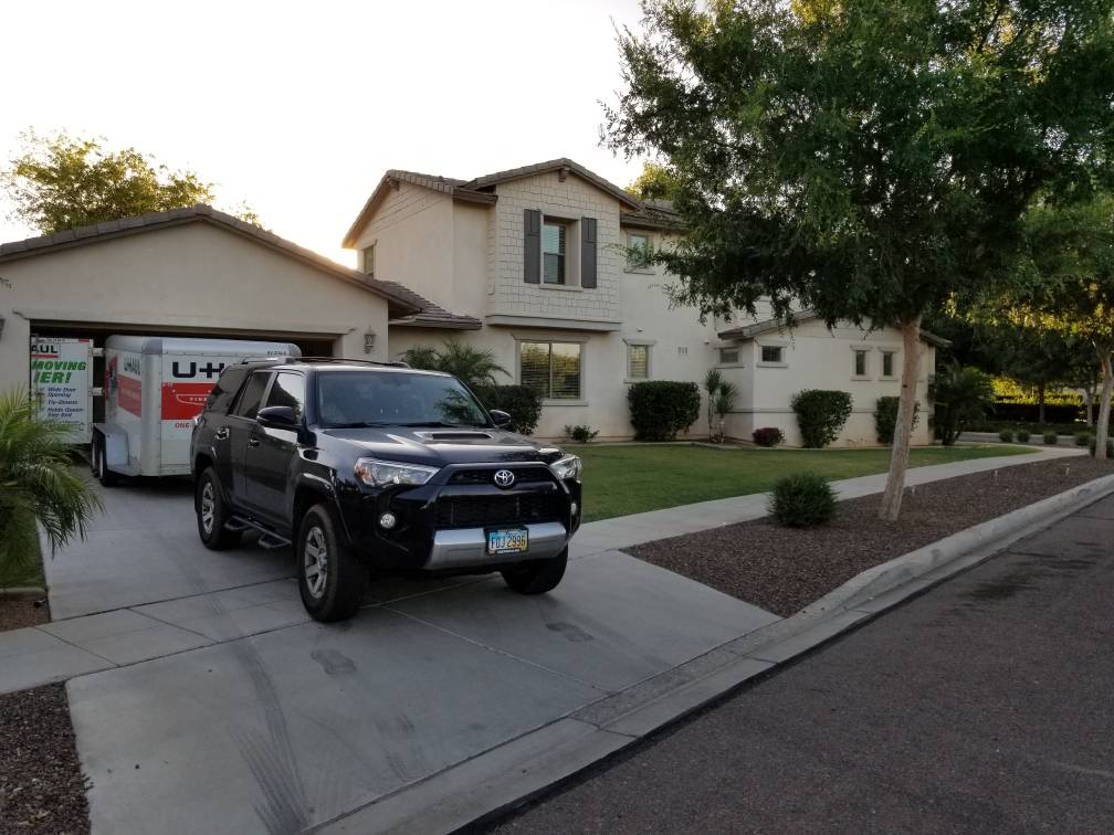

I towed the largest enclosed Uhaul trailer fully loaded from Columbus OH to Phoenix AZ in my stock 2016 TEP with no problems at all, just shy of 2000 miles over 3 days. I would guess the trailer and contents to be around 4400lbs, about 390lbs of human, 160lbs of dog, and 100lbs of bags inside the 4Runner . I was surprised at how well the 4Runner handled the trailer at freeway speeds, pulled at 75mph with ease in S4. Averaged about 14mpg from OH to CO. Through the mountains of NM and AZ got about 11mpg. It did struggle a little on the long uphill stretches, but dropped to S3 or S2 depending on the incline and kept the rpm around 4000 and never doubted it would make it to the top. My hitch has a 2" drop and was the perfect height for the Uhaul, everything balanced great, probably about a 3 inch sag, front end felt a little light when steering but never experienced excessive sway issues. I took a lot of care when loading the trailer to make sure the weight was distributed correctly.

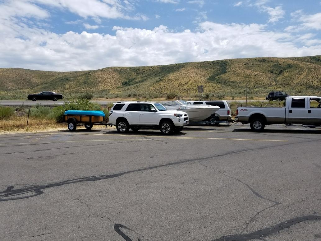

Towed my boat to the lake. Wasn't sure if it would be okay on the hills without an engine brake. I made it safely though!

Believe it or not - I did it without trailer brakes. And I even had the paddles in the trailer too!
I would normally put that on the roof, but that state park access to the lake has pretty small parking lot - and it's usually full. Monday was a holiday here so parking was full. But the trailer parking usually has spots - and you're only allowed to park there if you have a trailer. So...
