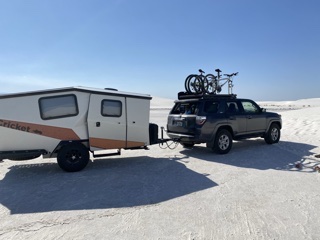

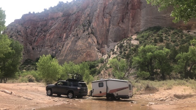

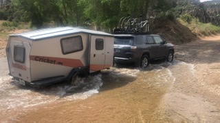

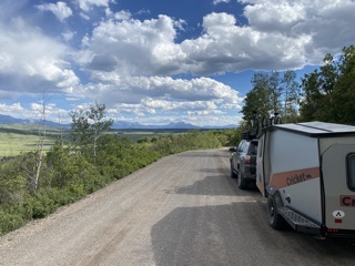

I feel anything under the 70% threshold should be fine. We did 7,200 miles this summer from South Florida to Yosemite and back with our Taxa Cricket. It’s about 2,500lbs loaded, plus we had the 4Runner loaded with 2 adults, 2 kids, a dog, bikes and probably 2-300lbs of gear in the back (fridge, food, recovery gear, etc...). I am still on the OEM suspension after almost 90k although airbags in the rear springs were the best $100 I’ve spent on the 4Runner.
The 4Runner towed like a champ, including over 300 miles off-road. Definitely tow in 4d and I would say under 3,500lbs is the sweet spot for our vehicles. You do have to go in with the realistic expectations that if you are towing anything, keep it under 70mph and just enjoy the ride. Of course the more aerodynamic the trailer the better as well.

That’s an awesome camper! How did you go about putting airbags in the rear? Any write ups you would recommend?
I’ve got a write-up on here for my install of Firestone Coil-Rite airbags. As mentioned, it’s the best $85 you can spend if you’re towing.
