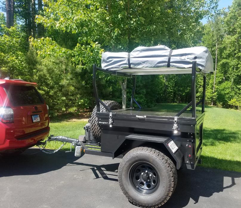

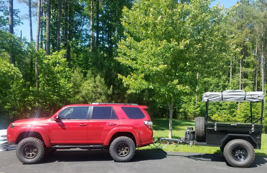

I went with a m416 (1/4 ton) style military trailer made by Ruger trailers. Pulls almost unnoticeable and stops great with electric brakes. Plus I can still move it around the garage by hand with no problems.
The m105 is a Monster trailer. It's a 1 1/2 ton trailer made to be pulled by a Super duty truck not a 4runner. I would steer away from this.
You could go with something in between like a m101 3/4 ton. It's still a big wide trailer and I would not want to take it on the trails offroading but the 4runer could handle towing it.

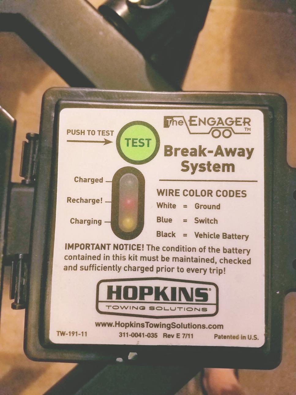

Electric brakes and a break-away system is a must for these types of trailers IMO. If you are worried about MPGs with the trailer then you shouldn't get one. I get about 40 MPG going down the mountain and about 4 MPG going up :whoo:

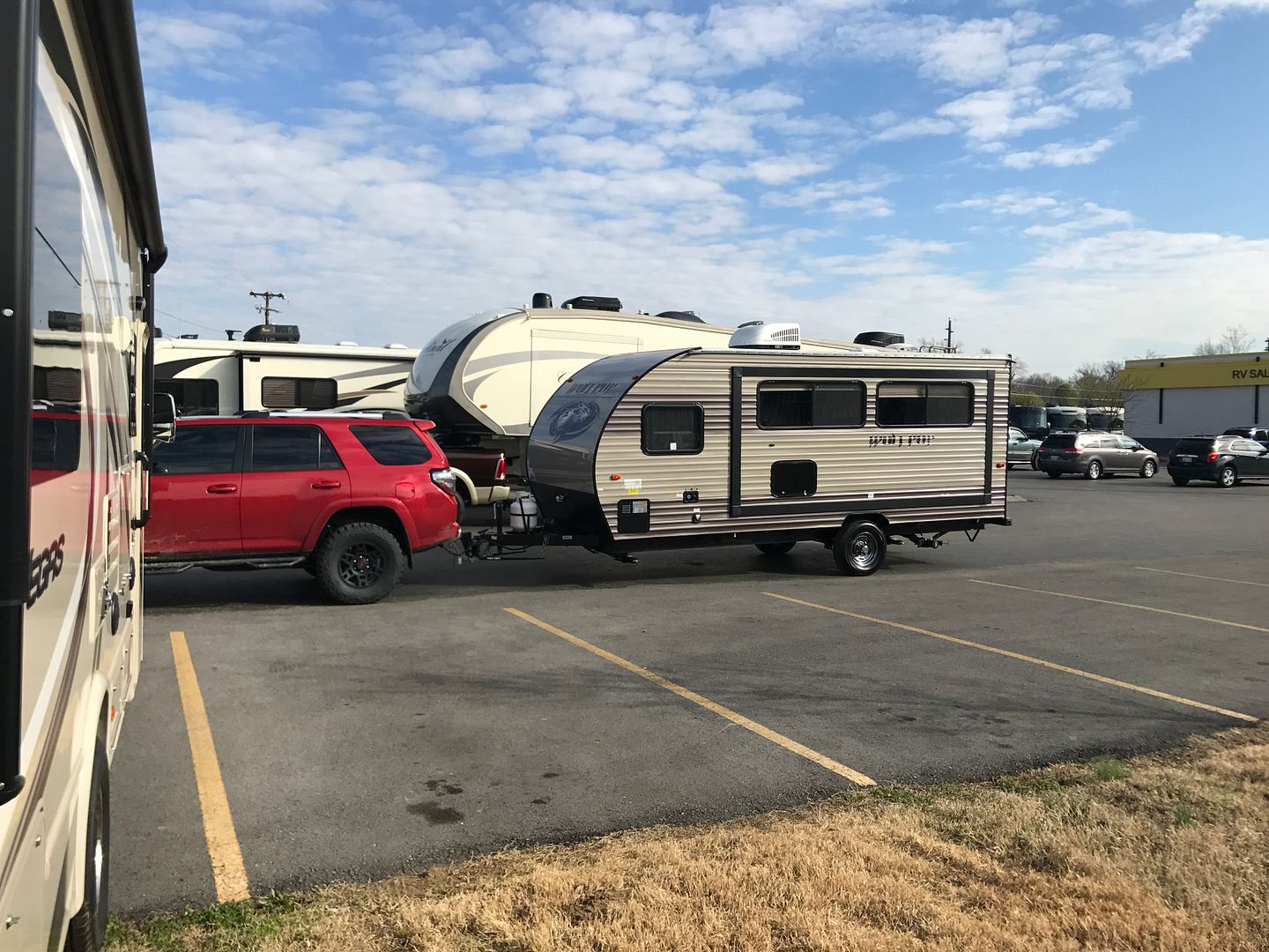

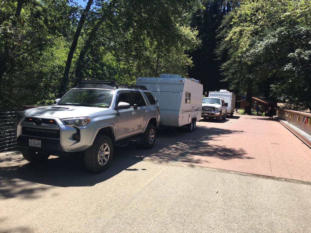

18' camper and just shy of 5000lbs fully loaded. Does well except in high winds. Tandem axle trailer would definitely help that though.
