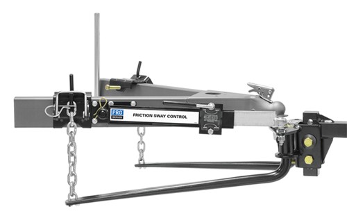

With one of these WDH's you'll be fine. This is what he's talking about kevinpt
CXS...That's exactly what I was talking about. Any recommendations for which manufacturer to go with and if I need a lift?

I can't recommend a brand, mine came with my trailer and I can't recall the brand. I can't run out and look as it's on theother side of town. I've been happy with everything I've gotten from etrailer.com and trust the carry good brands. I don't know if it's true or not but this may be a case of getting what you pay for and not a place I'd skimp to save a couple (or hundred) dollars. I'd suggest trying it alone initially, I doubt you'd need air bags as long as you set the hitch correctly. It's a remarkable bit of engineering that really surprised me by how well it took a lot of weight off the rear.
Edit: Your mention of a nice quiet ride made me want to give you a heads up that the WDH will bang when starting out. Scared the hell out of me the first time it happened. After the initial bang it will be quiet again, I think that's caused by the load bar chains setting in place.
I bought air bags thinking it would make it better... They are off the 4runner now. Adjust your bars correctly and you'll be fine. With the airbags inflated to only 10 psi, the ride became very bouncy with the bars. You need to let them do the work!
