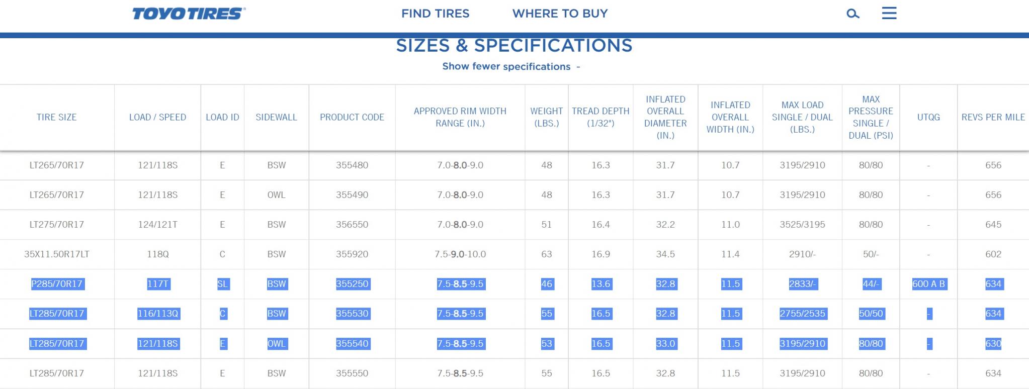

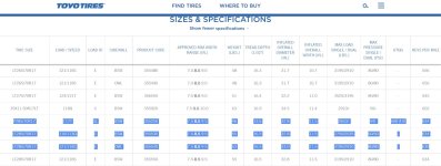

I just put on 285 load C and have nothing but good things to say. I do have one question through: what is the difference between the 285 C load and E load?
Somehow Toyo says the C load is 55 lbs and the E load is 53 lbs? What kind of sorcery is going on here? Wouldn't the higher load range tire weigh more? For KO2s the C load is 51 lbs and the E load is 61 lbs, which makes sense to me.

Aside from a legit typo I’m thinking it’s just got to be a different compound. Stiffer but not as heavy.
Today’s tires are rated in ply - equivalent units so there’s no requirement that it’s thicker. Just that it meets the metrics and ratings.
