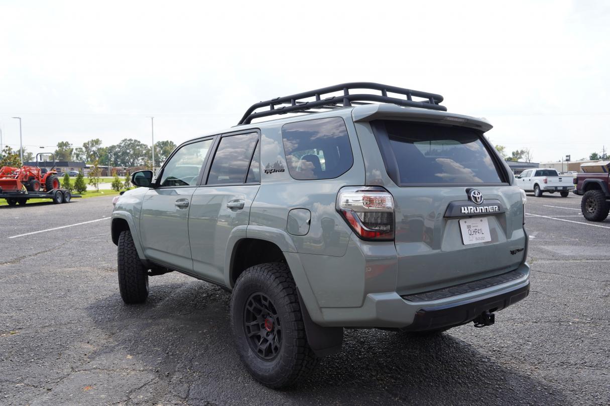

I just had SL 285/70/17 AT3s put on today. No real testing except interstate. They were very quiet. A slight whine at 70 mph (had to listen for it, even the AC fan on 3/4 would drown it out…) but much quieter than my worn out SL 265/70/17 Falken AT3W which had 60k miles on them. (They were a great tire but wanted something different and if memory serves me correct the Toyos are quieter than the AT3W even when I first got them but hard to say…)
I like the look of the tire (Not to aggressive but not too simple either…) and I really liked the weight. Published weight on the tire is 47lbs and I put one on my scale and it was 46.7lbs
I’ll update here as I put more miles on them. Love the look with my lift!!

BlueRidge,
Did you BMC or just trim and push back the inner fender?

Sorry, been away for a few weeks. Lot going on…
The only thing I did was remove the mud flaps. No BMC and no fender liner moving. It doesn’t rub anywhere. I think a more aggressive tire may be closer… I used a heat gun to warp the mud flaps. I haven’t put them back on yet to see if that fixed it.
*Edit: To be clear, I have a lift and aftermarket UCAs. It would be a different story if I didn’t have that for these tires. Caster is around 3.2/3.6 if memory serves me correctly.

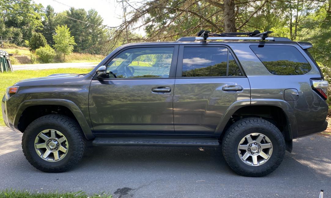

Installed!
Thanks everyone for all the advice in the thread! I recently got the 285/70/17 P Rated AT3 installed with the Westcott Pro Lift Kit. After install, road force balance, and alignment the vehicle actually drives better than stock when I picked it up from the dealership two weeks ago.

I hope you have better luck with them than I have. 22k miles later almost to the wear bars and they are so chopped they sound like an old set of swampers. Alignment is good and I rotate every oil change. I'm going back to BFG's.
What size, load range, and pressure did you run? How many miles do you run between oil changes (aka tire rotate for you)?
SL load 285/70/17 at 35PSI and rotated with every oil change at 5k miles. 23k miles on the tires and they are absolute junk. I've been buying truck tires for over 25 years and these were the worst purchase yet. Of course I started out with Falkens that they wound up buying back because only one of the 3 was actually round.

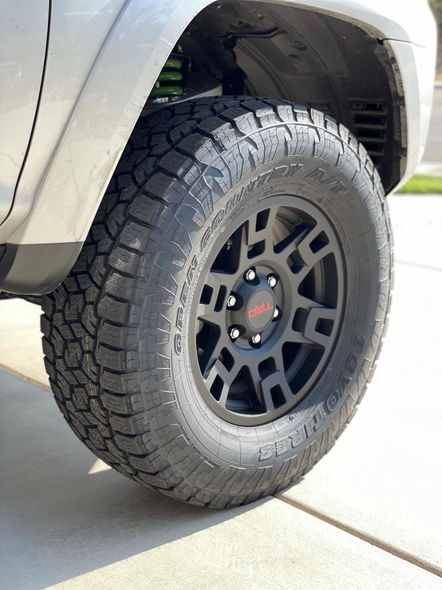

Love them. Have mine on 285/70/17 SL. Able to handle trails with ease.
