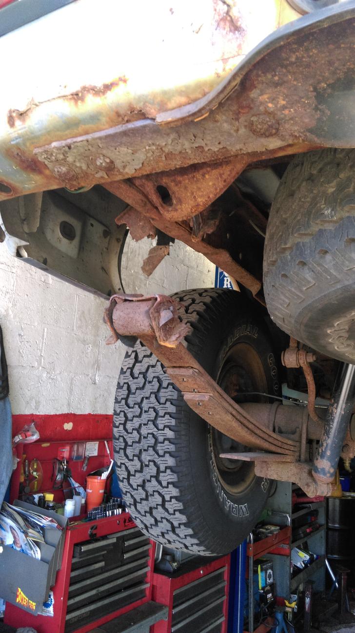

Just to change things up a bit, here is what happens to older Exploders. What you can't see is that the right side forward mount also snapped. To top it off, the lady was told how much the repair would be, and decided to drive the truck like this for 2 months on a 40 mile commute every day over what are really some of the crappiest highways in the country. she finally decided it was time to fix it. My mechanic said it was not the funnest fix.
So, should we all buy these $1000 Exploders and tell Ford to buy them back?

You can weld that back on!

The forward mounts, maybe. But the usual fix is to drill the rivets out(time consuming) and order an aftermarket piece that bolts in place. The issue is when it snaps on the driver side, because the labor involved with dropping the gas tank will quickly exceed the cost of an old Explorer. It's not like there is much of an enthusiast base for these in northern NJ. I actually don't mind these older ones even if they are not 4Runners. I wouldn't mind the 2-door. :hiding:
Oh yeah, notice that spare, I'm pretty sure it's one of the recall Firestones.
