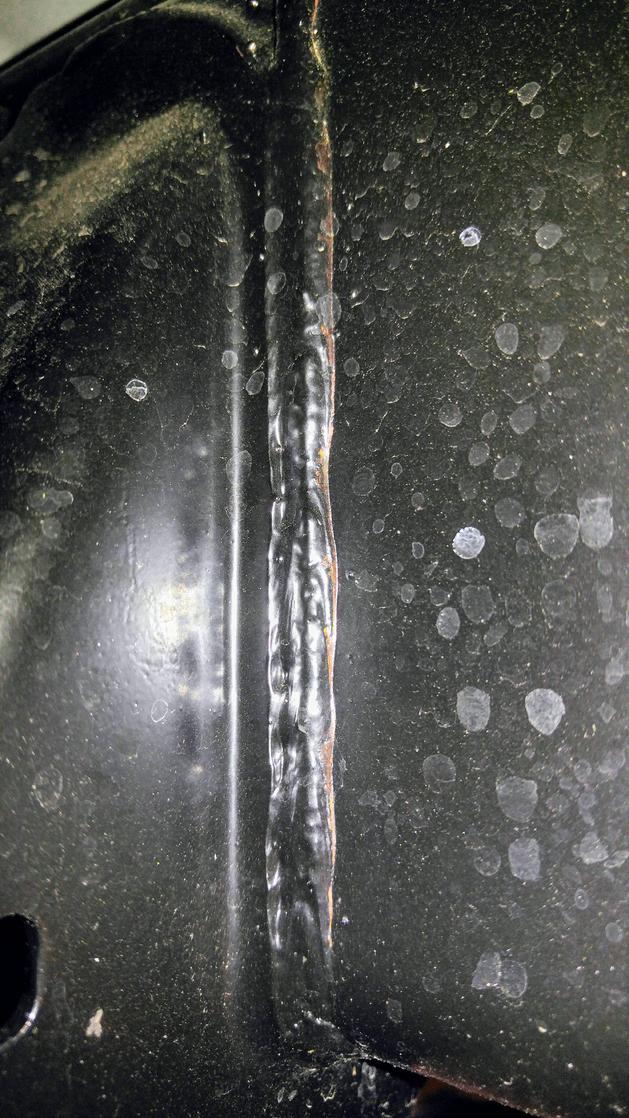

I have a 2018 4runner Off Road Premium w/Kdss
704 miles on the odometer and I have rust at almost every weld on the frame.
almost every weld has a fine line of rust along the bead of the weld.
NOT COOL!
I have spoken with the service manager at my dealer and have an appointment set up for this week so he can inspect and photo..
I really don't expect anything from this other than getting this noted to my vin# so should there be a future problem I can show it started when truck was new.

I think they don't properly clean off the weld residue, that's why it starts there. You'd think they would fix that by now with their reputation. I honestly don't know why they don't dip these things in zinc by now. At least offer it as an option for an extra $1000
POR-15. I've used it a lot on older, US steel, rust buckets. Get the zink on it early and seal the beotch up proper like. I'll be treating my new (to muah), near flawless 1st gen. Ill take all of the trim off, clean up the frame and associated parts, treat liberally with their zink oxide and sealer. You can also add zink plates like they do to coastal bridges, boats etc. The sealer will constrict a bit when curing but once on...:first: it is indestructible.
Oxidation is a chemical/electrical process... disrupt that and you are good-to-go... even with exposed metal

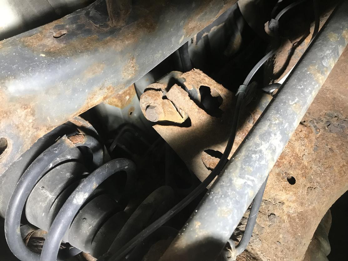

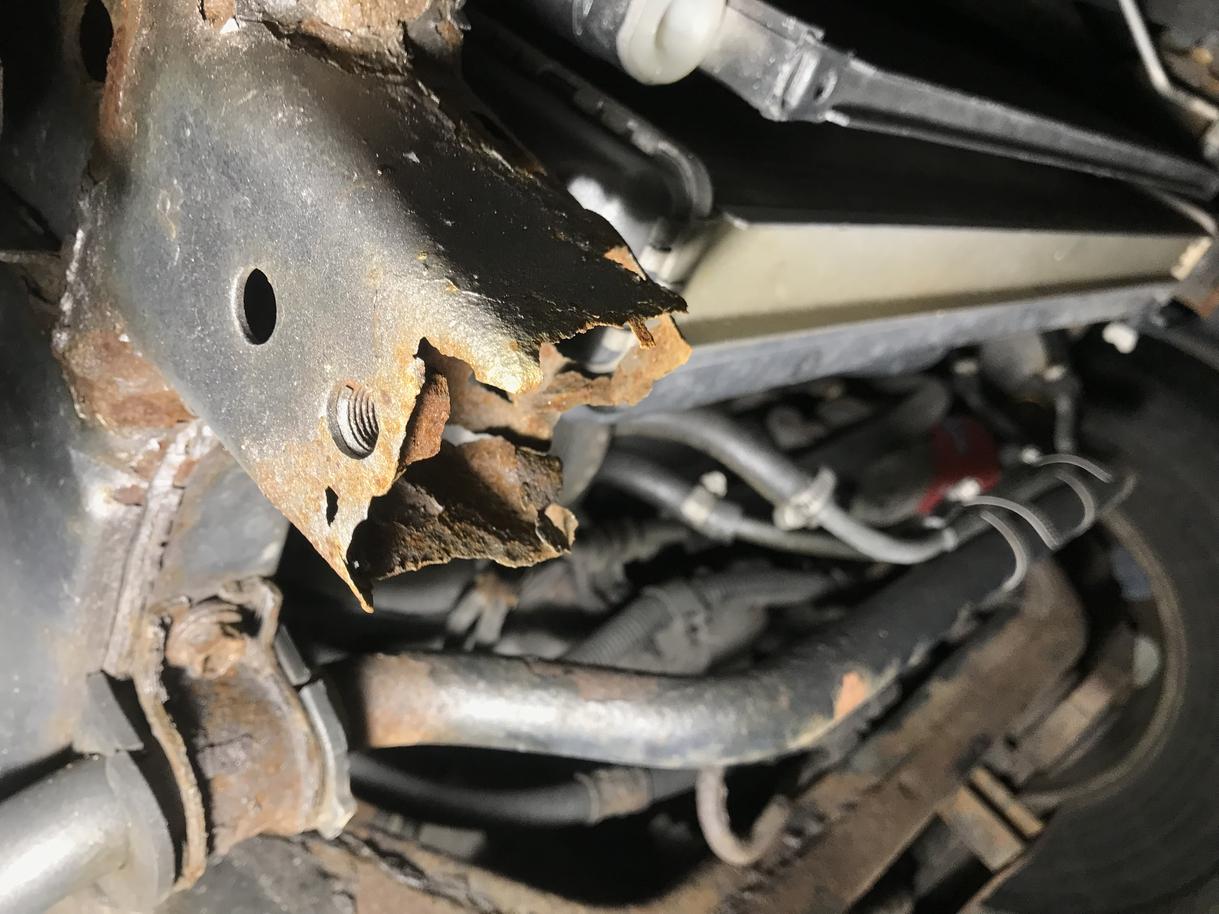

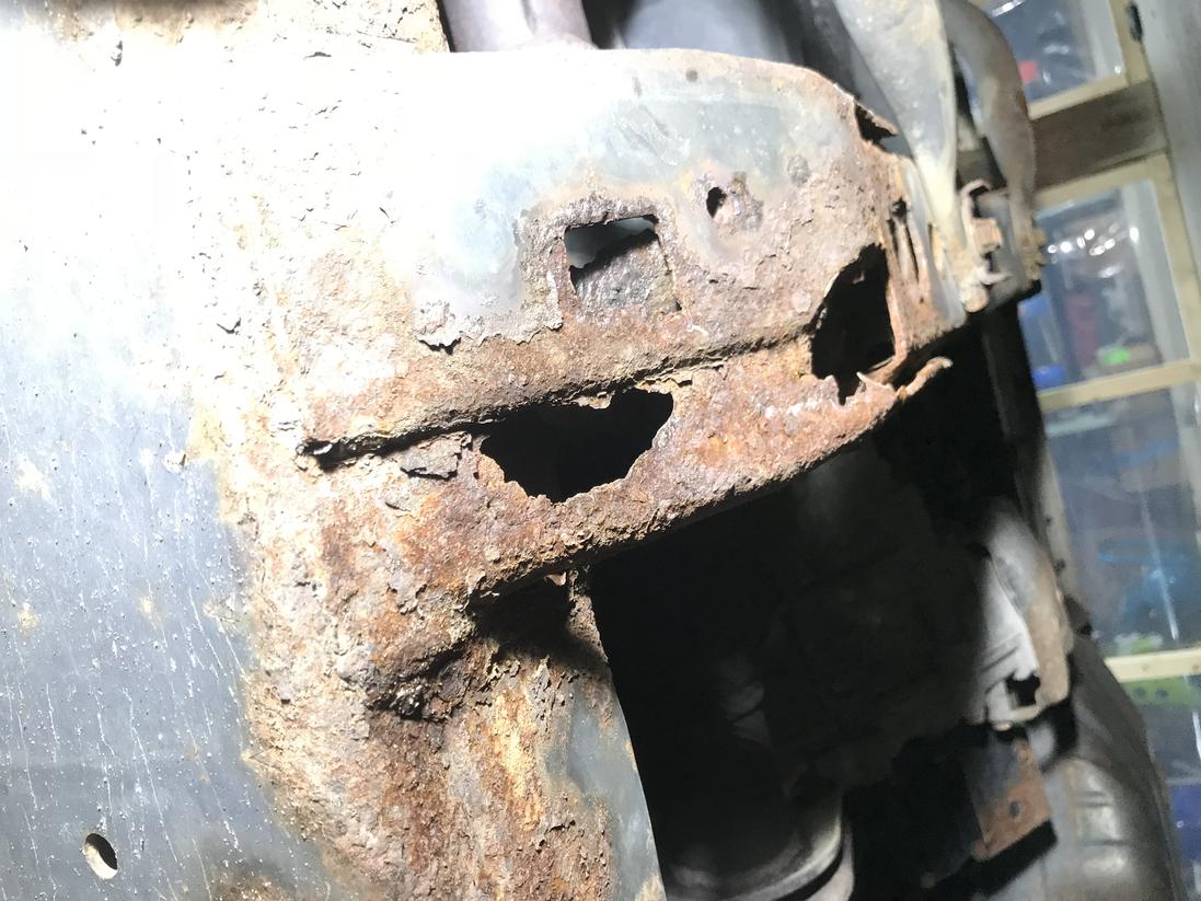

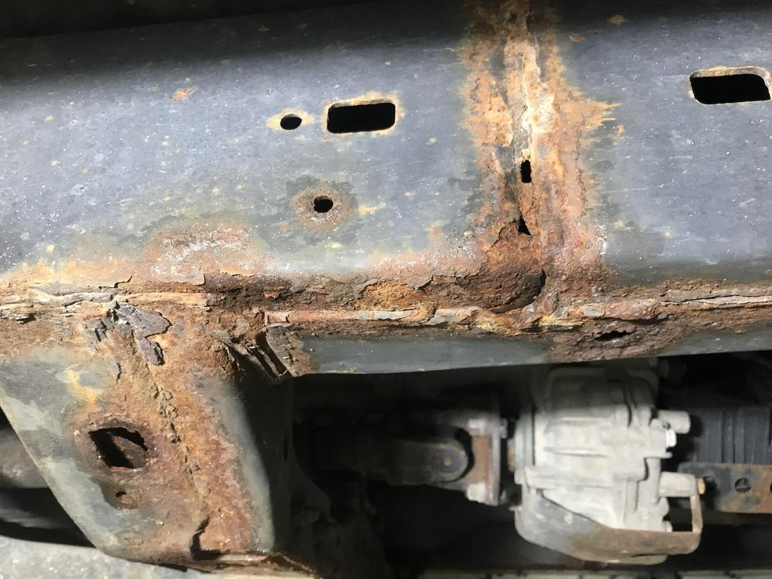

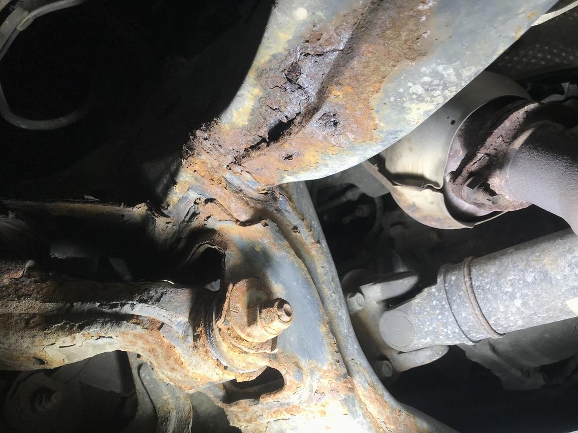

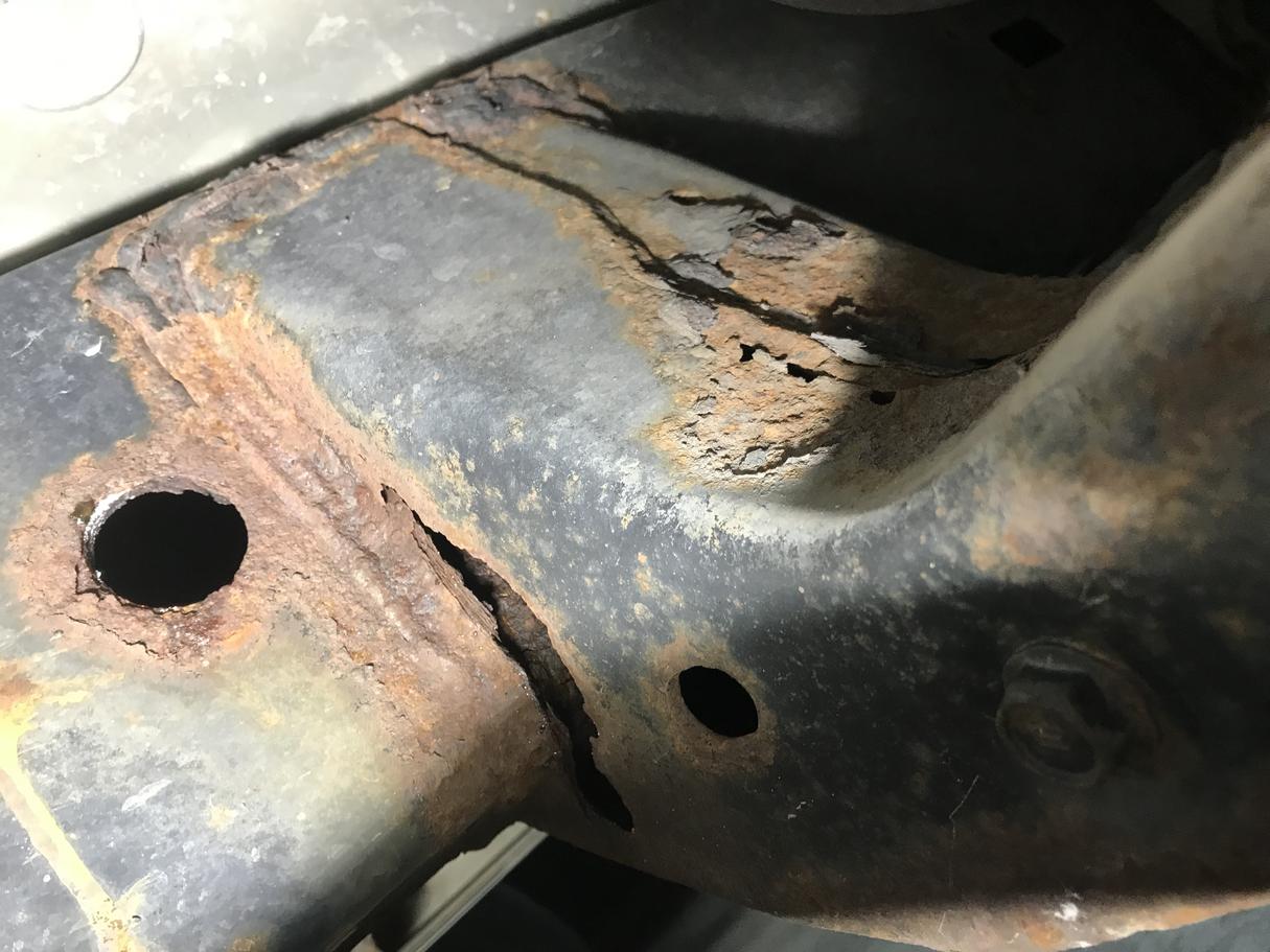

I’m new to the forum, bought a 2003 4RUNNER on an impulse buy. Later found the typical rusty frame issues. Filed my complaint with NHTSA.
As stated by the OP, I encourage others to file!

Useless effort. Not to be a jerk but the first thing I do when looking at Any vehicle is get on my knees and look under it's skirt.
I couldn't bear to look very long at those pics, hope it's not done for. Best of luck. :cowboy:
that one is done for.
I agree. Time to search for a frame donor from the WEST. The '98 I just bought spent most of its life in New Mexico and found it's way to CO a couple years ago. The frame has zero cancerous rust. Same with my '97, except it remained a CO native.
