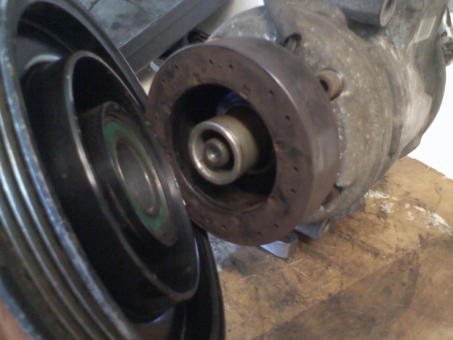

1st picture: You can press out the bearing to replace the new.
Idler bearing number 6301 Nachi/NTN

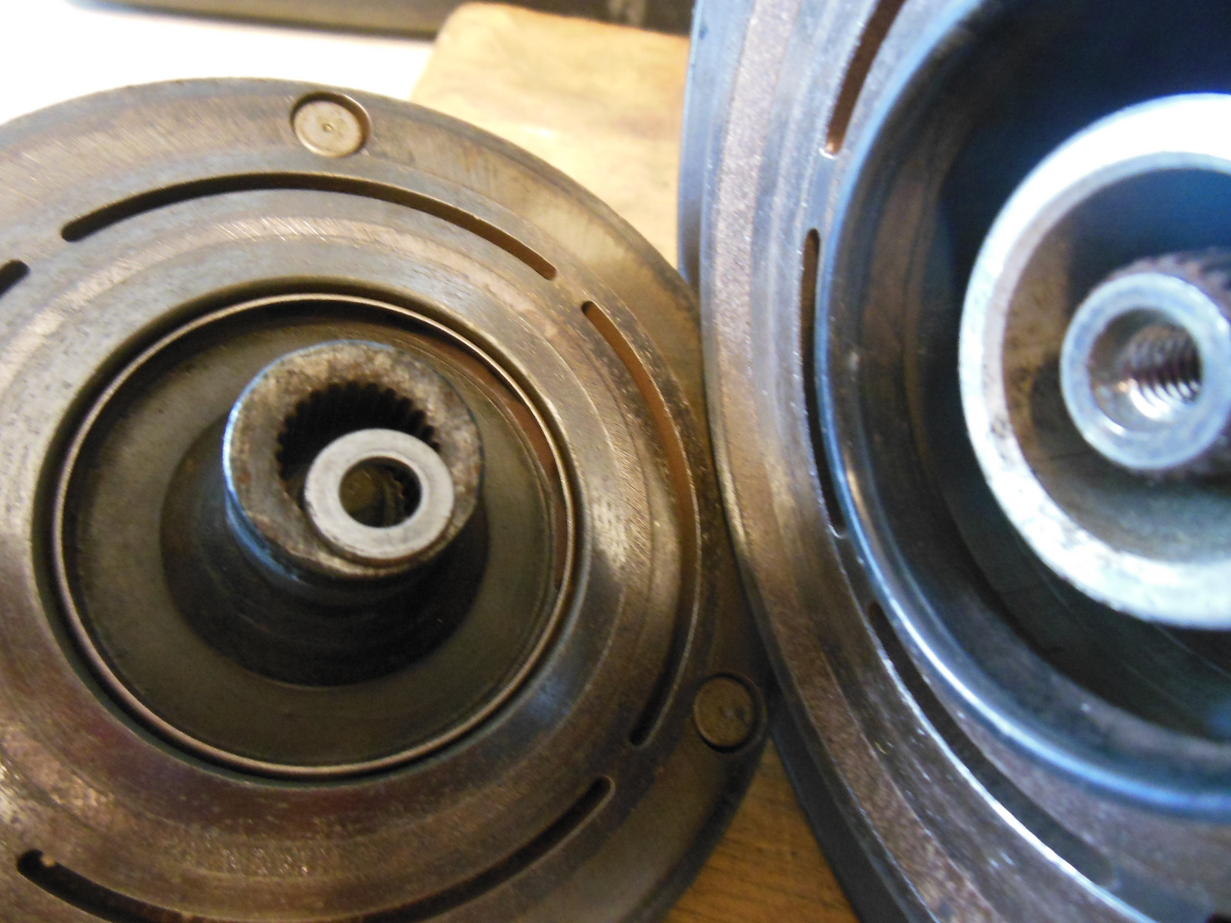

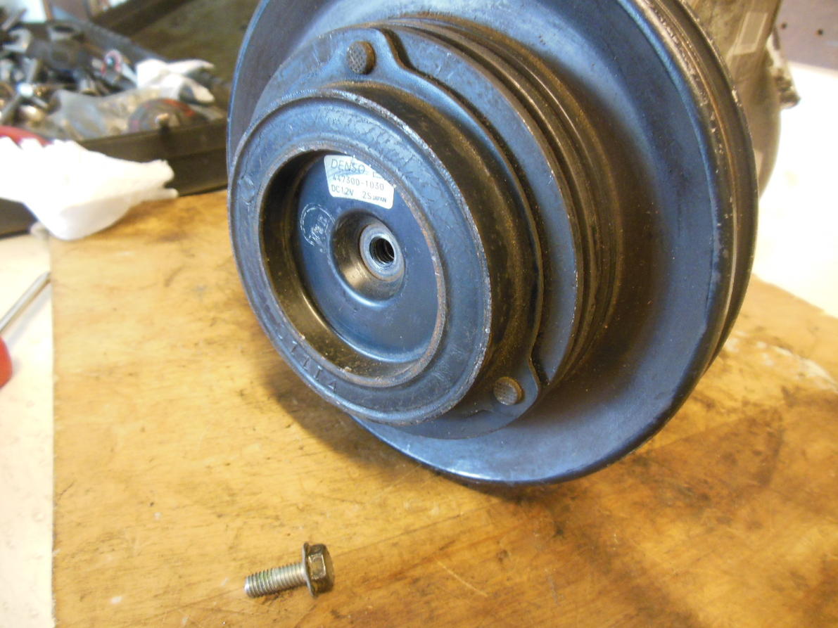

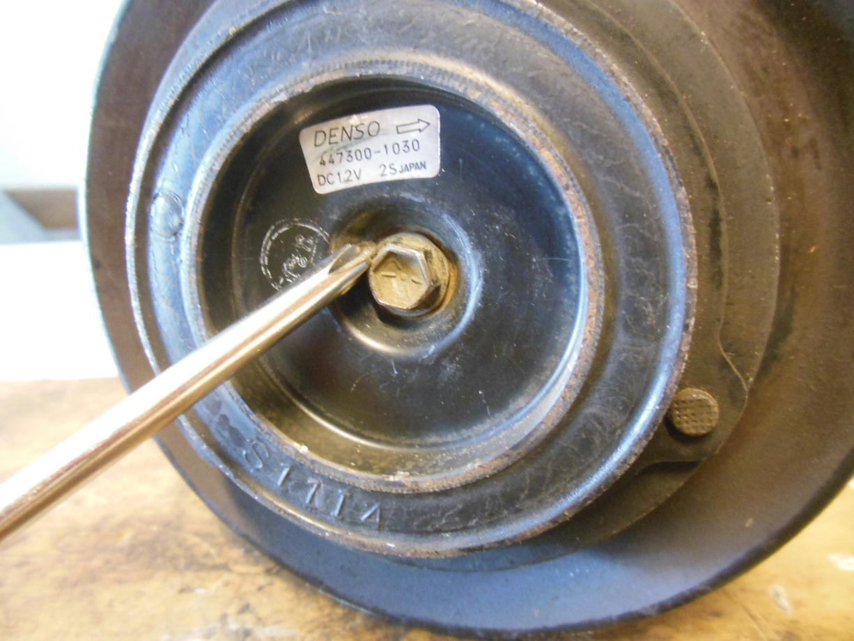

2nd picture: Remove the 10 mm bolt: impact gun is the best: It will spin just like how the crank bolt spins so be ready to hold the clutch. [HINT: BEFORE you remove the belt, have the ignition ON (engine NOT running), turn the ac on to engage the compressor clutch and then remove the 10 mm bolt)
3rd picture: 10 mm Bolt off

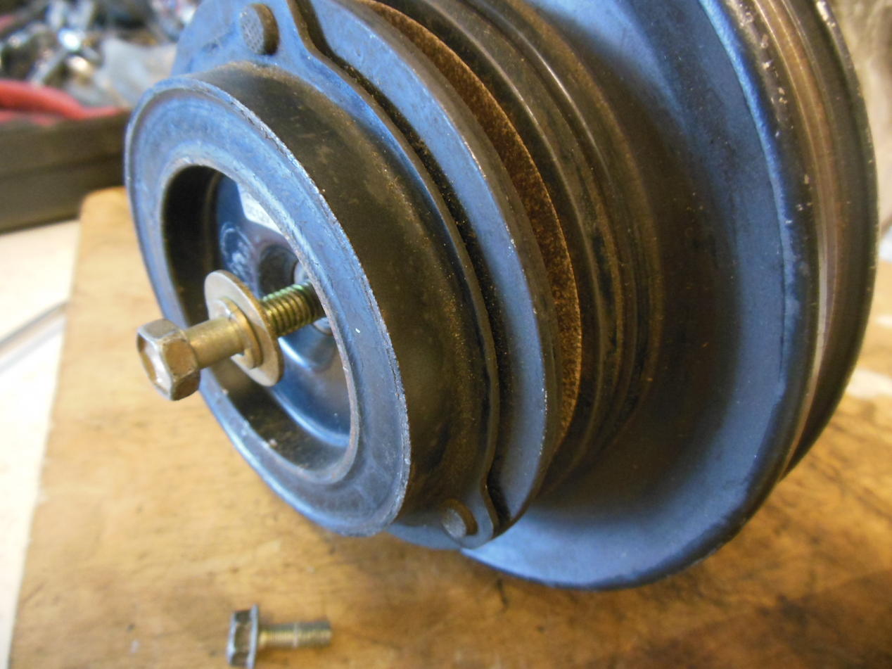

4 Picture: Using a 12 mm bolt to puller the clutch from the compressor: IMPORTANT: There is a 1.5 mm thick washer and keep an eye on where it goes.

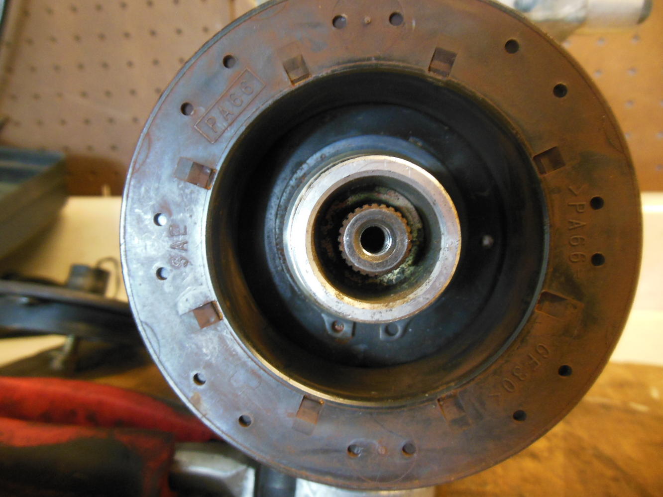

5 Picture: clutch removed
6 Picture: 1.5 mm washer shown

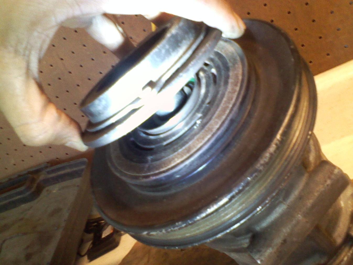

7 Picture: Lock click removed
8 Picture: Pulley pulled out. It should come right out with gentle pull.

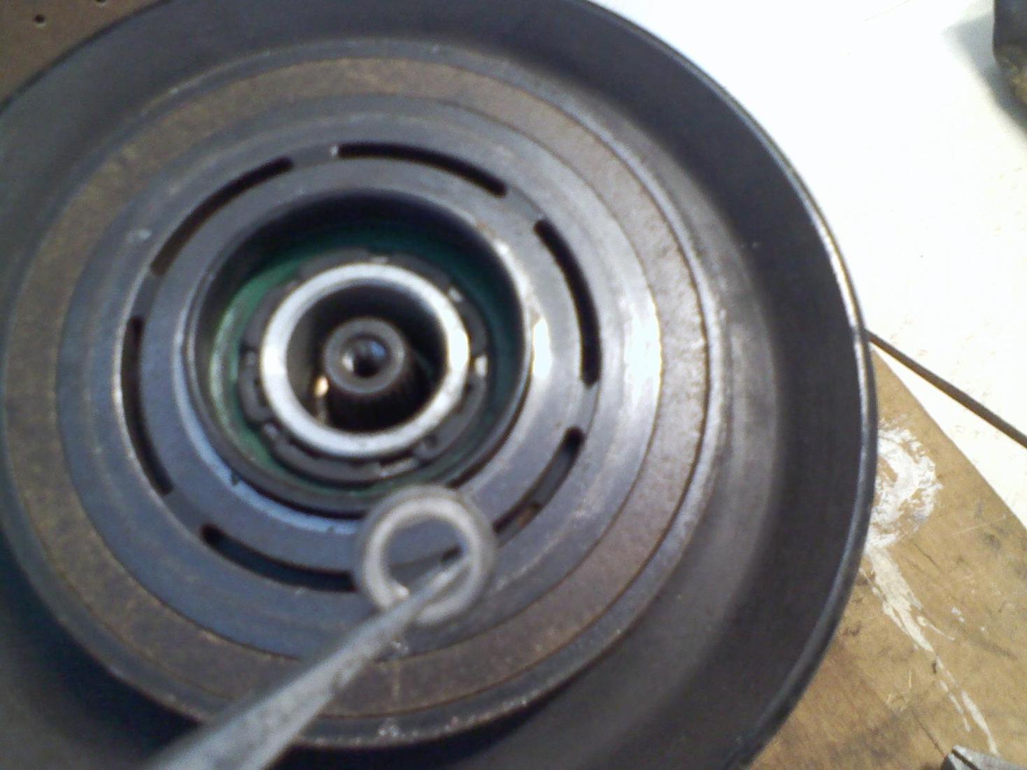

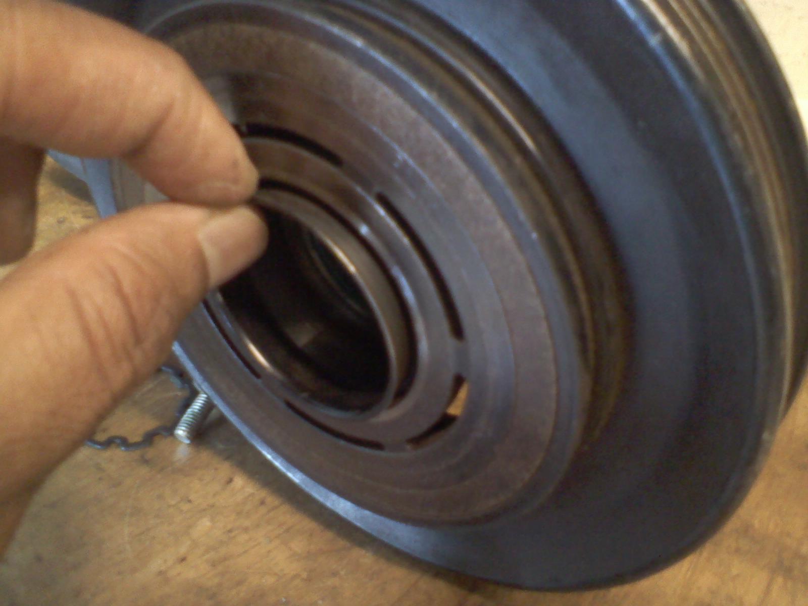

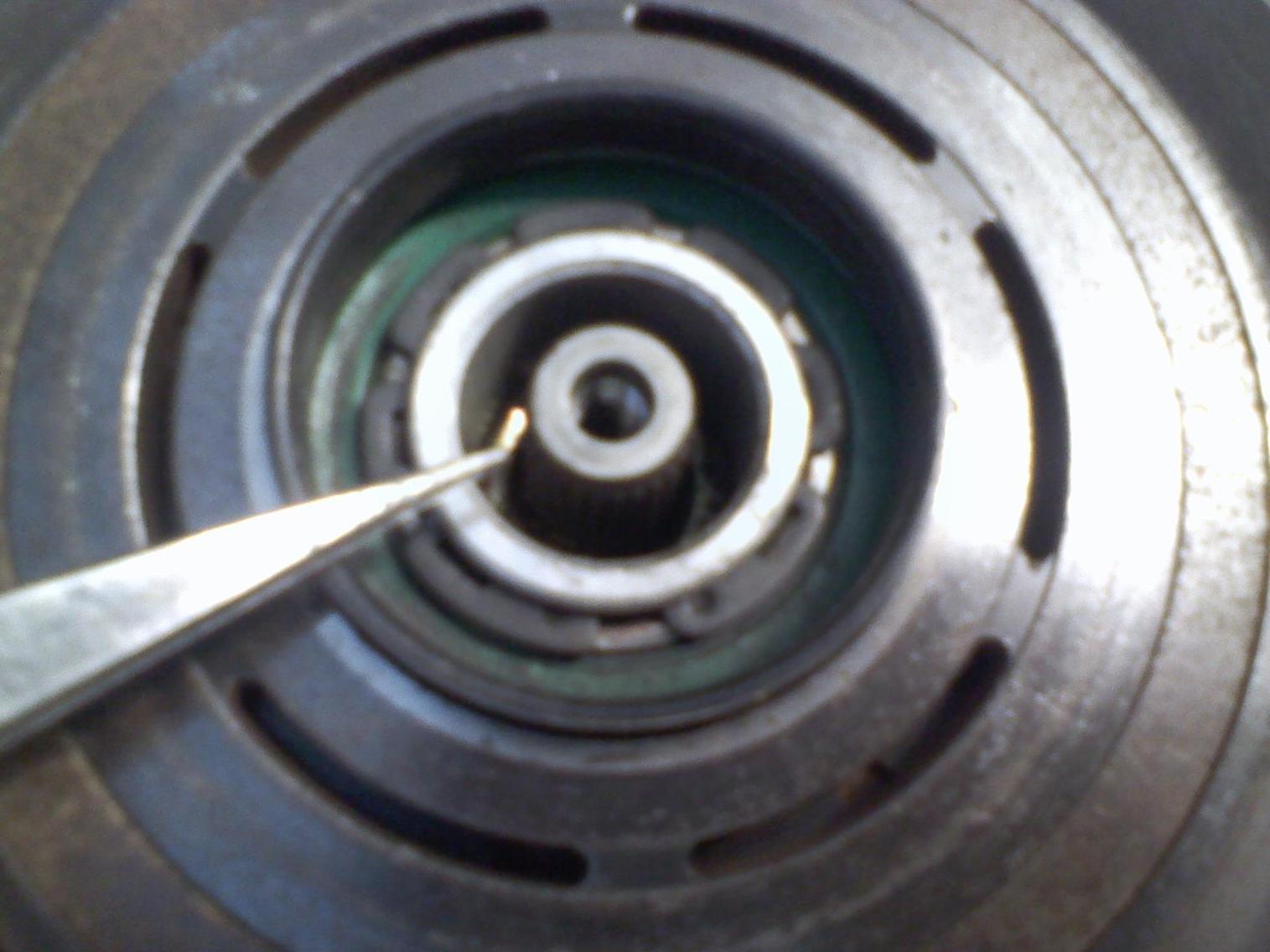

If you want to remove the clutch coil pack, remove the circlip
shown inside and then remove the wires attached to the coil pack

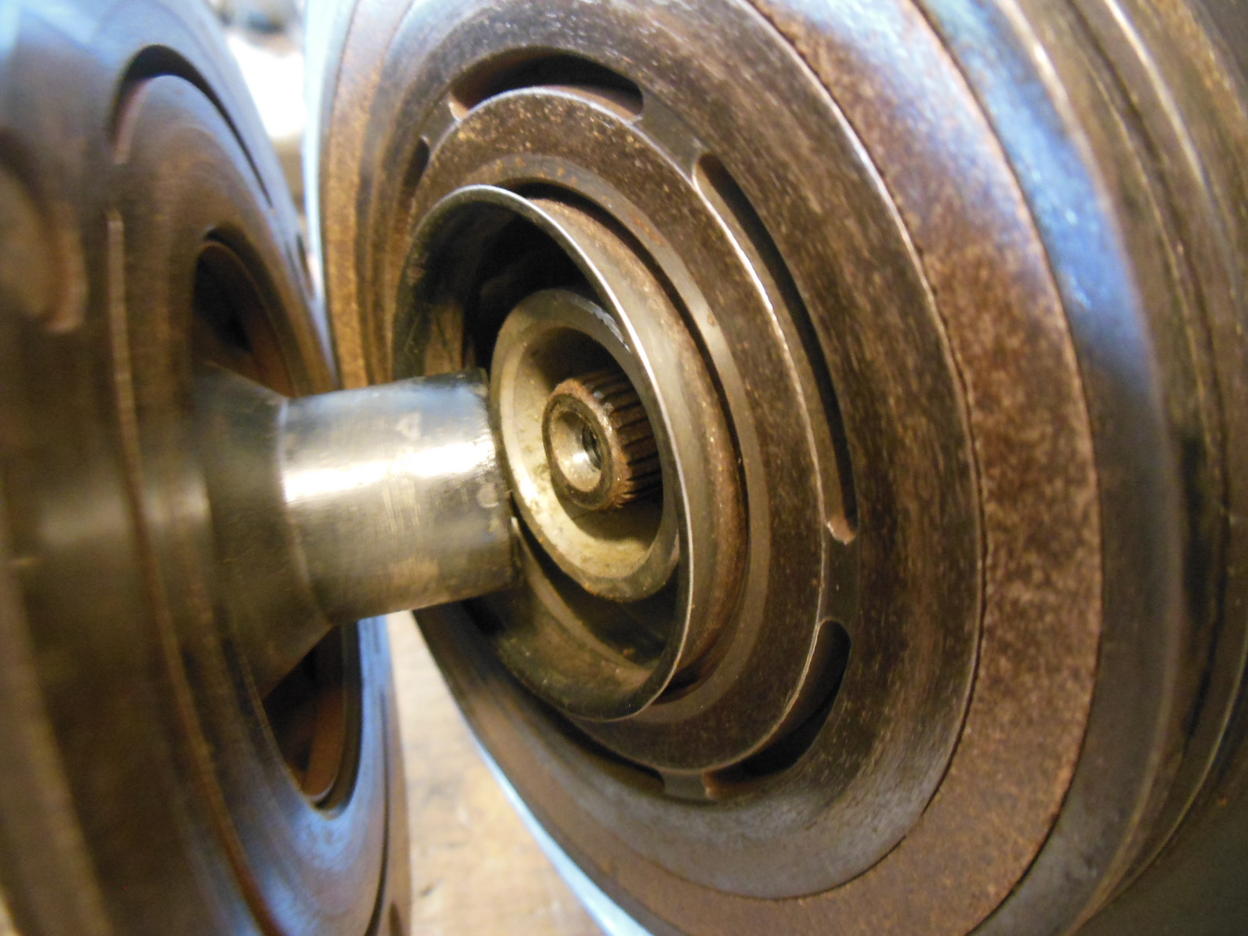

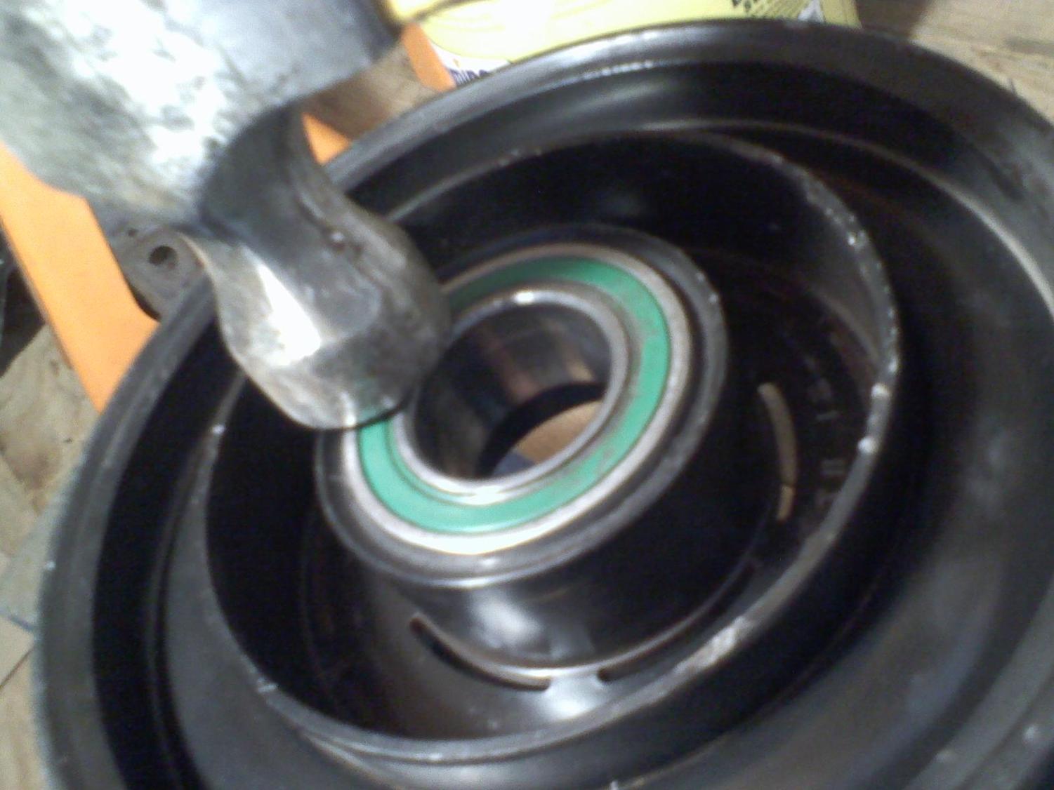

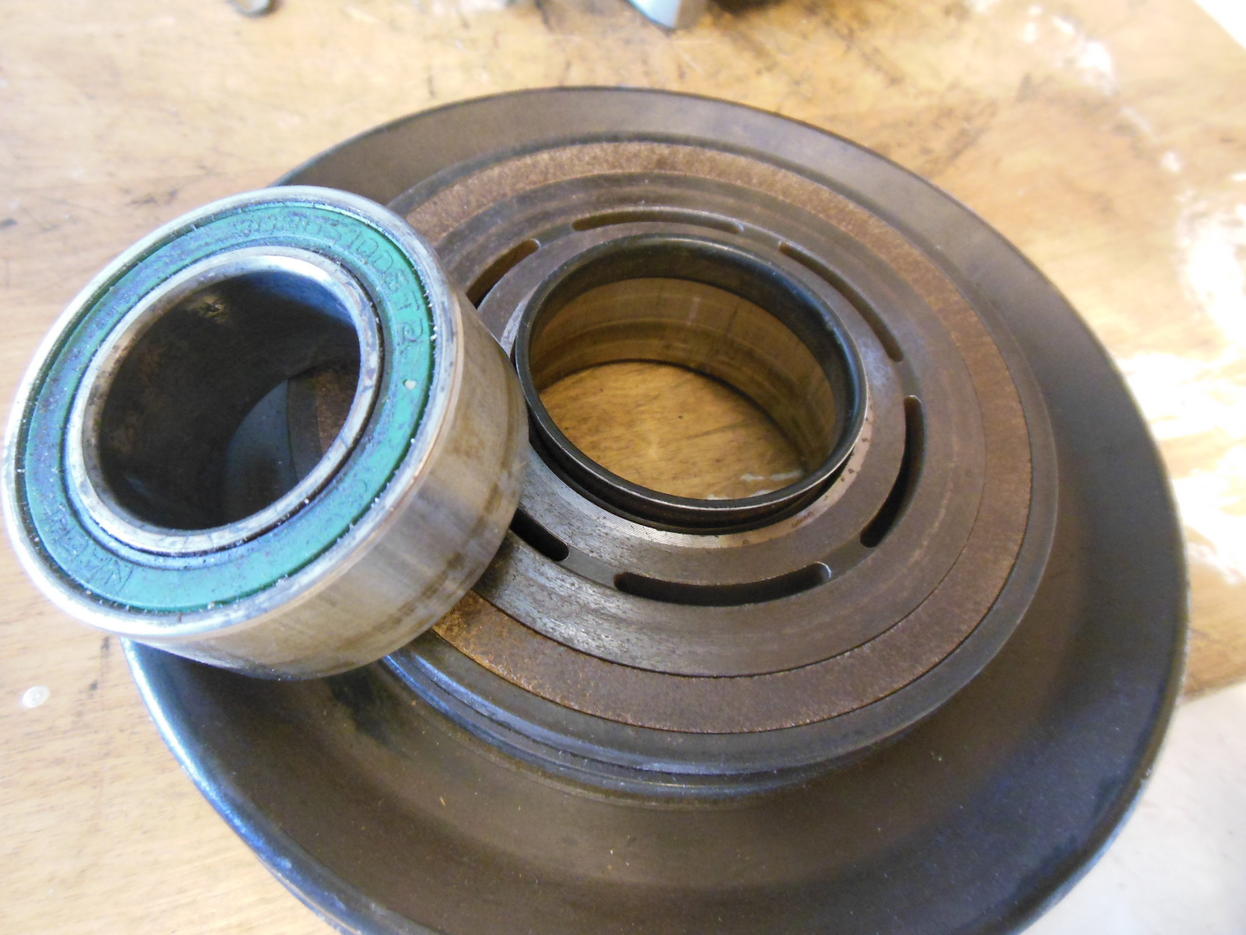

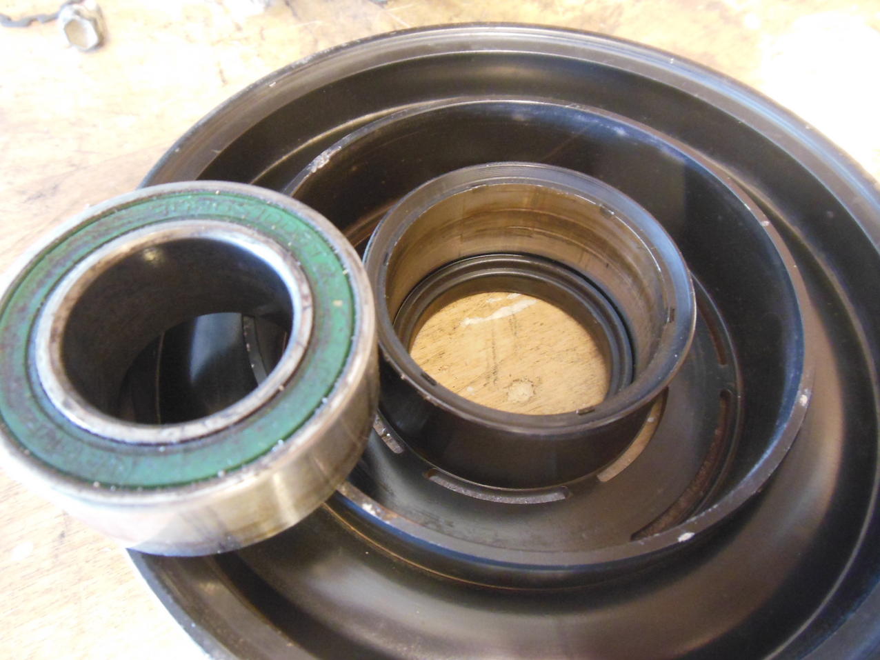

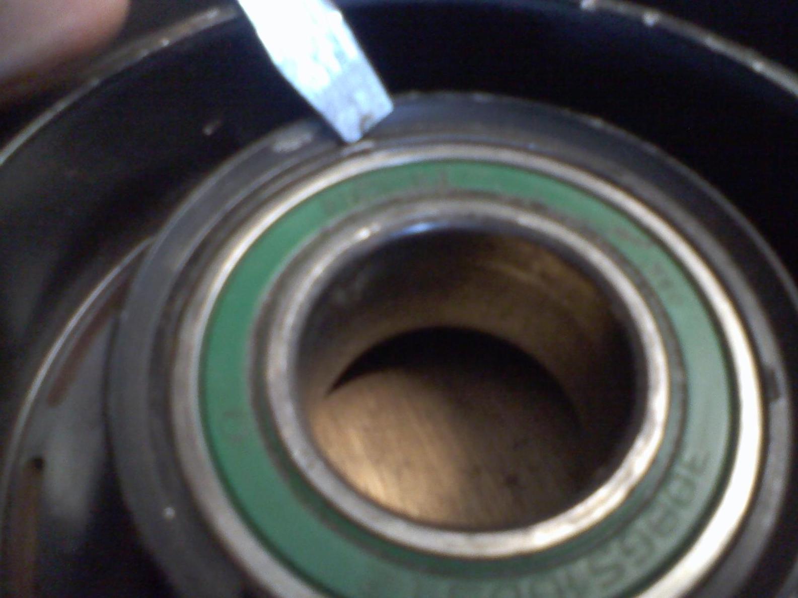

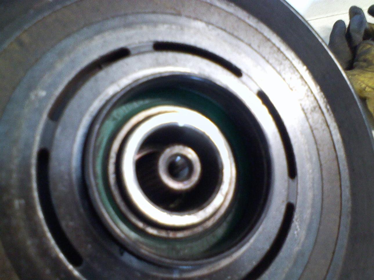

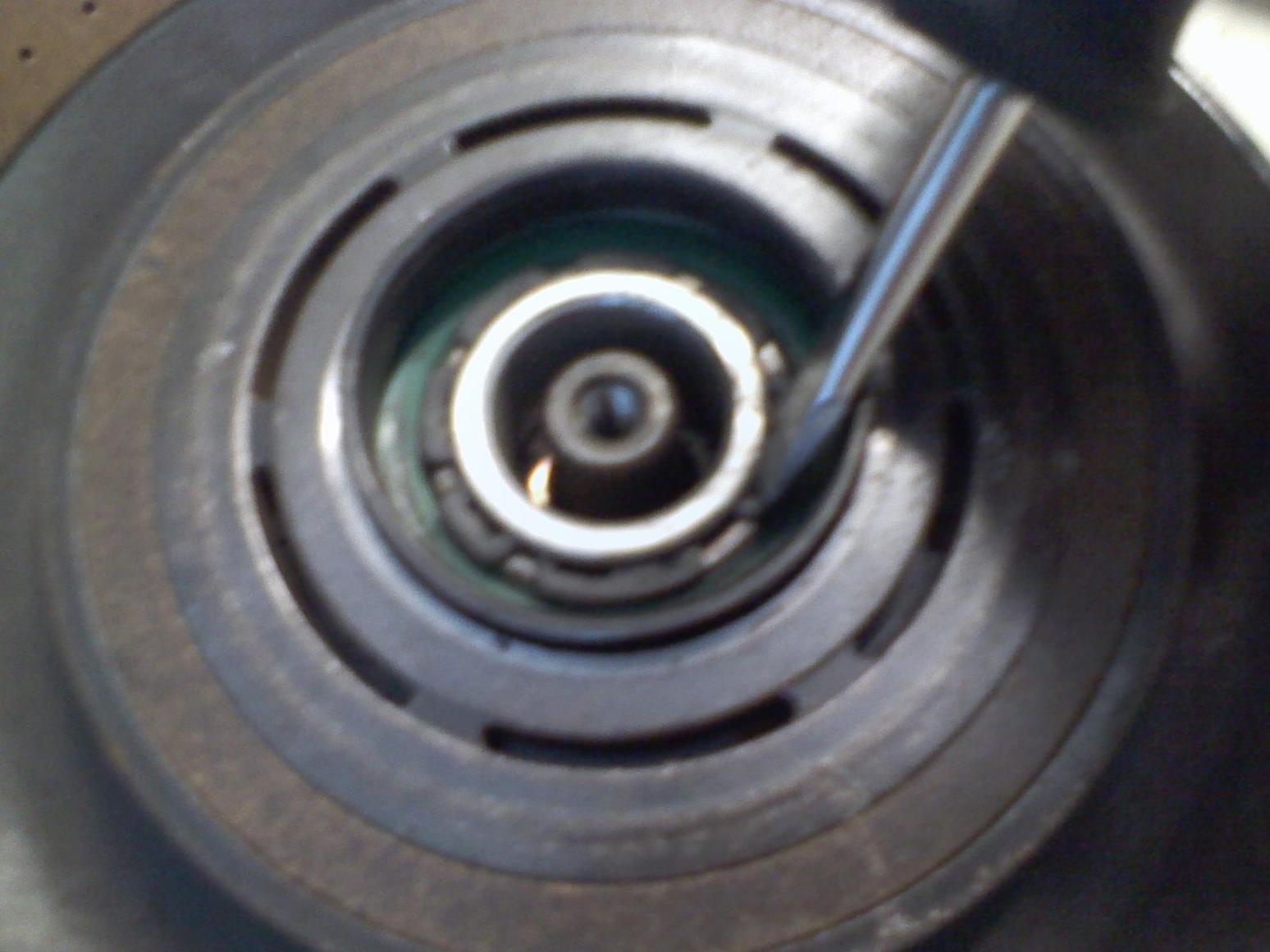

9 picture: Compressor pulley bearing pulled out: Note the dust shield collar. It will fall out with the bearing (not a tight fit). Reuse it with the new bearing
10: Picture: other side of the pulley
11 Picture: dust shield back in
12 picture: Bearing installed
Use a wise to drive the bearing's last few mm's (prevent damaging the dust shield)

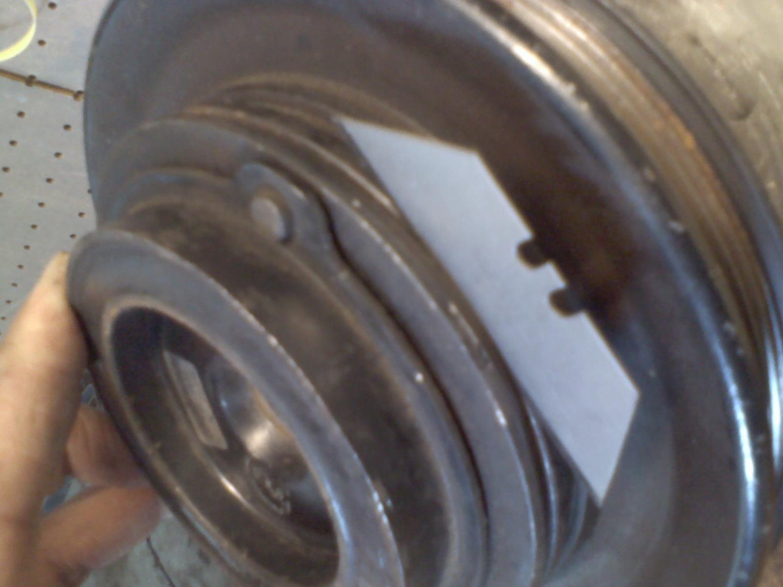

13 Picture: Bend the tabs to secure the bearing
14 Picture: Pulley ready to install

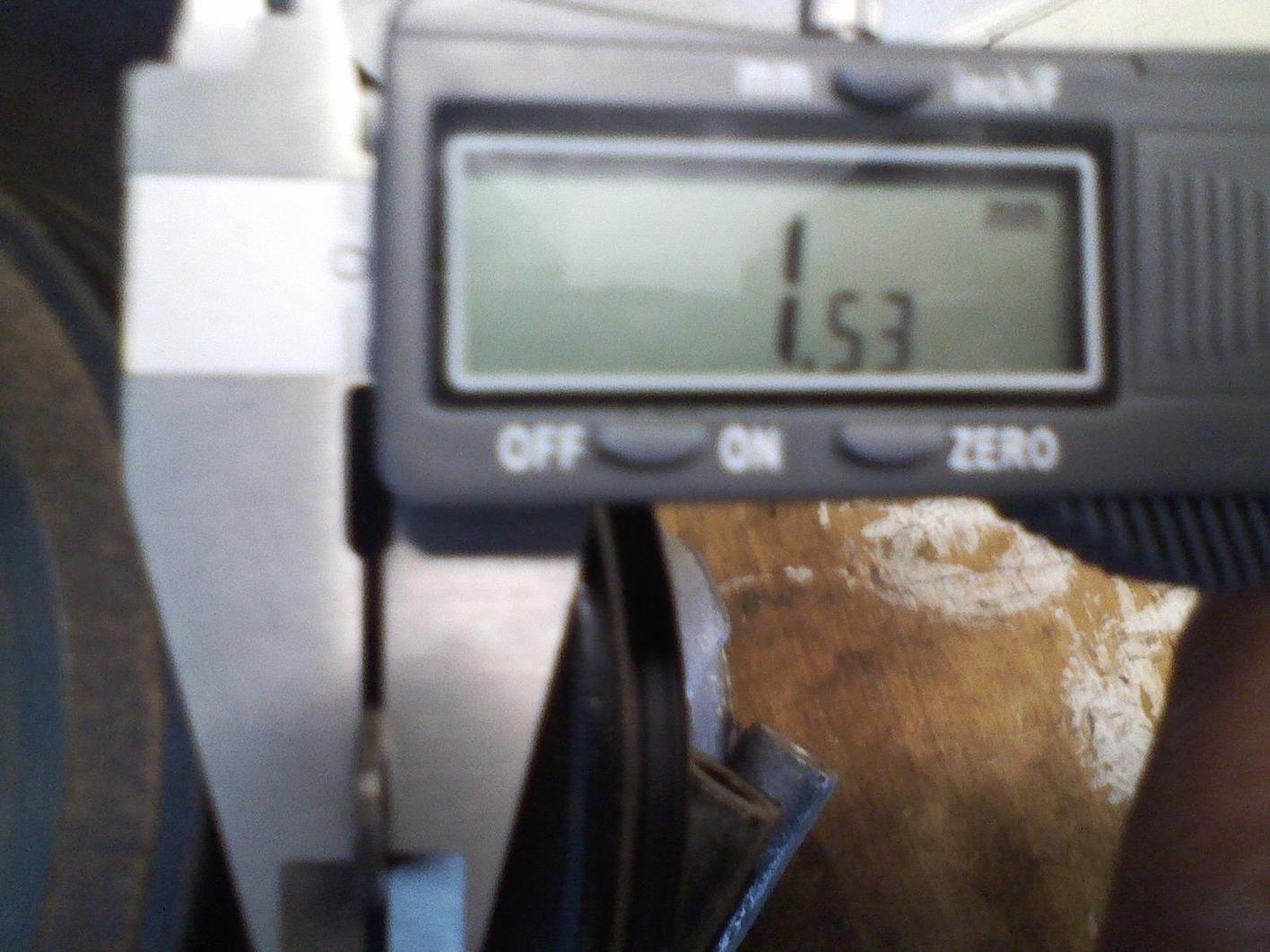

17 Picture: Thickness of the washer that goes between the clutch and the pulley
18 Picture: Washer

I took the pump off, and secured it between two 2x4's to get the pulley off-
Then I had to get the bearing out of the pulley- also not easy. Started out by tapping the "stakes" out of the way-
Then getting the bearing out-
Bearings-
It's easy from there [emoji1598]
Hey guys, I'm going to try to replace this bearing soon. Trying to get my brain around how this stuff comes apart. I see the first step is to remove the small bolt. How does the longer bolt help pull the front of the pulley off?
[MENTION=148218]JZiggy[/MENTION], the pulley is threaded with a larger(8mm vs 6mm) bolt hole. When you thread the larger bolt in, it presses against the 1.5mm washer, and acts as a puller to pull it off. It works really slick!
Thanks for the fast response! Makes perfect sense now.

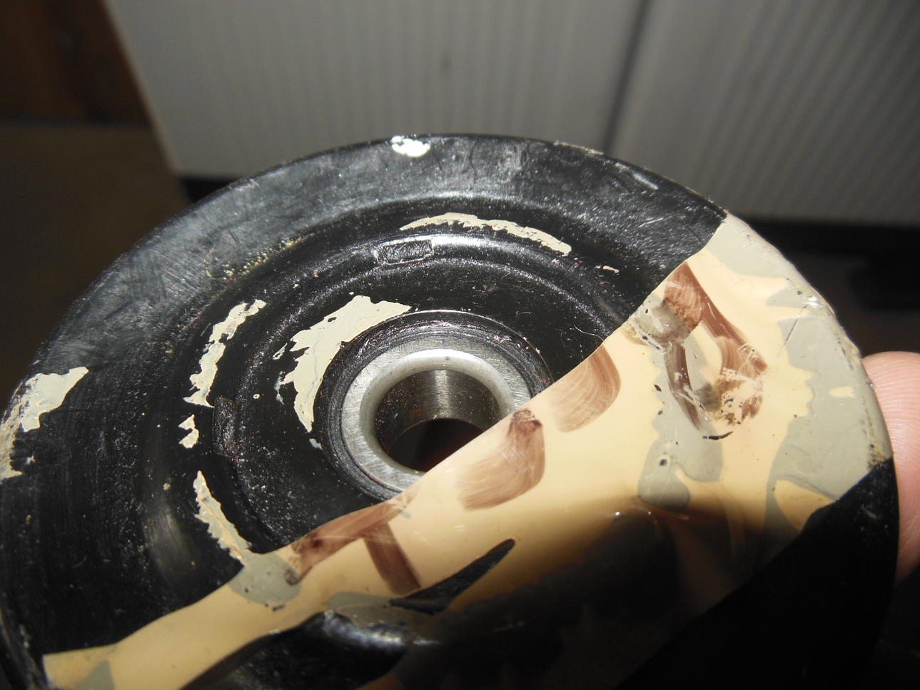

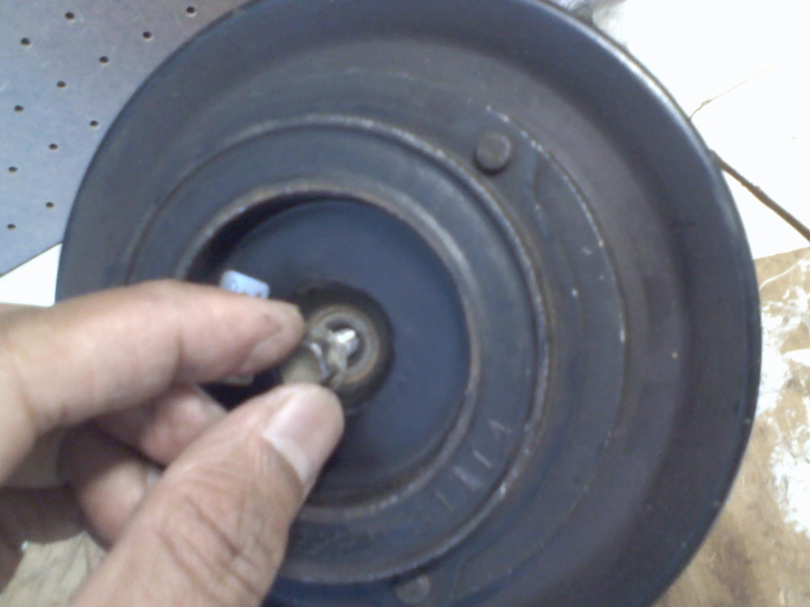

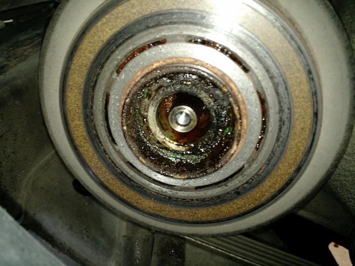

This thread motivated me to try and remove my AC pulley after giving up on removing the 10mm bolt last time. Got the bolt removed in 2 seconds today after a "light bulb" moment. Then I tried for a good hour to pry off the magnetic clutch. After giving up, I noticed something that killed all my motivation for the foreseeable future.
Sent from my SM-G930T using Tapatalk
Wow!
Look what I found:

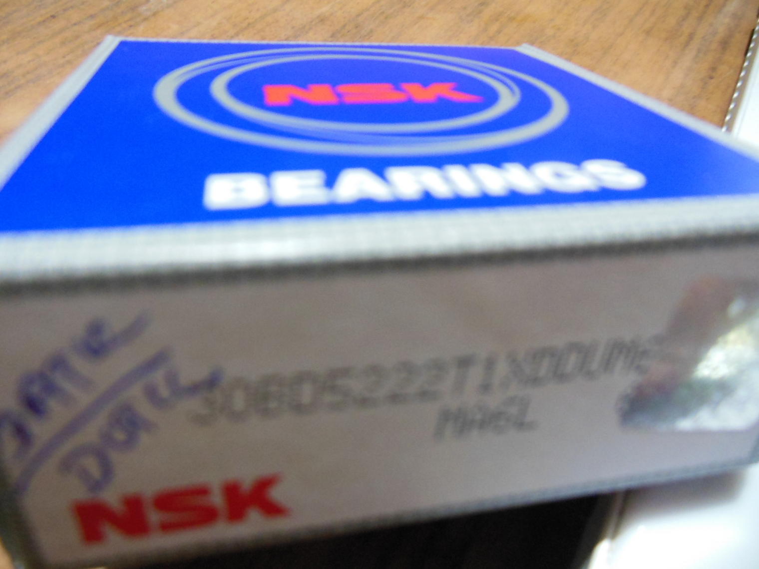

I am in Sri Lanka visiting my parents at the moment, also messing with their Diesel Hilux 4x4. A local autoparts store is selling NSK bearing (made in Japan) for this AC compressor application for just $ 8.27!
Attached is the picture: 30BD5222T1XDDUM6 is the number it has and the dimensions are
Inner X Outer X Thickness: 30 X 52 X 22 mm

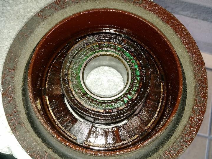

I was able to do this repair without removing the compressor. My 4runner was originally from Massachusetts so I expected to wrestle with it a bit...surprisingly, I had this whole job completed in 3ish hours. Luck of the draw with these things I suppose??? Removed the fan clutch, bottom skid plates, and unbolted the fan shroud for some extra room to work. Everything removed easily without special tools (aside from a set of snap-ring pliers). Got the bearing off amazon for $16 delivered. My old one was in pretty bad shape, purrs so quietly now. A few pics of the bearing but I followed the procedures from previous posts and diagrams from the service manual.

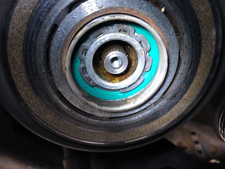

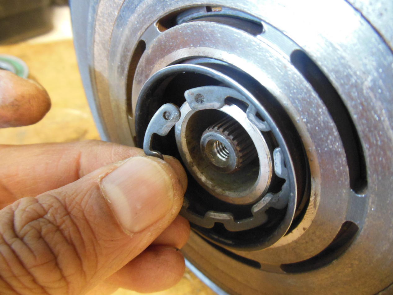

I should note the hardest part for me was the snap ring. I spent a lot of time aligning my pliers to the correct location. I had to use my cell phone's camera to find the alignment holes. I snapped off the prong on one of my attachments with misalignment of the pliers. If you leave the compressor in the vehicle you just don't have the angle needed to see the snap ring.
I still haven't been able to remove mine. The snap ring pliers I bought are too long to fit between the compressor and the radiator. Unfortunately the amount of time I can devote to this project has been less than desirable. I end up working a little at a time on it. The outer pulley was such a nightmare because someone welded it to the clutch. Anyway, I think I will elect to cut an inch or so off of my plier handles so they fit better.

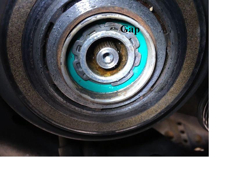

I see the snap ring didn't go into the groove completely. Please see the gap at the open-end of the snap ring in one of my pictures posted above.
"Topher7"
Try one of the two.
1) Try to flip the snap ring and see that makes it to go into the groove completely.
2) You need to drive in the bearing/pulley more into the compressor housing.
Thanks for the heads up. The posted photo was one of a few I used to ensure the snap ring was seated properly. Had to tap the front of the pulley with a mallet to seat it all the way. I didn't get a final photo of it completely seated. I was happy to have your photo to compare. Thanks!
