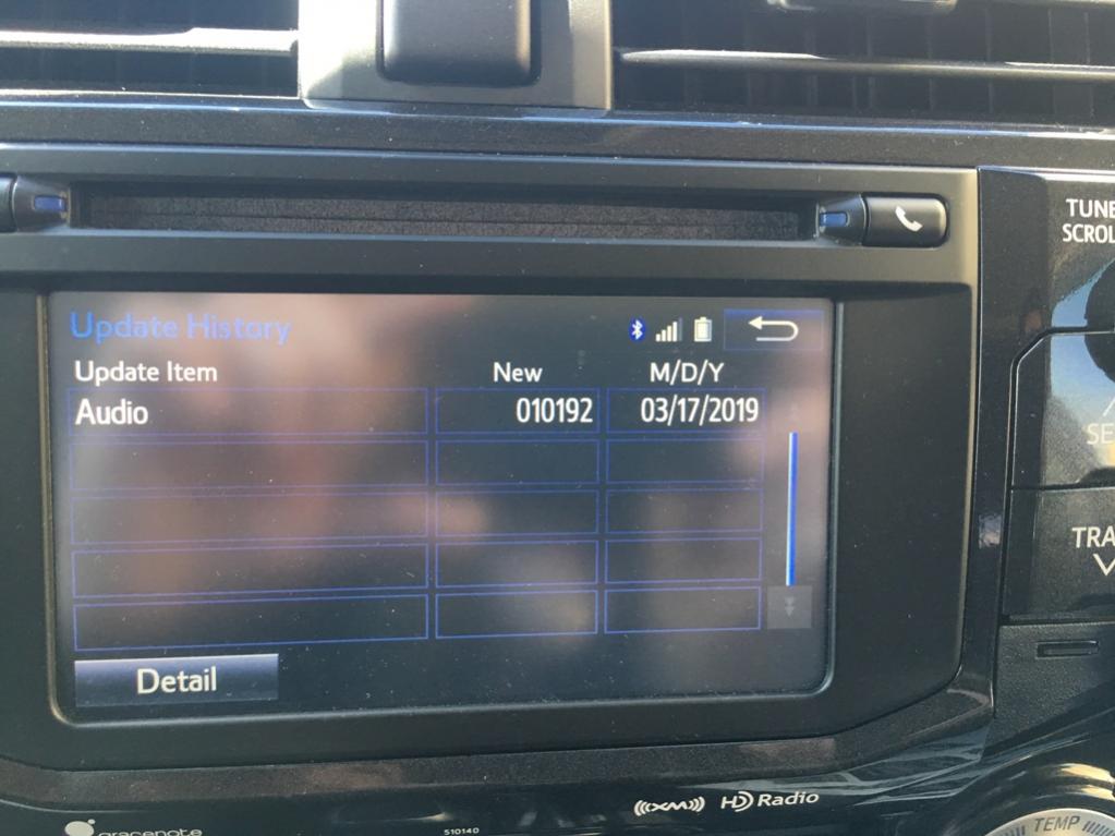

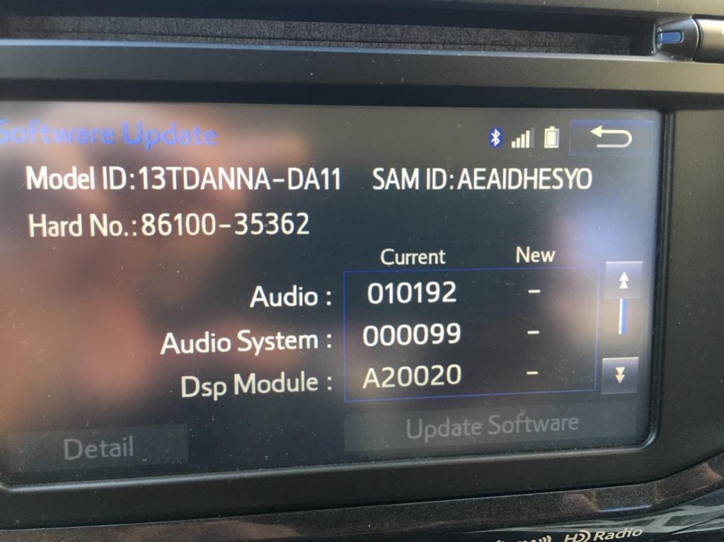

Hi, i just updated my navi software and just wanted to see if you guys have same current version.
Thanks
