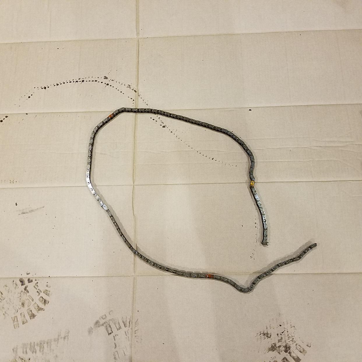

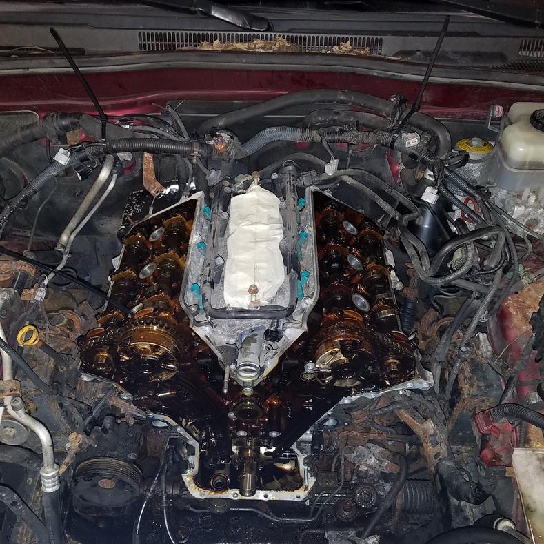

Yeah I've seen what happens when they're mixed, not pretty. Just torn my engine down tonight for a top end rebuild. No idea if the water pump has ever been replaced but the backing plate and pump look like they're brand new, not a spot on them, no noise, pump has zero wobble, very impressed at 250K miles.
