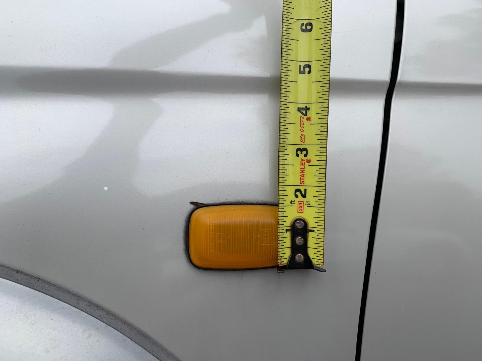

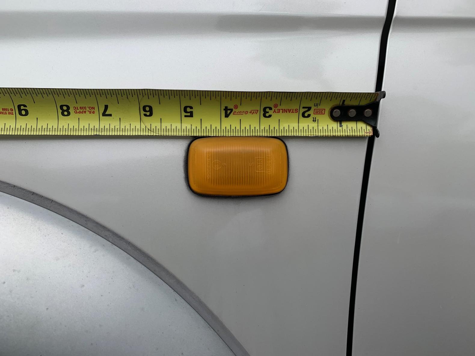

I was curious if anyone had the factory location measurements so I could get it to the factory spot? Also - any photo of the factory mounting hole would be appreciated -

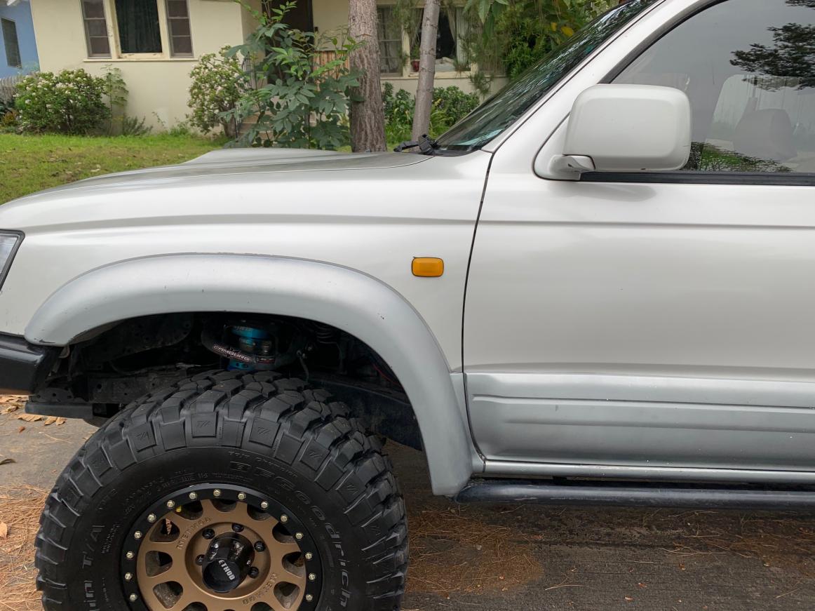

All of my lights on my 97 4runner are Surf and I do have the side markers installed. I can get you pictures tomorrow and measurements. But as for the hole size I have no clue. That would require me to remove my inner fender well and thats a pain sorry.
I have installed side markers on all three of my 4runners, they definitely help with all the distracted drivers out there, it’s a simple install a bit scary drilling a three-quarter inch hole into your fender but Amazon has them cheap[emoji106]
