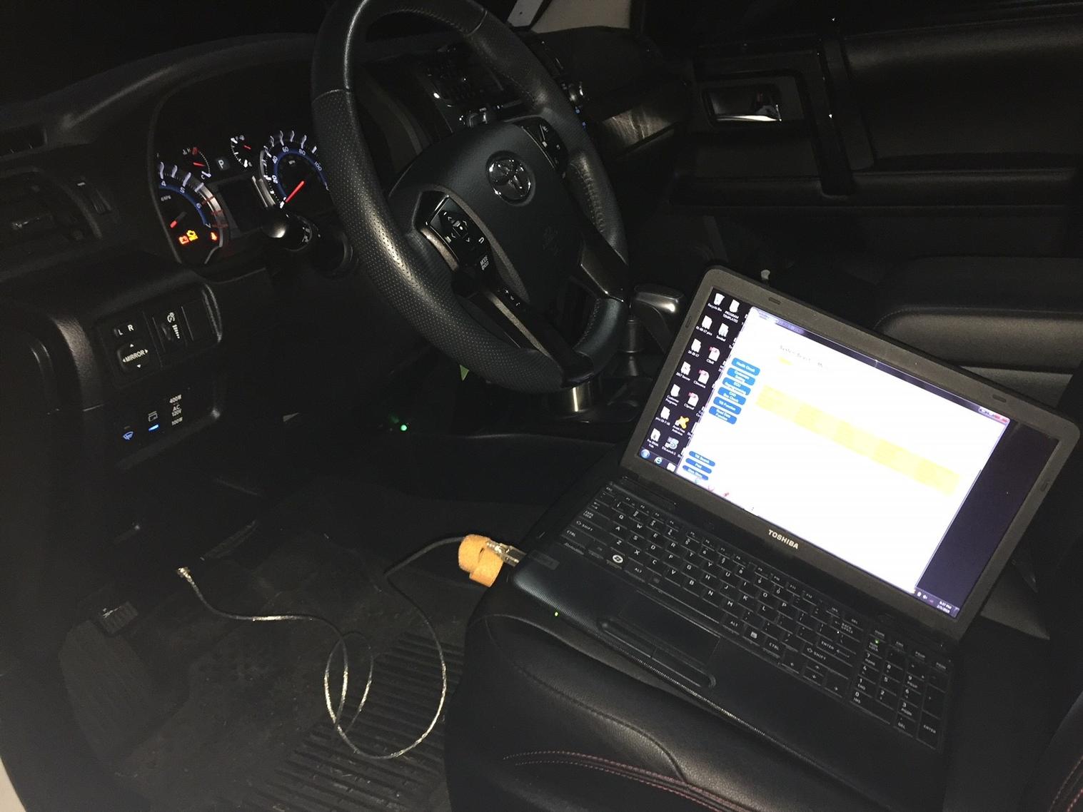

It worked! I got my virgin key fob and Techstream software yesterday. Loaded Techstream version 9.2 onto my XP laptop, plugged it into the truck, and then was able to activate the new FOB.
Its funny the dealer said they'd charge $135 for an hour of labor to program the key....I did it in 3 minutes.
