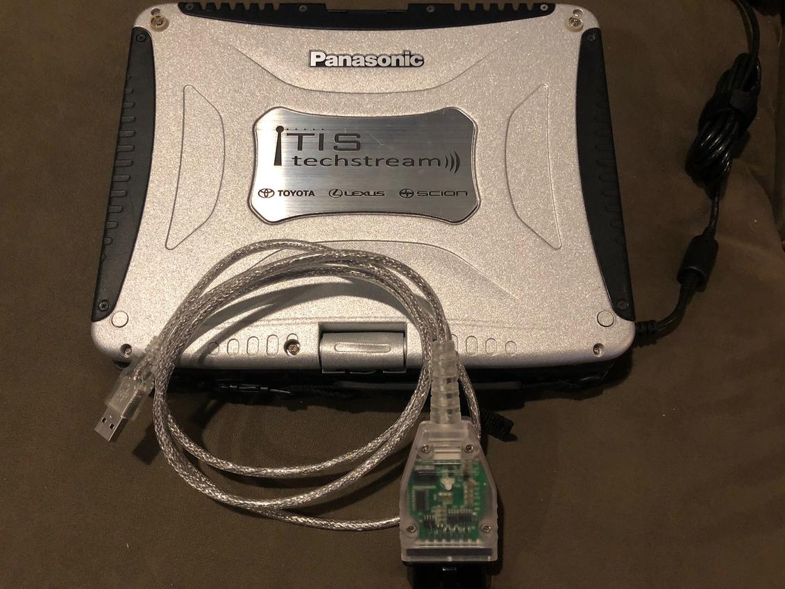

Just purchased a used (Factory) Techstream Panasonic Toughbook. It's version 13 running Windows 7 Pro (32 bit). I get a Fatal Error 0xC0040001 when accessing Engine and ECT Data List....data list works fine in all other systems. Seller is going to send me another Techstream Lite Cable next week. It's a clear cable but does anyone know how to determine if it's a real Techstream Lite cable and if it's a bad cable causing the error ??...there is a red indicator light BTW when it's plugged in... THANKS !!!

That is definitely not a real cable. The real cables are either blue or green. The green cable is the newer version. Mine is blue and is made by Drew Technologies. DO NOT do any programming with that clear cable. It “might “ work but It can get ugly if it messes up the ECM’s.
That’s a CF-19 Toughbook you have. I have been using them for many years. If you ever have any questions in regards to it let me know.

That is definitely not a real cable. The real cables are either blue or green and yes they said there is a clear cable. The green cable is the newer version. Mine is blue and is made by Drew Technologies. DO NOT do any programming with that clear cable. It “might “ work but It can get ugly if it messes up the ECM’s.
Hey !!...thanks for the reply. So the Fatal Error is with the VIM and not the software ??...watched a video by NASTF.org and they said yes either the blue or green Mongoose cable...well, I'll see what the seller sends me...the green Mongoose is $495.00...ouch !!...I just spent $1,100.00 on an Autel 906 for my Corvette and other non-Toyota cars I might be working on...WE also used these Toughbooks in the Airlines for years...we are actually transitioning to Ipads this month. The NASTF Youtube video below...thanks and I'll keep you updated...one other thing...can you install the VIM drivers even after the software is installed ??
another question...how can I tell if my software is "factory installed" or a pirated version...thanks again !!!
That is lite cable and should work just fine. Most people here used cable just like that. You might want to get another one if yours failed.
Incorrect. The original MongoosePro 1.0 cable was a clear cased cable. The new 2.0 and 3.0 have a different case and color.

Since we don't have a pic of the other side of the cable, I can't tell if it's a real cable or a chinese clone.
I stand corrected. I have never seen the clear Drew Technologies clear cable. It's got to be a pretty old one though. I bought mine from DT about 5 years ago and it was blue. If the OP can take a picture of the label we can tell as you stated.

I don't think Toyota supports the TIS Techstream 1.0 units anymore (the CF-19 based system you have), so I am not entirely sure how the software is going to act on that unit if it's still the genuine stuff. Our dealership actually got rid of our only one because it was "obsolete" and we're only using the newer CF-31 based TIS Techstream 2.0 and approved Green Mongoose Cables.
I do recall seeing an early clear cable long long ago, but I believe they have label stickers on them, so I don't know if I entirely trust the one you have pictured.
Post Note-
Your CF-19 is a non-base model. That seems weird to me, all TIS Techstream 1.0 units I have ever seen have all had the proprietary Snap-On base with the extended battery and VIM module in them. I'm guessing your CF-19 was stripped and "Decommissioned" before being sold, I could be wrong on that; but all the units I have ever seen were sold to dealerships as complete packages.
