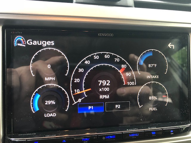

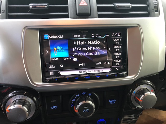

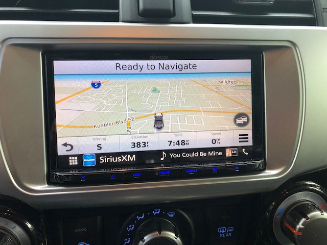

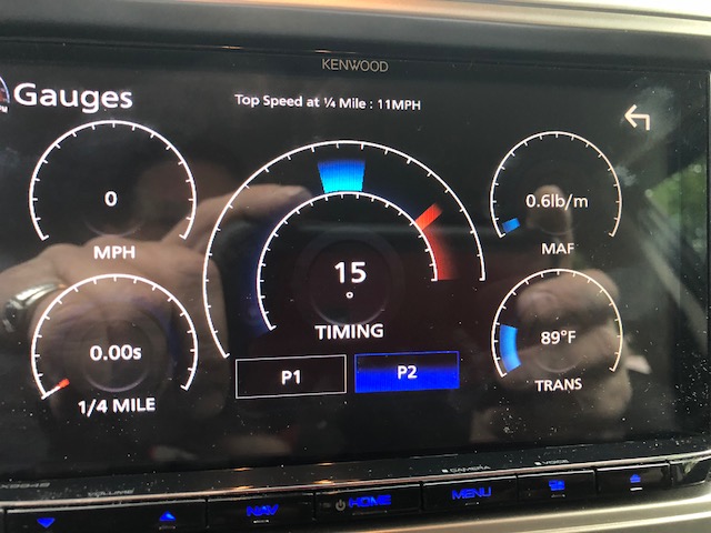

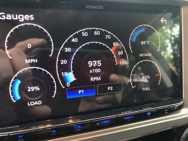

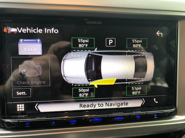

I installed a Kenwood 994s with maestro module wired in, also the Kenwood dashcam that integrates to the headunit. The Headunit shows me tire pressures, tire temps, and I can switch to two full screens with full gauges on them of my choosing from transmission temps to EGT exhaust temps to 0-60 times. Plus gives me the ability to change all the factory settings in the vehicle that a lot of people go to the dealer to have changed. Like windows roll down with remote, the lock beeps, lock when in Drive etc.... Ill get some pics
Here are some pics.
