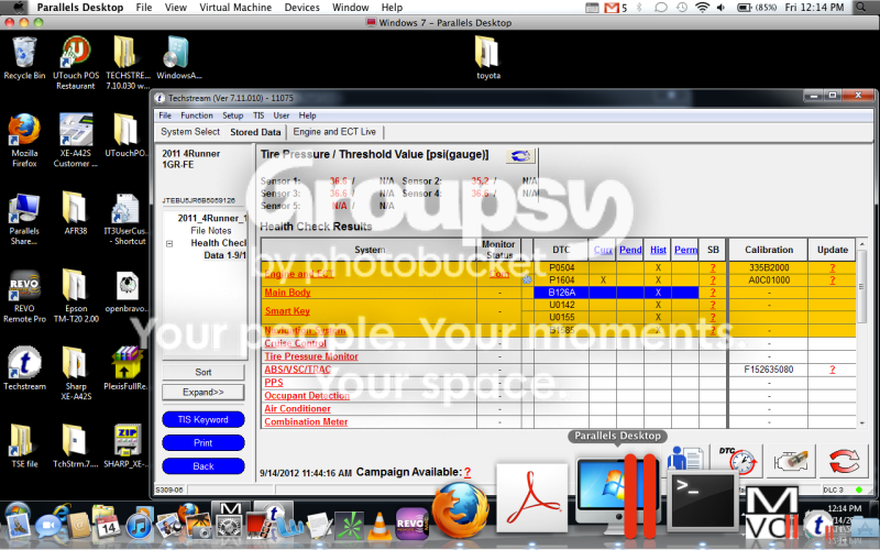

Can you tell what's going on in this screenshot from earlier in the thread?
Finally got the cable last night. its running on my mac with parallels desktop windows 7 32bit. Im out on my lunch break, fiddling around with the software :hungry:
Screenshot2012-09-14at121416PM.png~original
