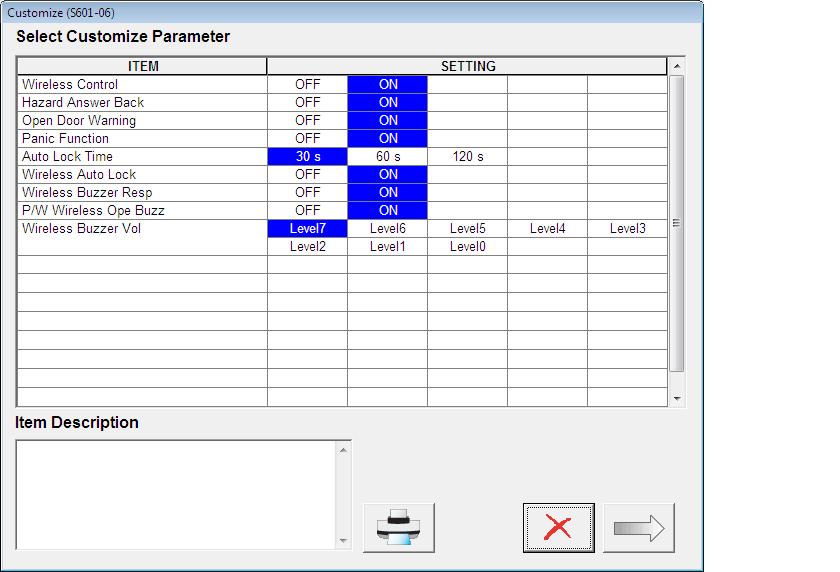

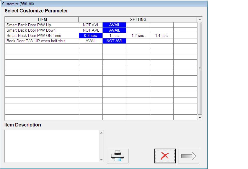

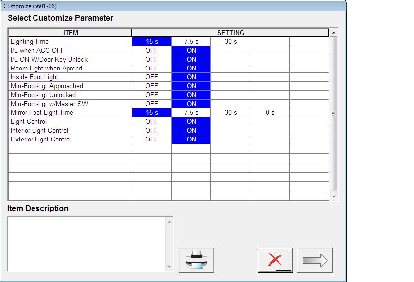

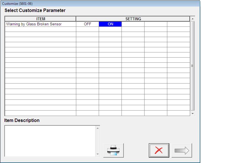

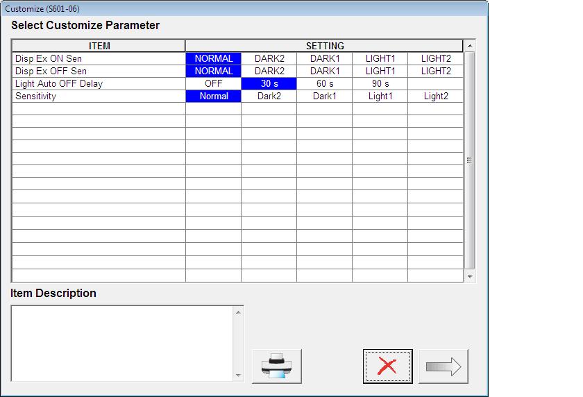

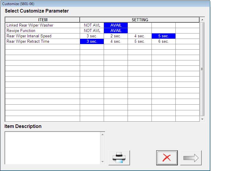

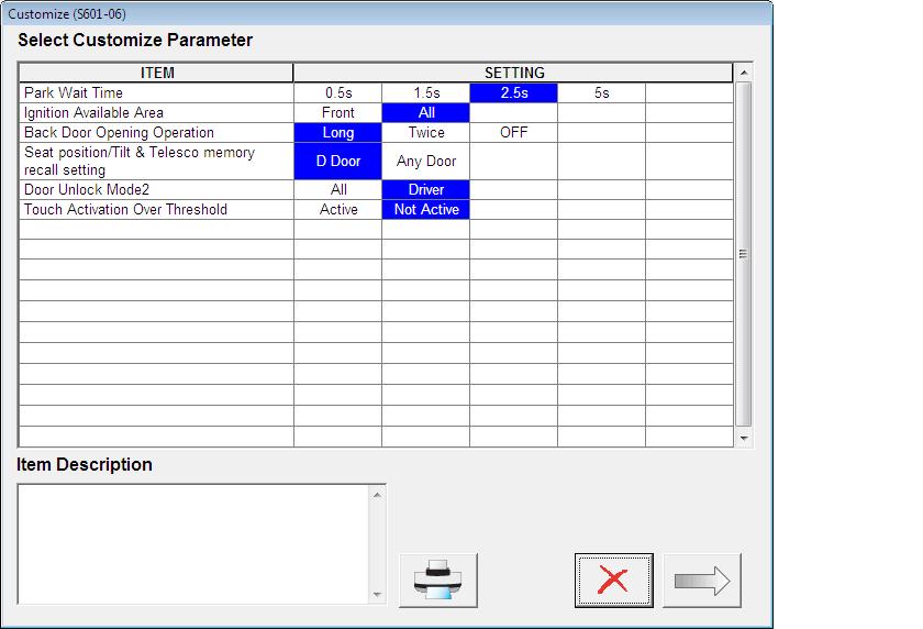

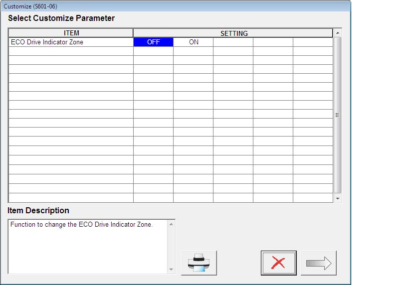

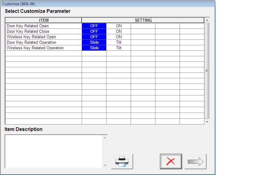

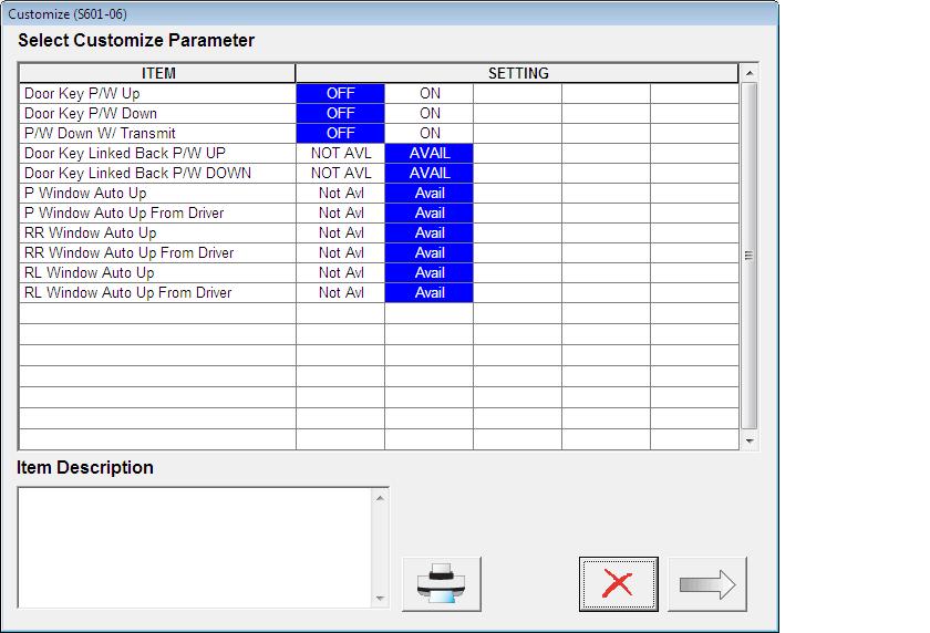

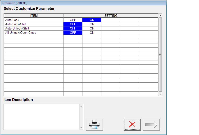

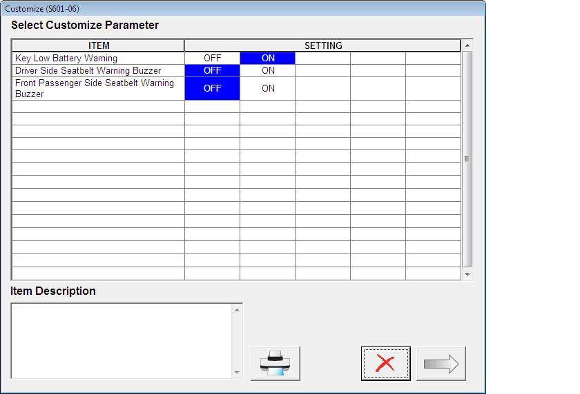

attached are actual screenshots of settings you can customize for the 2014 LE w/ Smart Key. yours may/may not have these settings.
