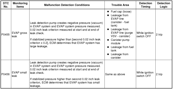

A diagnostic trouble code doesn't tell you what to fix. It lets you know that the ecm has detected a fault, and the code narrows it down to the specific system. A cheap handheld scan tool is suggesting what to fix based on the odds.
Here's a picture of some info for P0445..EVAP large leak detected. Gas cap is first on the list, but there are other things to check as well. Gas cap is just the most simple thing to check, and because it gets removed/replaced often, a likely candidate to fix in order to turn off the cel.

Aaaaaand....since I'm on a roll....if you are curious about the EVAP I/M monitor, here are the requirements for it to run. Where step c(1) mentions "Connect the Techstream to the DLC3, you can get a scan tool that shows all the I/M monitor status. This will show pass/fail/incomplete
3. EVAP SYSTEM MONITOR (KEY OFF TYPE)
(a) Preconditions
The monitor will not run unless:
The fuel tank is less than 90% full.
The altitude is less than 8000 ft (2450 m).
The vehicle is stationary.
The engine coolant temperature is between 4.4 and 35°C (40 and 95°F).
The intake air temperature is between 4.4 and 35°C (40 and 95°F).
Vehicle was driven in an urban area (or on a free-way) for 10 minutes or more.
(b) Monitor Conditions
(1) Turn the ignition switch OFF and wait for 6 hours.
HINT: Do not start the engine until checking Readiness Monitor status. If the engine is started, the step described above must be repeated.
(c) Monitor Status
(1) Connect the Techstream to the DLC3.
(2) Turn the ignition switch ON.
(3) Turn the tester or scan tool ON.
(4) Check the Readiness Monitor status displayed on the tester or scan tool.
If the status does not switch to Complete, restart the engine, make sure that the preconditions have been met, and then perform the Monitor Conditions again.
