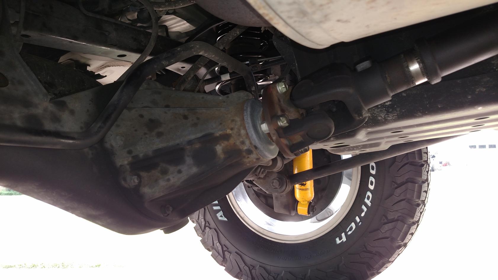

Well, if the vibration goes away when there's no load then you should be looking at your universal joints, double cardan (large double universal between the driveshaft and the transfer case, or the pinion bearing, ( caused by excessive pinion angle - look at how your rear differential points more parallel to the ground but the driveshaft "connects" at an extreme angle) Post up some side pics of your lift so we can see what kind of lift you have working. Also, what brand of LBJ did you use? It's's fairly well proven that only OEM LBJs hold up on our truck, and since it's such a crucial part (and not real that much more money than the better quality NAPA LBJs) it's really a no brainer purchase. .

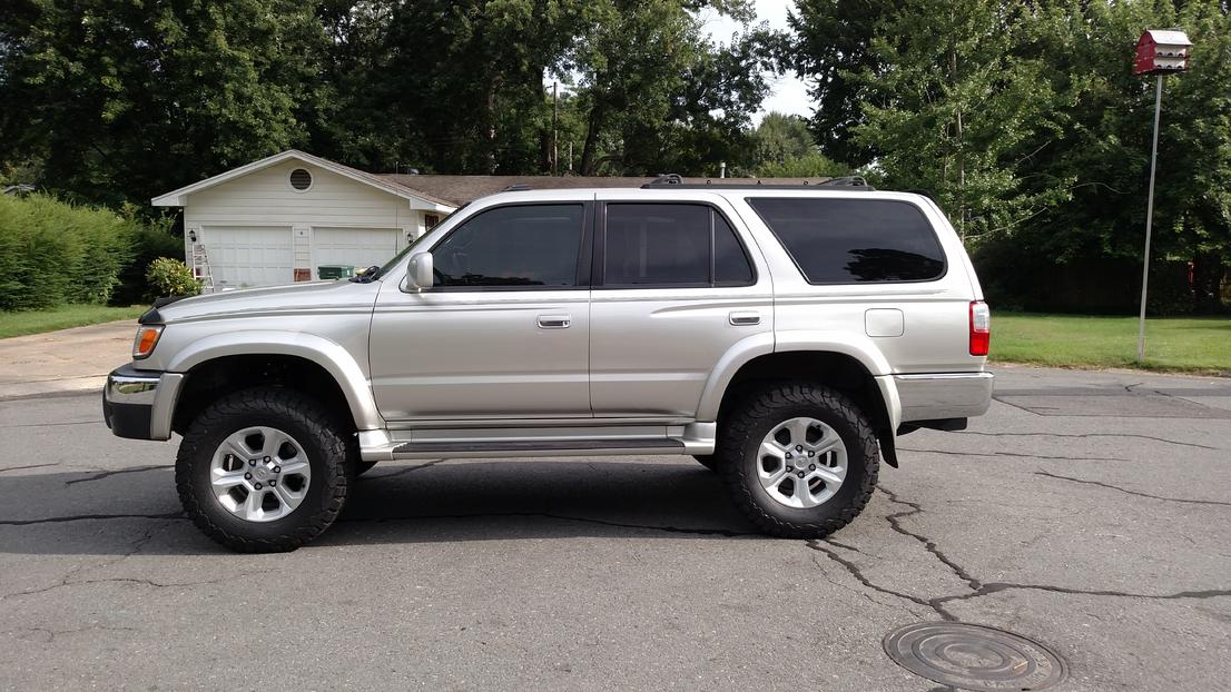

I do notice the driveshaft/rear diff angle now that you mention it. Is that normal or due to the lift? Also took a side pic and measurements.

From the pics, your cv angle did look kinda steep so you may want to try that since it would be an easy first place to start b/c of the adjustable coilers.

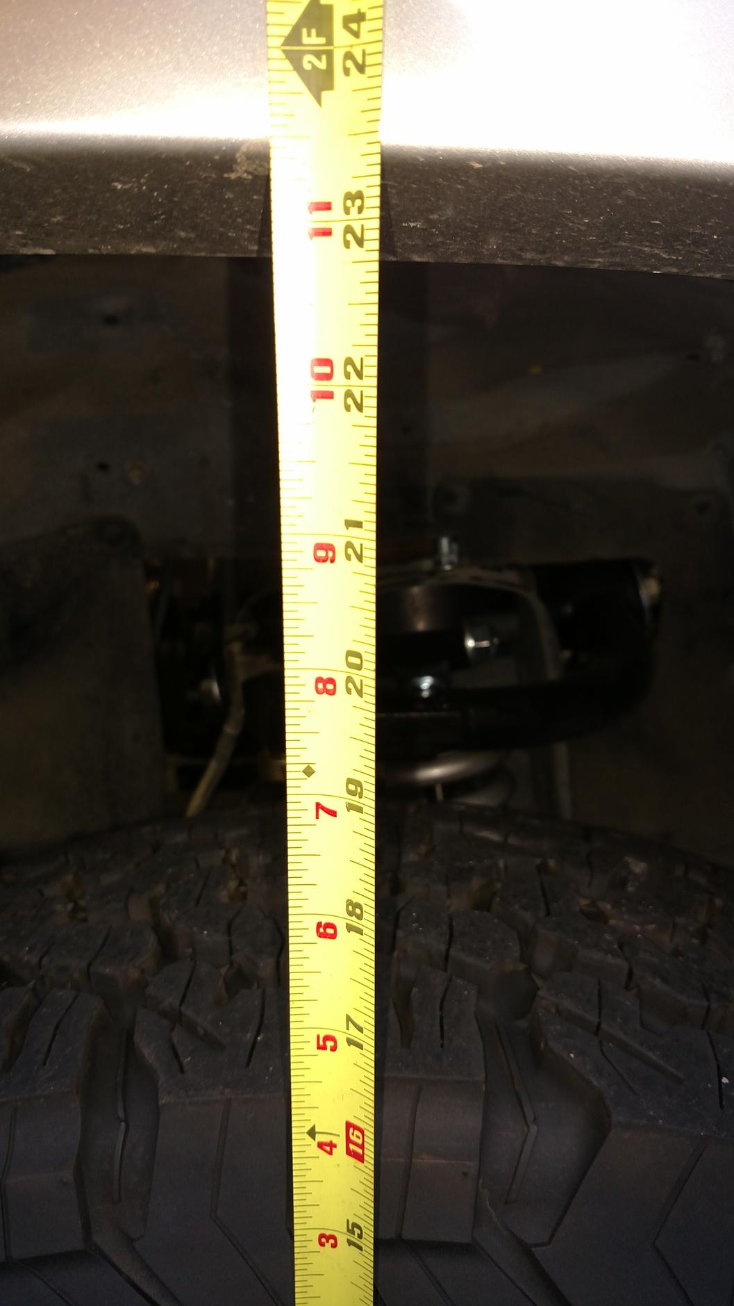

[MENTION=116877]fourfive[/MENTION] have you measured from your center hub to fender up front? You essentially have the same set-up as me. I'm curious to see what you measure as compared to my 23 1/2. If it is comparable i'm not sure what else would be making the cv angles greater on mine. I have the front diff drop installed.
Pinion angle looks fine. It is very strange that it only does it under load. That is definitely a clue.
Wrote out a timeline of ride quality with the various suspension changes & listed some things I will be looking into to see if it resolves the vibration I get in AWD at highway speeds. In my case, this isn't a huge issue for me right now since I don't get any vibration in 2WD & the only time I will use AWD is if it is raining BUT, this would be a different story if it occurred in 2WD as well. Regardless, this is something I would still like to resolve. I bolded the info you were asking for so you didn't have to sort through the rest of my garbage. Also, don't remember if you said you had a diff drop but if not, that may be why your cv angles look steeper than mine...I don't have a pic of my angles but they don't look as steep and the ribs on my outer boots are not touching. I did notice this morning that the ribs on the inner boots are slightly touching. Not sure how much the 1" diff drop actually helps but I have one on mine.
After installation, alignment by "specialty shop", & some "fine tuning" on my coilovers, my mid hub to fender measurements were: (this was Jan 2015 w/ 890s in rear)
front driver: 22.75 - 23" (1.5" of threads showing)
front pass: 22.75-23" (.8" threads showing)
rear driver: 23-23.25"
rear pass: 23.25-23.5"

After turning my front coilovers up & multiple alignments from firestone b/c they suck, my mid hub to fender measurements were: (w/ superflex)
front driver: 23-23.25" (1.7" threads showing)
front pass: 23-23.25" (1.0" threads showing)
rear driver: 23.25-23.5"
rear pass: 23.5-23.75"
